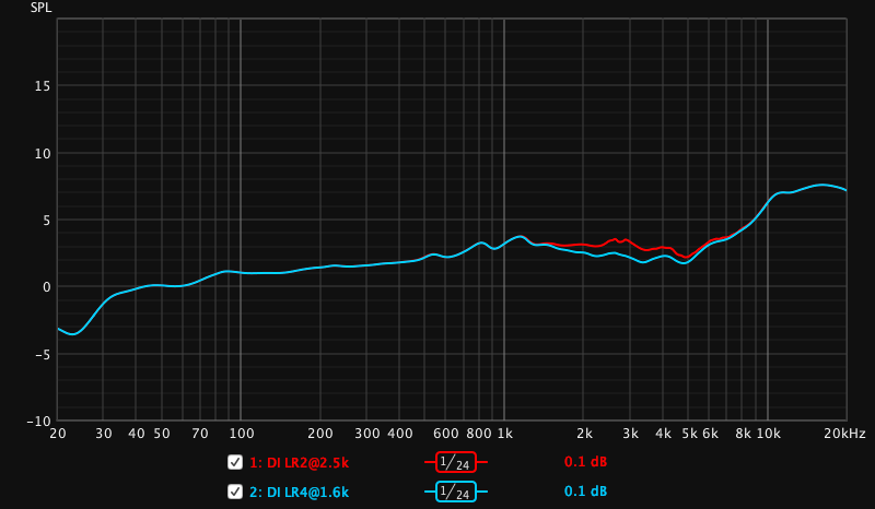

The number one thing to optimize is frequency response, which is easy with the active XOs you have:
  • On axis response flat through XO
  • T-M responses symmetrical ~1oct past XO (don't just pay attention to summing flat)
  • Phase of T-M line up and sum appropriately for IIR chosen (or flat for FIR)
  • BSC dialed in appropriately
  • Off axis response falls away smoothly with lack of discontinuities, which results in smooth power response.
  • This also results in smooth DI without significant irregularities. This one is harder to achieve without waveguides or careful design.
I would graph the off axis response for current speakers 0-90deg (hor) and generate the power response and DI. Based on what you find, decide how to optimize them with your new project. Once you select the strategy, you can go shopping for appropriate drivers.
