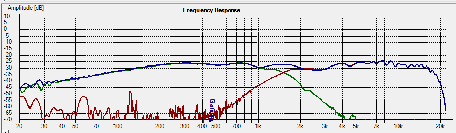

Not having any success with a mtm build.
1. The woofers (6.5" flutes - 8ohm) do not go very high and what is up there is pitchy. Although, this time I realized the flutes do have robust bass if they are rolled off quickly.
2. Next tried to move the SB response lower, that was an issue and no matter what I tired they were no near the manufacturer's test results.
I assumed the mtm configuration is off the table, i,e, not enough face/baffle around the tweeter and decided with not much to lose here removed the mtm baffles and will try a tmm layout with the same drivers.
Started to think about a layout on new baffles, and almost started the cutouts but stopped and questioned: is an arbitrary layout going to have the same results.
A more direct question should I maximize the area around the tweeter?

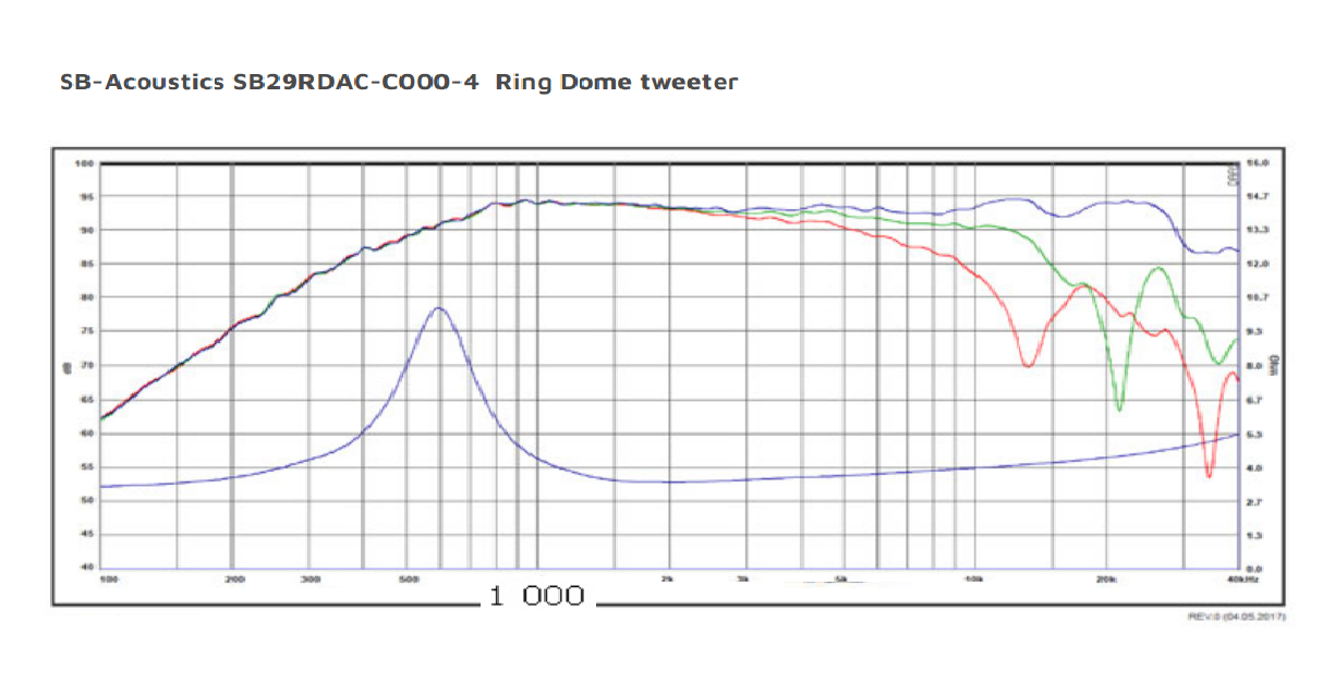

Response on data sheets is measured on IEC baffles, no news there I hope. Judging from the pic your baffle size should be just OK to use the SB in it's working range. What is your target fc? I would certainly not use it below 2k and in this setup 2.5k would be my safe bet.
If you stick with the current woofers,
A 30 mm tweeter may be a relatively sensible way of going lower.
I think the Sb acoustics are good to 2.5KHz or thereabouts, getting a nice transition at 2KHz against two woofers which I guess are approaching 90dBs sensitivity as a pair will be problematical.
Tweeters to look at are possibly wavecor TW030WA12 or Audax TW034X0, maybe there is a large tweeter in the Dayton line-up that fits the bill.
Maybe Dave over at Planet10 can suggest something sensible.

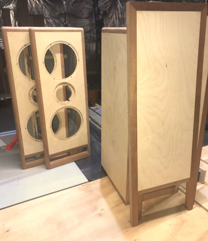

Apologizes for the delay, was replacing the baffles as mentioned, the new layout is TMM 2-6.5" SFs and a wavecor W11. Very happy with the new appearance and hopeful that the crossover can be sorted out.
On the previous mtm attempt, I also tried to tame the dual 6.5"s with a heavy .5mh inductor -- in addition to the active xo. The bass was great and an inspiration to keep trying, but there there were other problems, cancellation issues I guess.
2. I was incorrect, and now know that the SB29 is only good down to 2,000hz.
3. Already changed them up to a TMM and liking the look of the over-sized Wavecor tweeter.

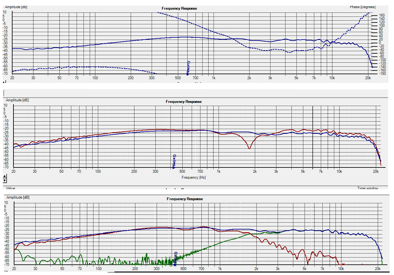

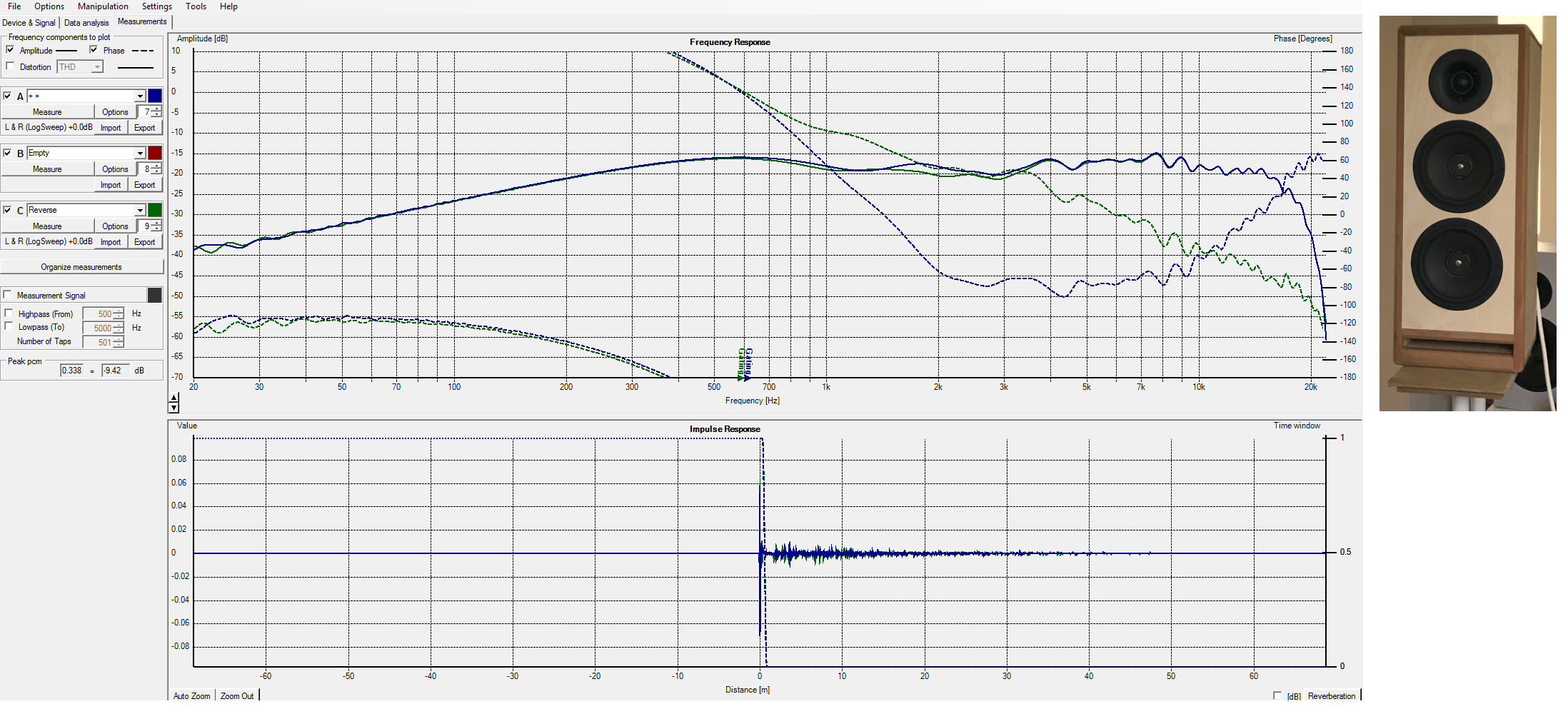

Finished one, so far so good,,,huge improvement in bass and overall sound quality.
Now using a 12db xo no caps, etc., set at 1,500hz.
This may not mean anything but did not touch the gating for these, although it seems the lower the better. I really don't know tho.
The green line is reverse phase and sounds slightly better, but delay is needed.
If so, I'll open-up an extra 2x4 minidsp and dive into that.

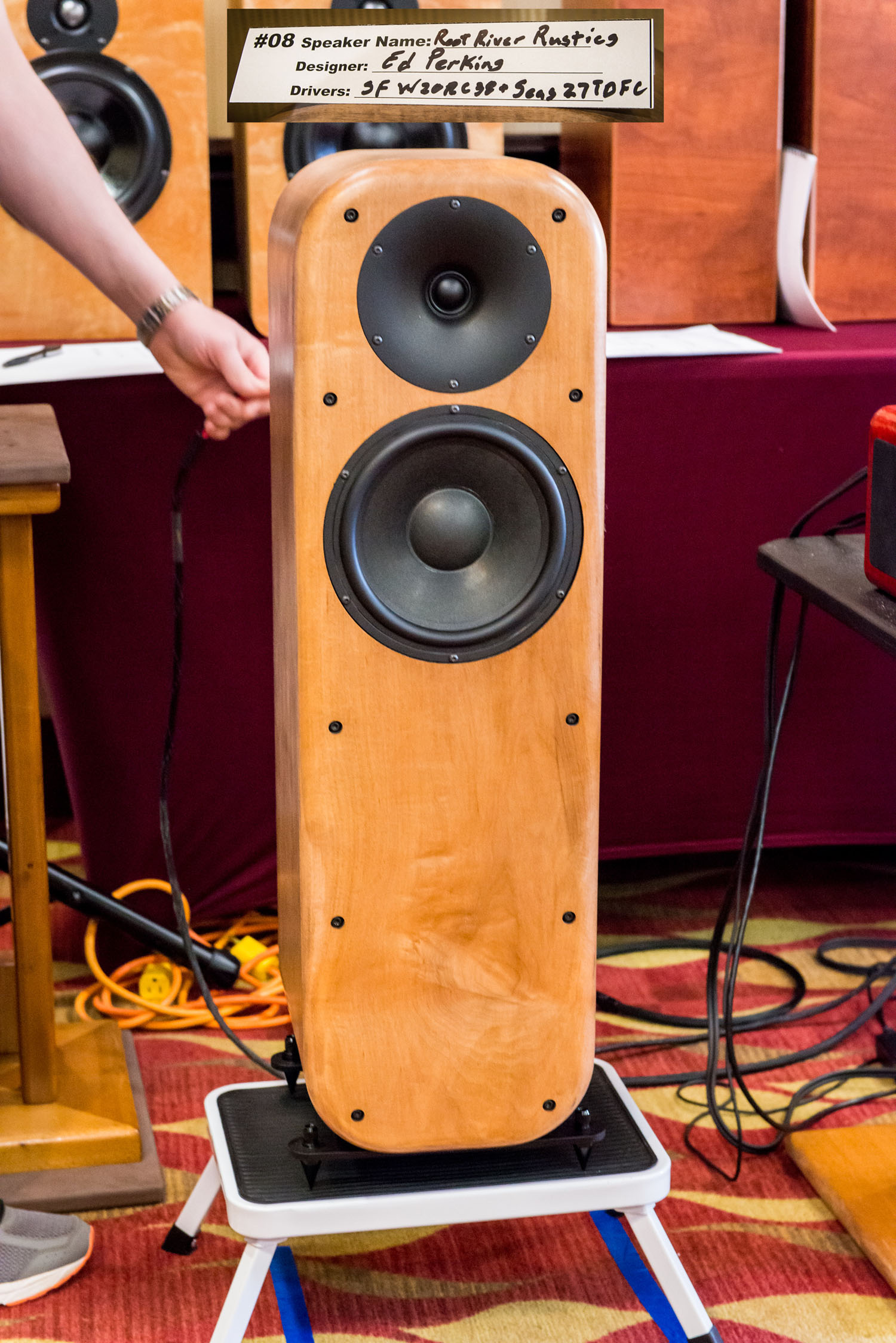

I did see that thread about the W20RC38. In fact, I simmed the Madisound crossover you posted with my W20 measurements: It worked well and fit a LR4 @ 2500 Hz target very well. It does have 3 dB BSC which I'm not sure is enough for the W20. A lot of that depends on personal preference and speaker location.
No, I didn't post any of my builds. The W17 was done several years ago and gifted. The W20 build was part of a speaker contest. The rules limited the maximum cabinet volume and cost (= speaker drivers + purchased waveguides + crossover components). But the main challenge was in the crossover: we could use a maximum of 5 components per speaker! Ben (wolf_teeth here) hosts the contest yearly with a different theme every year.
It's great fun. Here's a pic of my build. Drivers are the W20RC38-8 and the Seas 27TDFC mounted in a Visaton WG-148 waveguide.

Ok having some good luck with the budget build, now I remember why I like the flutes, they do have some unique sounds/tones/bass. The first thing I did was target the 600hz hump 3db, that alone is a HUGE improvement!
There was something going on that I couldn't resolve, well above the 1.5K xo point, up around 3k a short/high/hump, I tried many xo combinations [minidsp] and could not see this when either woofer/tweeter was disconnected, so it must be a interaction?
Any thoughts on this? The room, maybe the Adcom 7300 [5 channel] amplifier? Please don't tell me it's that darn baffle!!
Thanks!
A minidsp seems like a lot to take on without some kind of training but experimented with all the xo settings, BW, LR, Bessel -- but ended up same place where I left off yesterday. Although added in equalization in the channels. REALLY like the wavecor now with the 2db add around 3,000hz.
