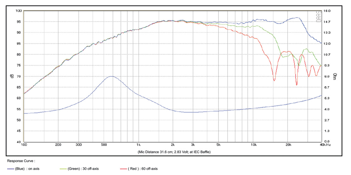

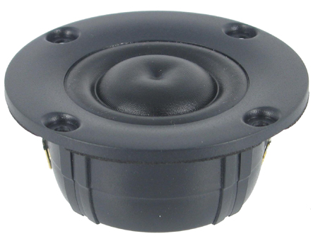

I have been using the SB29RDCN 4 ohms NeFeB tweeter because of a combination of great sound, modest size, and 94db @2.83V. New 6.5" midbass speakers like the Lambda TD6H can match this efficiency with wide bandwidth for a TM. The extra dynamics of 94db vs. 89db is very important to me. The small size is very important to me for optimizing MTM spacing.
I think a "very good" high efficiency tweeter can create superior dynamic sound in a completed speaker compared to to a "very, very good" low efficiency tweeter.
