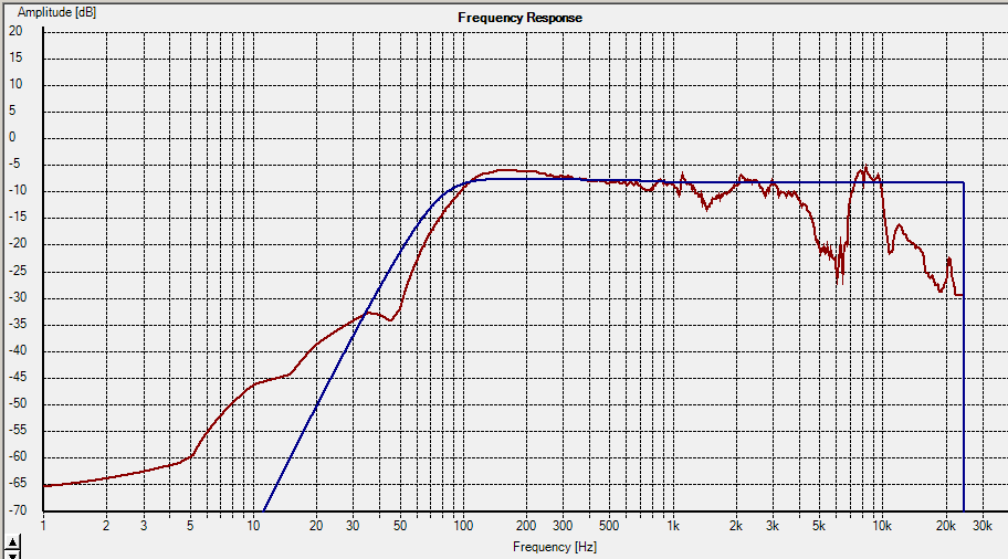

Hmm that is a bit perplexing, one thing that I noticed is that the measurements show a peak at ≈40Hz as well as a peak at ≈125Hz and somewhat, a dip at ≈70Hz, this mirrors the port tuning, are you sure there isn't some error in the wiring somewhere? It's as if you might be performing a 2 channel freq resp measurement but with a jig set up for impedance or something.
Aus is 50Hz. 5th you may be 100% correct!! I left the speaker connected to the Walin jig and didn't plug it direct to the amp! The jig was no doubt still in impedance setup! I think I ran the mic direct to the sound card input, but certainly if there was an 8 ohm resistor in series with the driver it would explain the fact that the sim with 10 ohms series resistance seems to match what I see!
DOH!! But thank you!!! 😀
I will try again this evening after work 🙂
edit: It would also explain why my levels were so low!! I was cranking up the output much higher than normal and scratching my head as to why the levels were low. double doh. (hard to tell with the hearing protection on). Just looking for the jig schematic to find out if indeed it puts the 8 ohms in series with the driver in impedance testing mode...

It was an ID10T error 😉
5th element wins the prize. It was my impedance jig stuffing things up :embarrased:
Tonights measurement is better. Still not perhaps quite what I thought it should be but better.
Definitely need to look at some sort of lining for the rear wall too, as I suspect that the big mess around 1Khz could be rear wall reflection, maybe not port resonance after all.

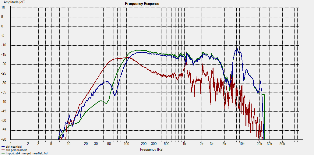

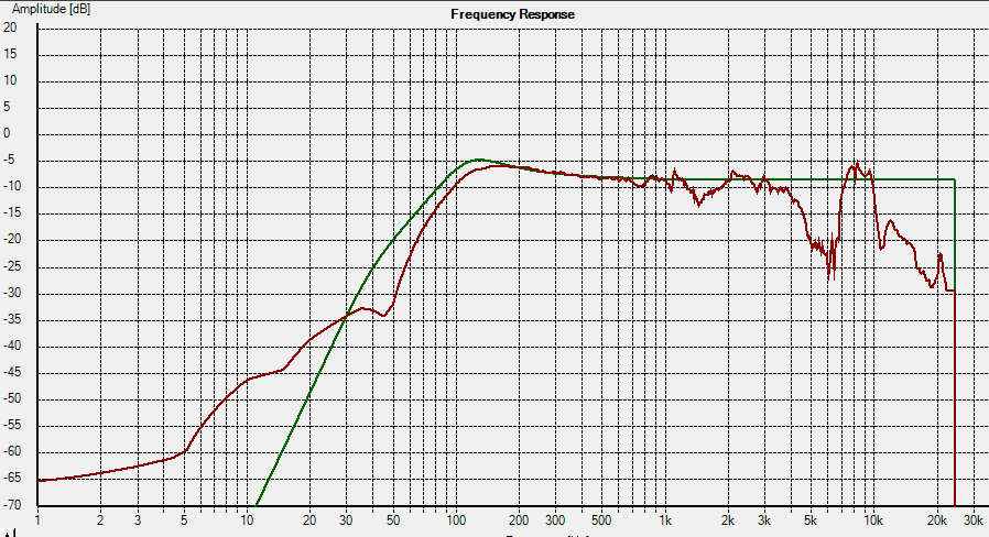

Blue is the woofer nearfield, red the port (still not sure how to get a long narrow port accurately) and orange is the two merged using speaker workshop.
edit: added sim vs nearfield. Might be time for me to try a groundplane measurement, haven't ever tried before... and third last nights vs tonights nearfield of the woofer (no port merging).

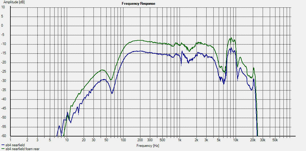

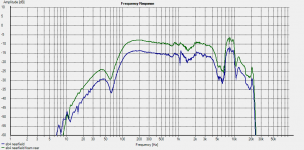

ok and with some 1" thick very low density open cell foam on the back panel. definitely smooths out that glitch at 1Khz. Not sure If I will try the good stuff 😉

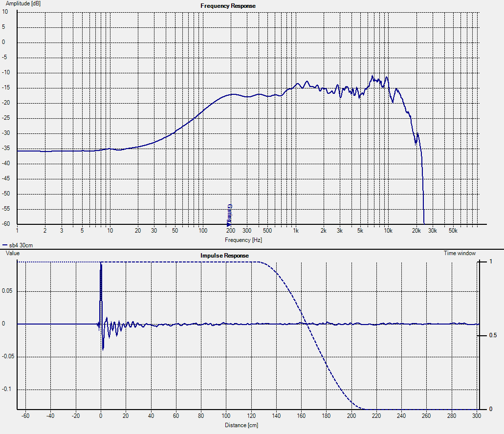

edit: also attached 30cm measurement gated (but still dodgy).

That 1kHz glitch is port resonance. Note that it appears prominently in the port trace and only slightly in the driver trace. That kind of trace is typical of higher harmonics in MLTL's, but shouldn't appear in a BR.
Where are you gating your impulse? I think I see a bit of floor bounce in that trace. But hey, how much better do you want a gated trace to look? You a basically looking at the raw driver response and they aren't going to get much better. Do this: Smooth the gated trace to 1/3 octave. That's what your ears will hear. Now how do you like it?

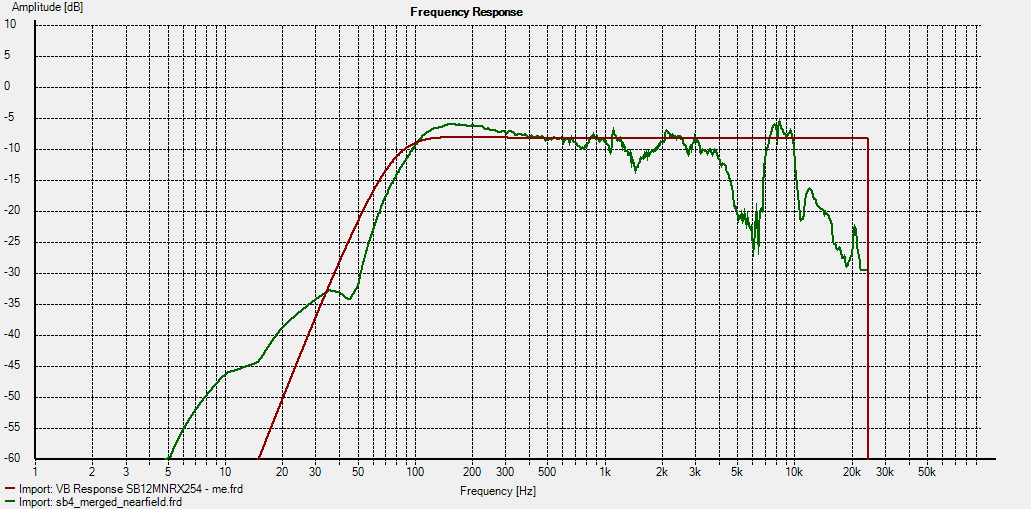

Is the deviation that I'm seeing in the measured nearfield response compared to my sim (using a round port) due to the high aspect ratio port?
The tuning is almost spot on compared to the sim at close to 70 hz but the spl curve is not.
my 70L 30 hz tuned boxes match the sim almost exactly, so I generally trust unibox to give me accurate results, however I'm now realising that I probably should have adjusted something for the different style port. The aspect ratio is close to 20:1 I read somewhere else that 8:1 or lower will model the same, however it didn't mention what changed when you went above that...

The slot vent adds an R to the vent, you should see the FR roll off sooner and slower. When i do sims, once i get the curve i like the shape of, i overlay the sealed reponse and interpolate the real world result.

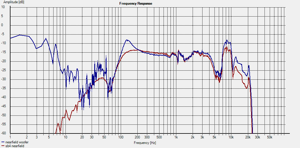

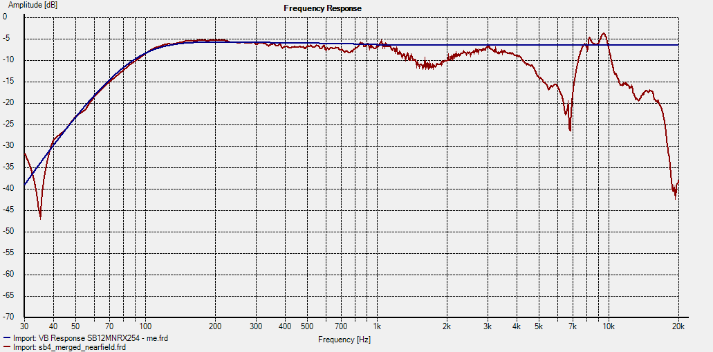

OK thanks Dave, That's different to what I'm seeing so there might be something wrong with my nearfield measurements still or there may be something else going on! Anyway regardless it sounds pretty good so I probably should stop obsessing 🙂
Blue is the unibox sim, red is the nearfield response with merged port response. The difference isn't huge but it is enough to bug me.
Upping the series resistance in the sim (second pic) to 2 ohms gets it a bit closer to the actual measured result, so maybe it is my dodgy alligator clips...
Anyway I won't get a chance to do anything more till the weekend most likely. I will report back if I work out what is going on!

Isn't that bump expected from the measurment technique?
You see this all the time:
dave
The rise in the upper bass is mainly an artifact of the nearfield measurement technique used below 300Hz
dave

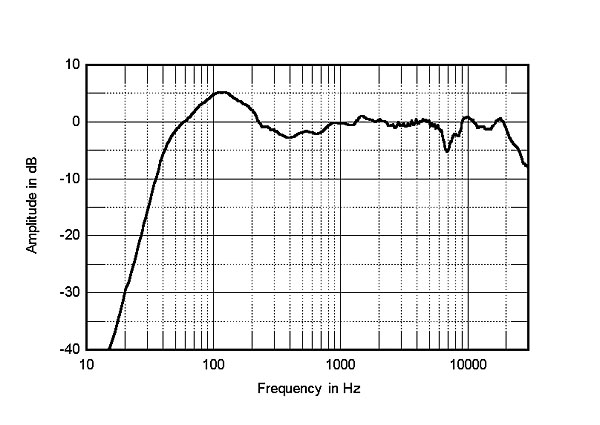

Statement from stereophile. It's simply a diplomatic way not to have to really discuss baffle step losses, the chosen amount of compensation used and any wonky cabinet alignments.
In absolute terms, the true stereophile bump occurs because you're measuring nearfield, on a loudspeaker, that has baffle step compensation applied. As you're nearfield the loss doesn't occur and you see a hump as a result.

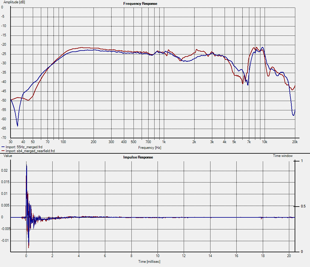

I had a bit more of a play today. I haven't tried sealing up the port yet. but I did try blocking roughly half of it off (in the middle) to get two separate ports. This dropped the box tuning to around 55hz (both in the sim and in actual measurements).
The FR flattened out a bit, though the difference is not that great. Interestingly it has a minimal effect on the transient response as well. It does however affect the curve up higher, though obviously with a NF measurement the higher frequencies can't really be trusted.
Apart from the fact that my port area halved (and there would be potentially more problems with port noise) This doesn't seem like a bad option.
I'm still rather stumped at how different the results are to the modeled response, but one thing is nice, the design is not too sensitive to box tuning!! I'm wondering if I really pushed the limits a bit far with how small a box I could build, and the sim gets inaccurate when pushing the boundaries this far.
Blue trace is with the lower 55Hz tuning, red is the original 70Hz. I Iike the rolloff of the lower tuned box better.
