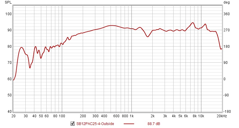

I'm using this driver (SB12MNRX2-25-4), there is a bump in the FR that might be caused by diffraction of the surround. It shows in my on baffle measurement and raw FRDs. Beyond that I like the sound and can't hear the wiggle between 1k and 2k. Attached is my measurement, I can't find the raw driver measurement, but the wiggle was there, you can also see it on the spec sheet.

Thank you for the measurements, mtidge. I agree that the dip in the FR might be due to some cone/surround energy storage problem, but Satori and Audio Technology drivers have similar dips, and I haven't heard anyone complain about their midrange performance. I guess the designers at SB Acoustics could have damped the dip away if they wanted, maybe they found out that low Rms sounds better than flat FR, which is ok by me.
