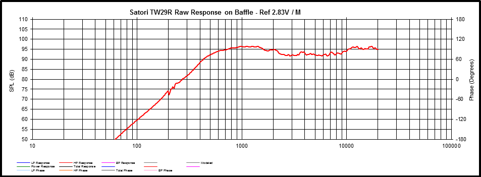

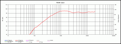

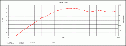

Rated SPL is an approximation, either done as an average over a specific band, or taken at a fixed point, so expect some deviation with frequency. As I said, I don't have comparative measures because I didn't compare them in the same enclosure. However, for reference, two that I took with Omnimic v.2, 1/6octave smoothing & entered into Jeff Bagby's PCD7 for clarity & quickly showing at different scales. This is on-baffle. I've also added Jeff's measures of the driver on his Kairos 2-way baffle. As you can see, very similar, and also match quite well with the published response data, notwithstanding the additional gain through baffle diffraction etc.

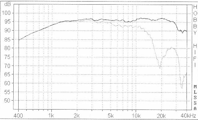

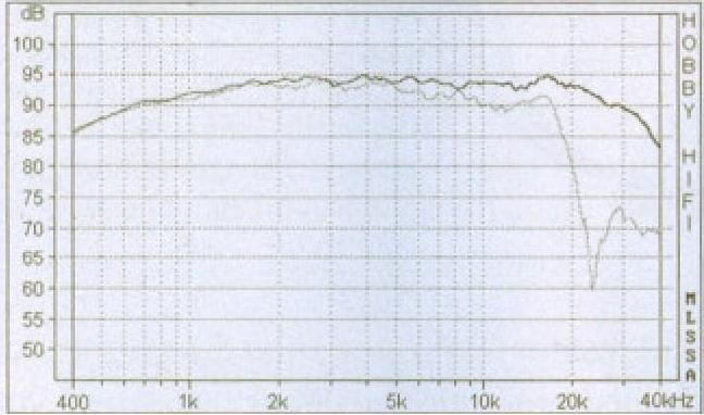

these are response curves 0° + 30°
satori seems be better 0° response but very poor off axis (2nd image)
D6600 otherwise has better off axis response but less extended bandwidth (1st image)
does is it important for the choice ?
