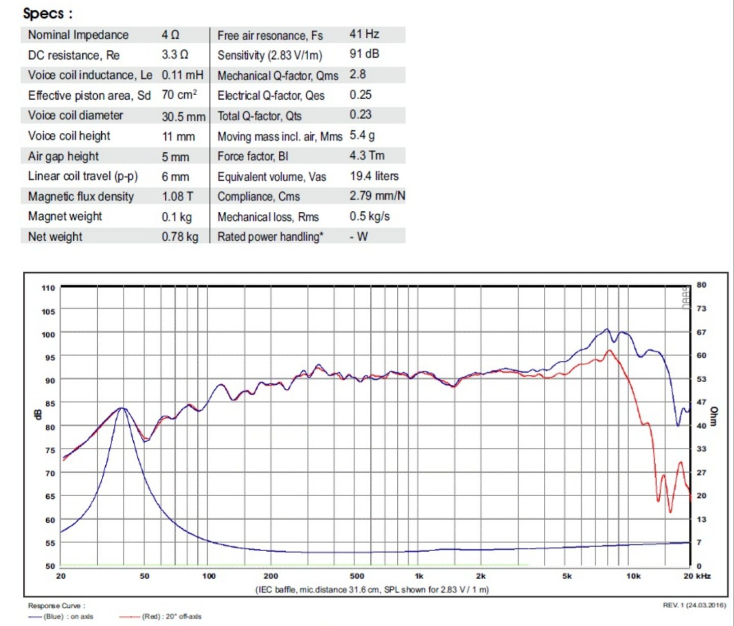

To be fair and thorough, giving it a chance, this Textreme driver does sound very good when crossed lower than 2.5 - 3 k at a 3rd order slope.
Baffle simulations and prototype testing has demonstrated to me that a 5" cone driver should be crossed to a non-waveguide dome tweeter no higher than 3k anyway. Above 3k and it is extremely difficult to get a good directivity performance. Generally the best directivity index curve happens with a 2k - 2.5k crossover, whether the baffle is very narrow or very wide.

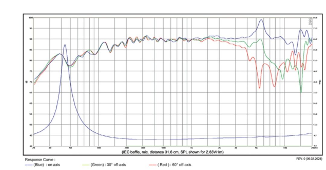

I understand the reservations about the resonance at 5kHz, but my experience is if you are going to cross 2-3kHz much of that issue, which appears on axis only, may be gone. I think the real answer of how important that is may be complex.
@eriksquires The peak doesn't disappear until further off axis, then turns into a severe dip further off axis. Couple that with a more shallow LP slope, it creates a big swing in phase summing with the HF.
Sure, you can use a sharp slope in DSP to get around that, but not everyone wants to use DSP and for the price of this driver, it competes with other easier to implement drivers.
I still believe it sounds nice crossed passively under 2.5k, but other drivers sound better higher up for the same money. Perhaps if someone tried some edge dampening scheme at the surround junction like other paper cone drivers use, it would mitigate the issue to the point it could be crossed higher.
