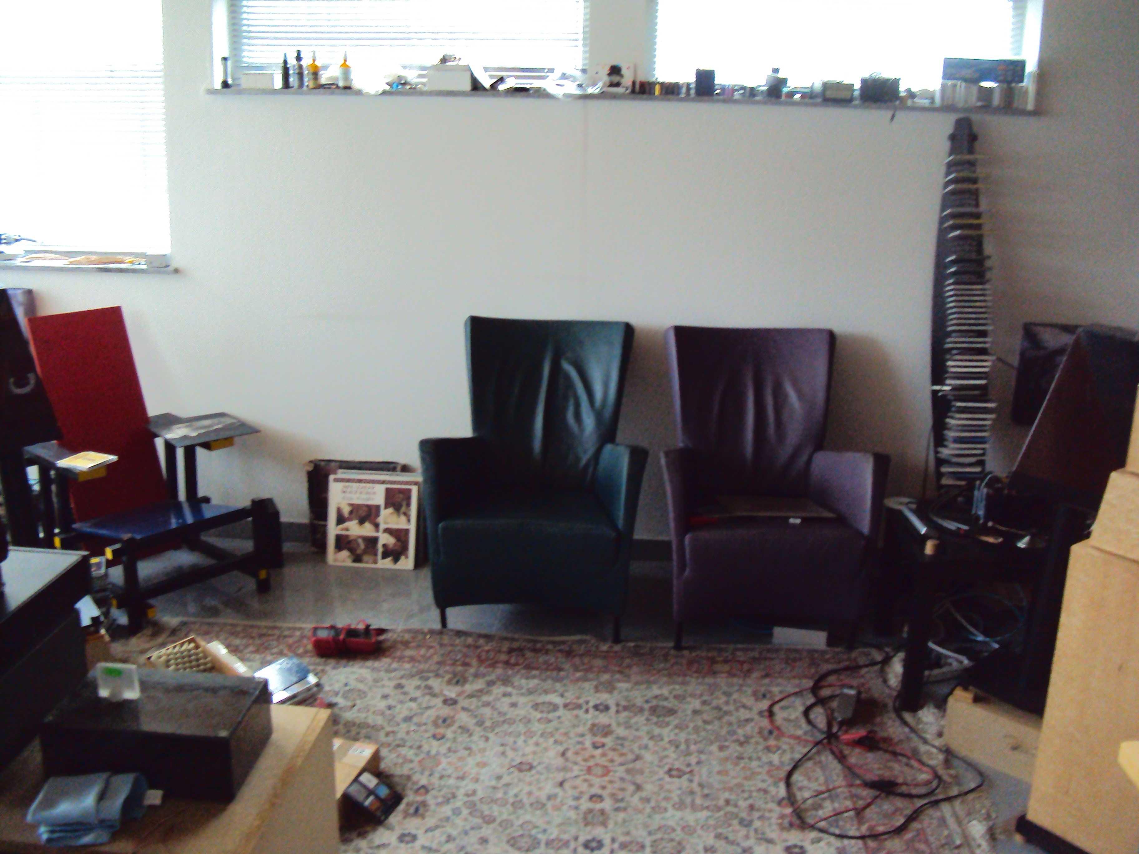

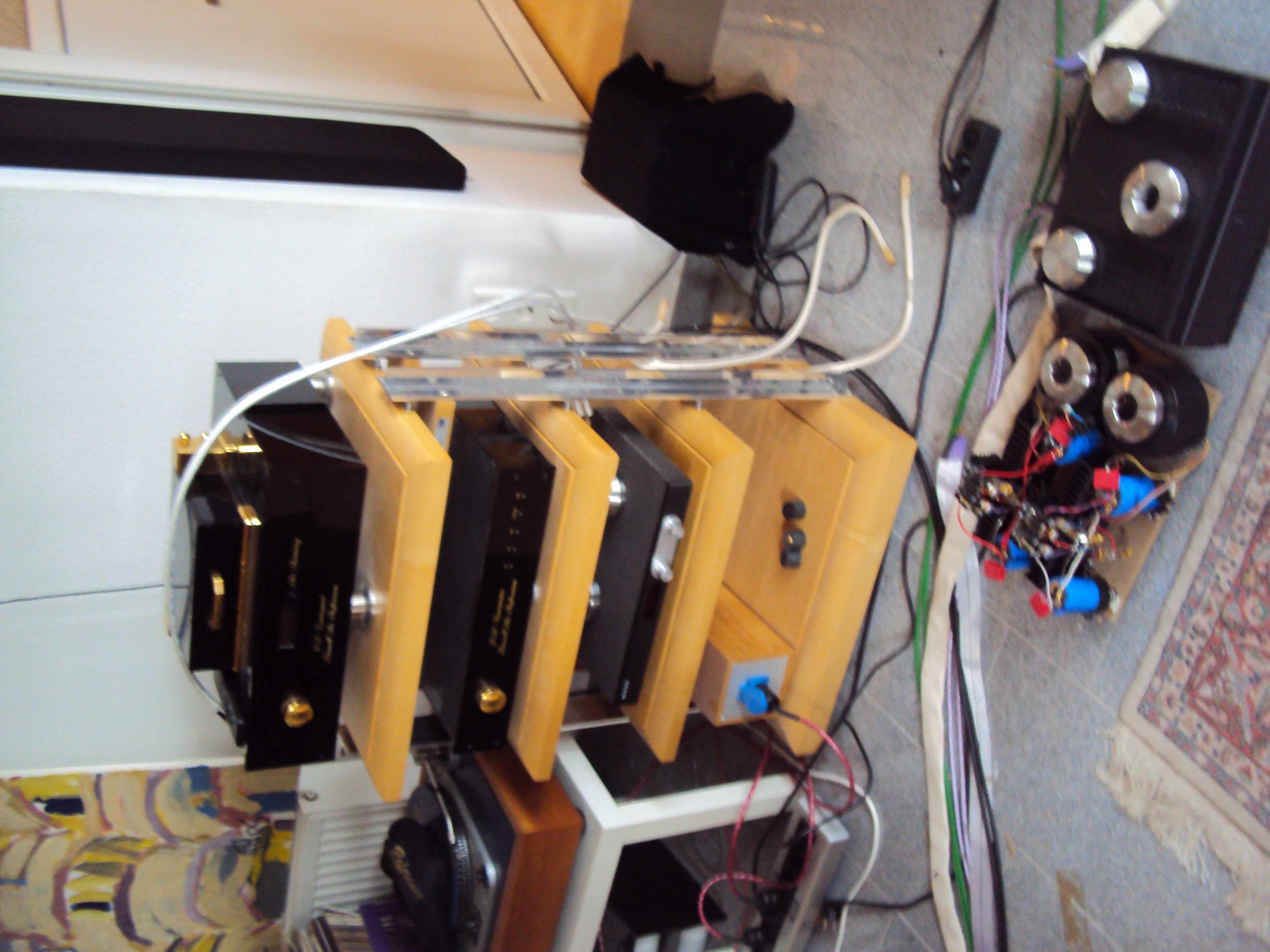

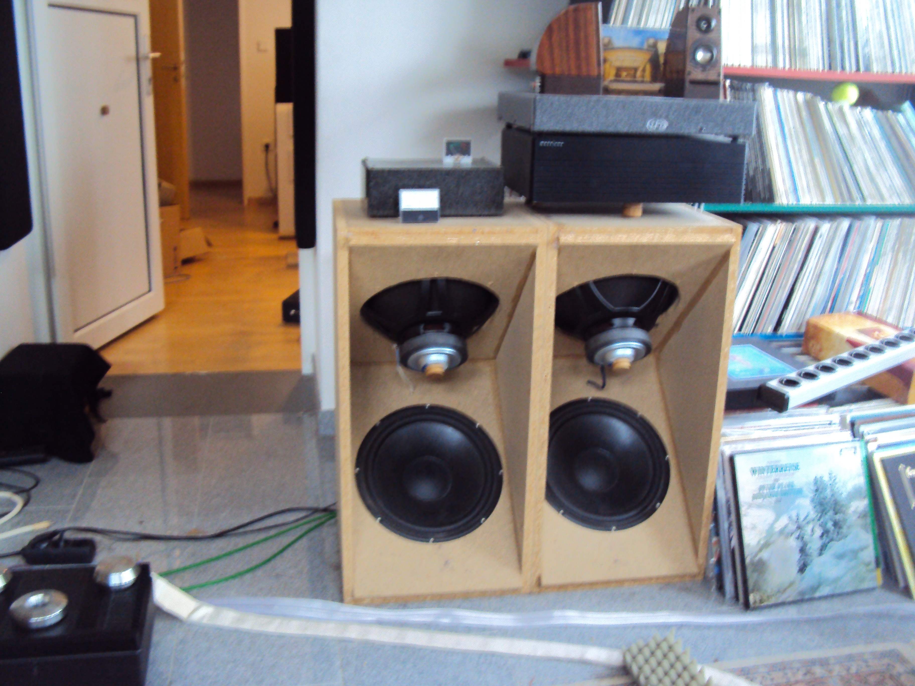

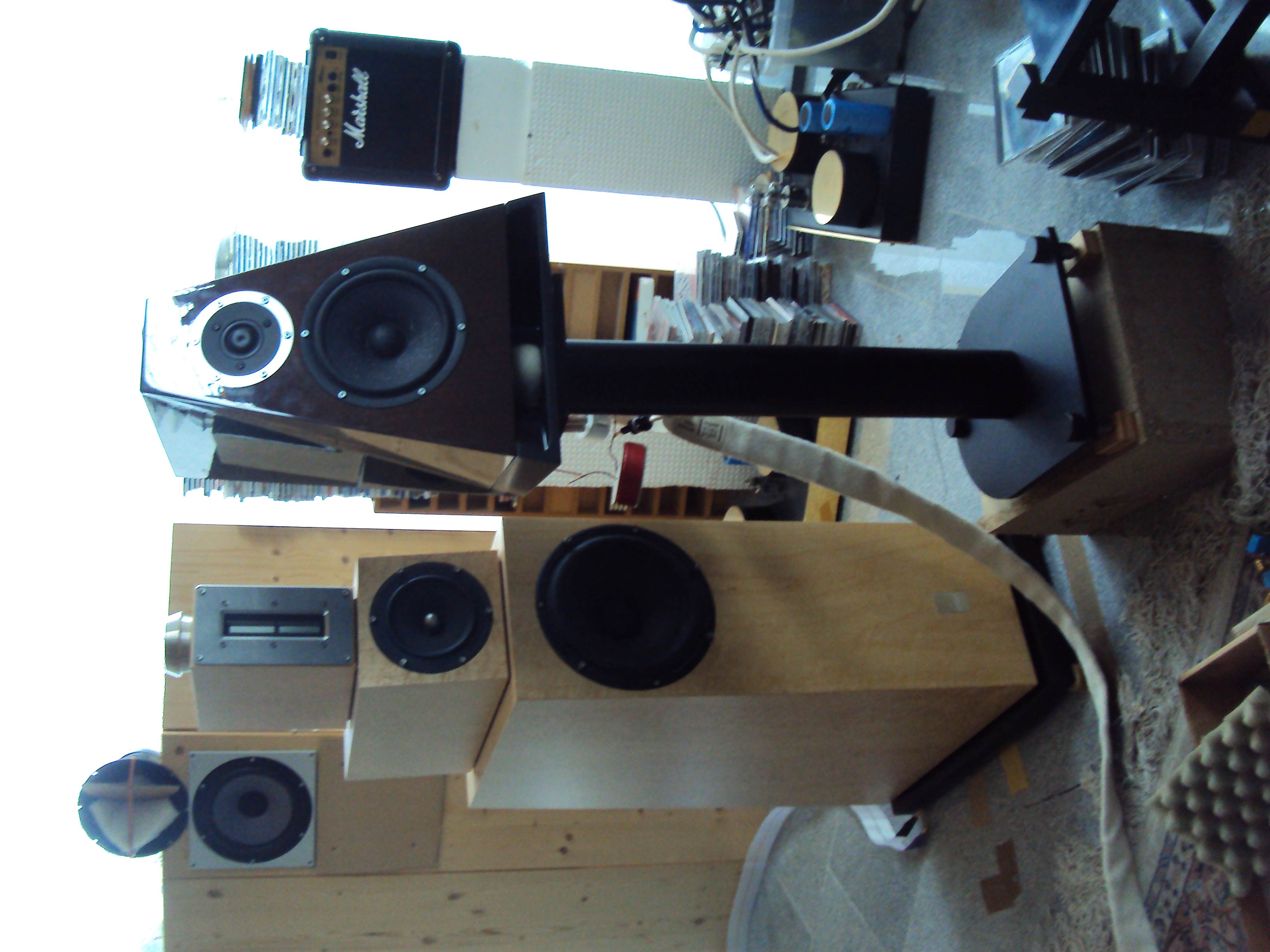

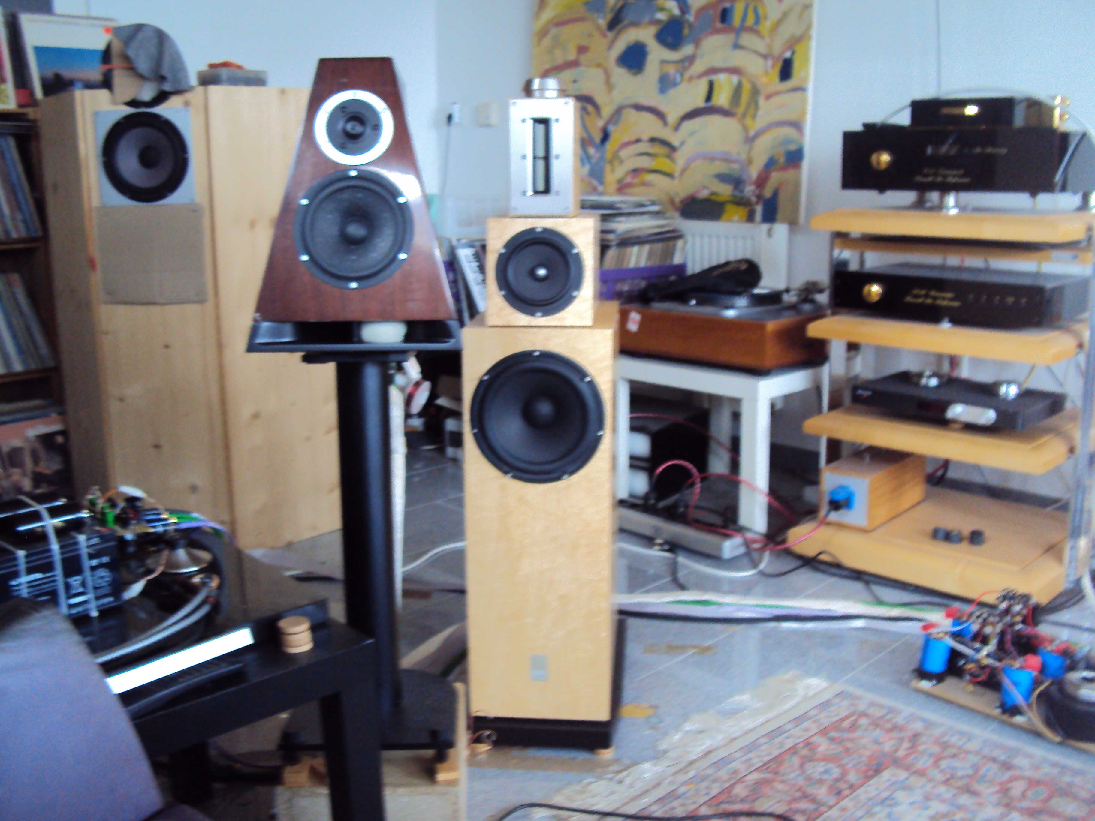

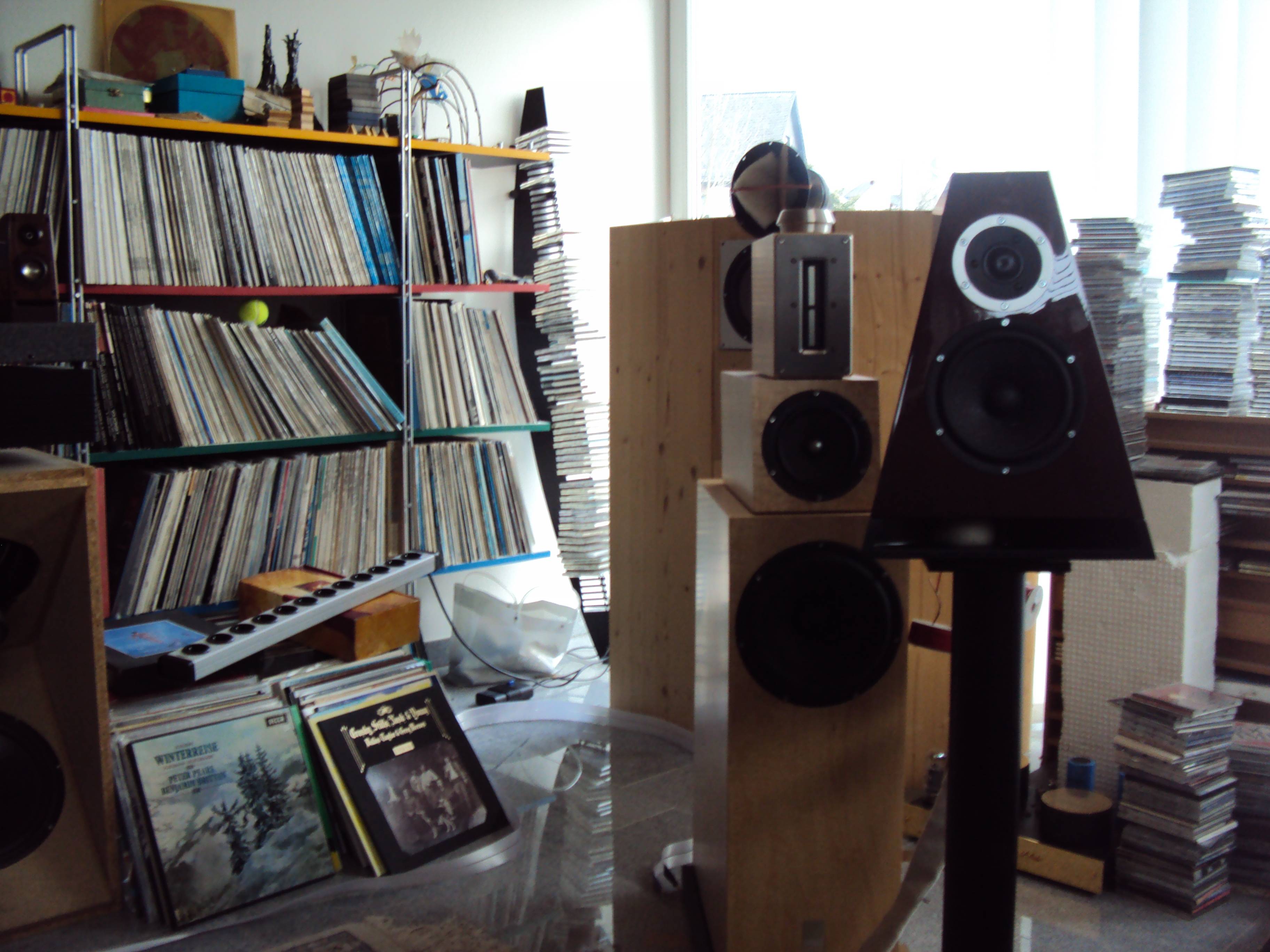

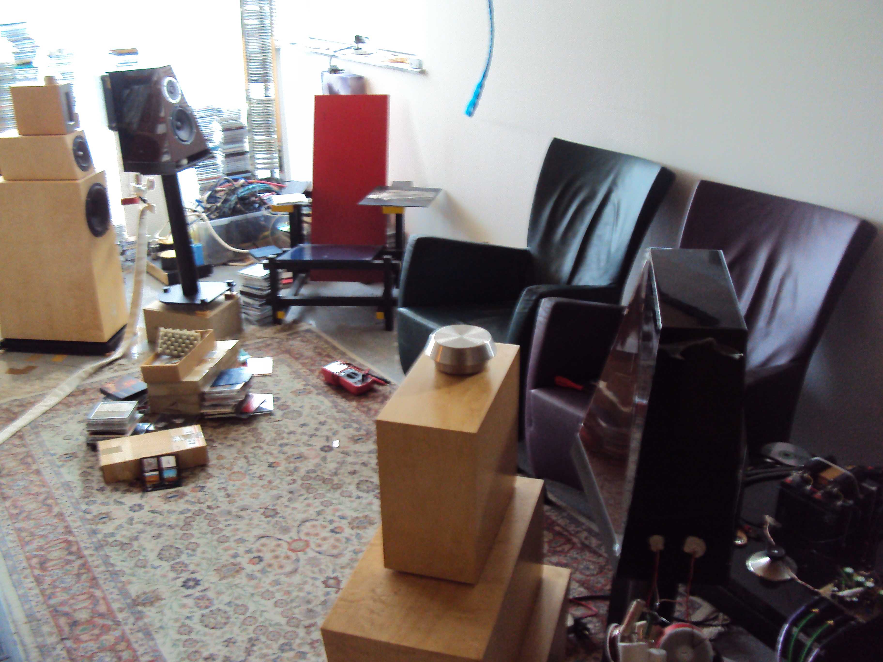

Here are some pictures of my current setup. I sit close to the back wall.
The speakers are around 2m from my ears and quite far apart, maybe 3m.
There is no hole in the middle of the soundstage.
The monitors sit on high stands so that my ears are between the woofers and the tweeters.
I cross the Satoris over at 80Hz with a 6dB passive filter to my active M-Dipole bass.
More information soon or just ask me.

Joachim,
Nice pictures of your present setup. One of them-the last one-with the blue power capacitors which are bypassed by the red capacitors have my attention. Which value do you have used for trying out? Read: Power Capacitor : Bypass Capacitor? I am working with Mundorf M-LYRIC HC-10.000uF-80VDC. Do you have an advice?
mbrton,
mbrton,
The power elcaps are B&C, i think 10.000uF or bigger.
The bypass are WIMA MKT, i think 2.2uF.
The M-lytics are even better, the best i know actually.
The bypass cap is kind of a philosophy.
I can be that when you bypass too strong the combination of elcap and bypass can resonate. I would start with 1uF MKT.
You can go up to more, say 3.3Uf and also can try Polypropylen.
Here on the forum you can find advice of how to optimize but then you have to measure.
