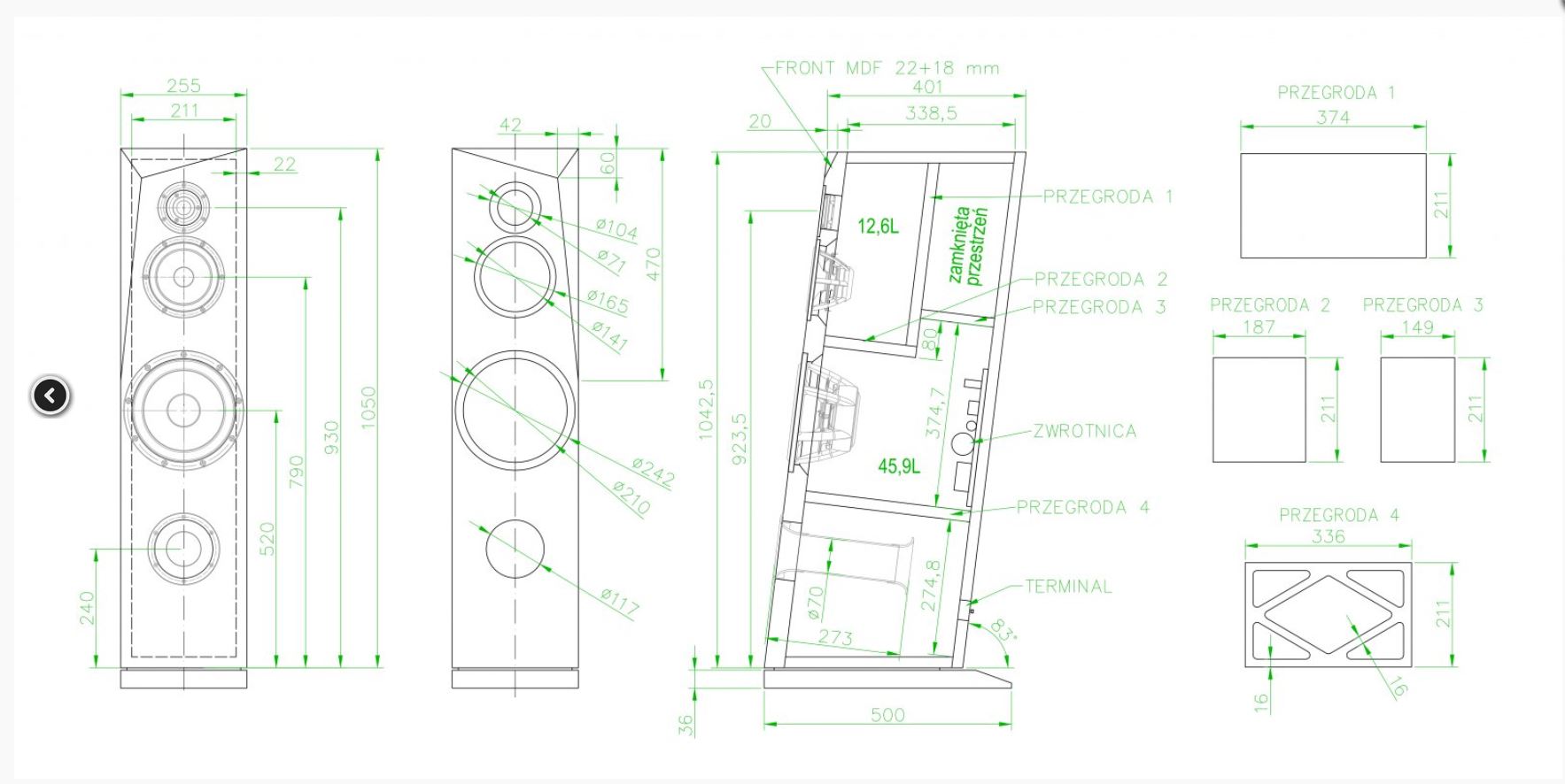

Did anyone build Rinjani KIT acoustic cabinets?
Could someone have a detailed photo of the Rinjani cabinet build?
I want to build the cabinet myself as on the original.

I take it you have seen this.
It doesnt tell the whole story, but you should be able to gleen the fundamentals.
http://sbacoustics.com/wp-content/uploads/2017/10/SBA-Rinjani-cabinet-drawing.pdf
Yes, I need more details.
If someone who bought the Rinjani KIT took pictures or videos of how the cabinet is constructed inside, it would give me more understanding of how to build the cabinet.

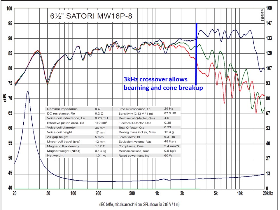

SB Acoustics Rinjani T-M crossover frequency is 3kHz, which is higher than praised USA designs which use a 1,700-1,800Hz crossover.
From the audioXpress review: "In an anechoic or critical listening environment the peaks at 4 kHz and 5 kHz may present themselves as a bit harsh" This beaming comes from the 6.5" cone operating at 3kHz and above with a modest LR2 crossover circuit.
If you already purchased the drivers, just experiment placing them them in your room to aim the midrange at the main listener.
If you can accept a 2" wider front baffle, search for Satori 3-way T-M-W kits using the Satori TW29R Ring Dome Tweeter, Satori MW16P-8 6" midrange in a sealed cabinet, and the Satori WO24P-4 Woofer
Using the Satori MW16P-8 midbass in a sealed volume allows a 100-150Hz woofer crossover from the Xmax=13.6mm, and a 1700Hz tweeter crossover. Using the Satori MR16P-8 midrange will produce greater midrange detail, but its underhung Xmax=6.2mm motor favors a 200-250Hz woofer crossover and a 1800Hz tweeter crossover.
