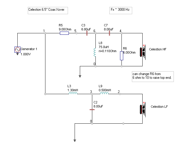

Awesome! ThanksHere's a crossover for the Celestion 6.5" TFX coax that I did for a friend.

I've tried to replicate the XO in Vituixcad to no avail... this is for the TFX0615 or for the TFX0617?
Cheers
This was done about 4 or 5 years ago. I believe it was the TFX0615, but don't have them here to verify.

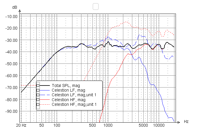

The raw driver measurements shown on my spl plot seem to correspond fairly well with the TFX0615.
Note that L8 is 75 uH (.075 mH). LspCad automagically changes units like that sometimes and catches me.
Worth a check. Hope that helps.

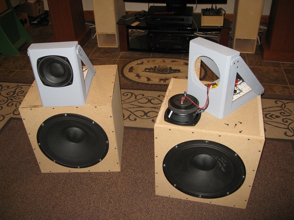

Did you get to audition it? If so, how would you rate the sound?Nice driver.
Actually that's a TFX0617 with compression driver, not the TFX 0615 with dome tweeter.Sound is quite good. Nice detail. Only drawback is that it doesn't go low, but we added a 15" bass unit for that.
Open baffle for both. U-frame for bass unit.
