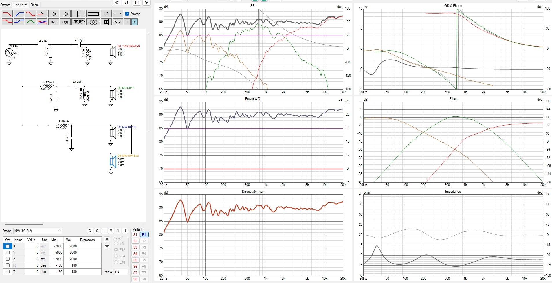

I had my first proper experiment using VituixCad.
I traced the plots from the driver brochures.
I've used all 8 ohm drivers, then the 2 x MW19P wired in parallel to give 4 ohms.
Found i had to invert the mid to make the graphs look right.
I added an Lpad to the tweeter to bring it down a few db.
Not 100% sure on working out crossover points correctly, but i went with 300hz & 2khz. 2nd order Linkwitz as it looked like a good midpoint on the graphs where it was relatively smooth either side.
How did I do?
A couple of questions...
Thanks all.
How did I do?

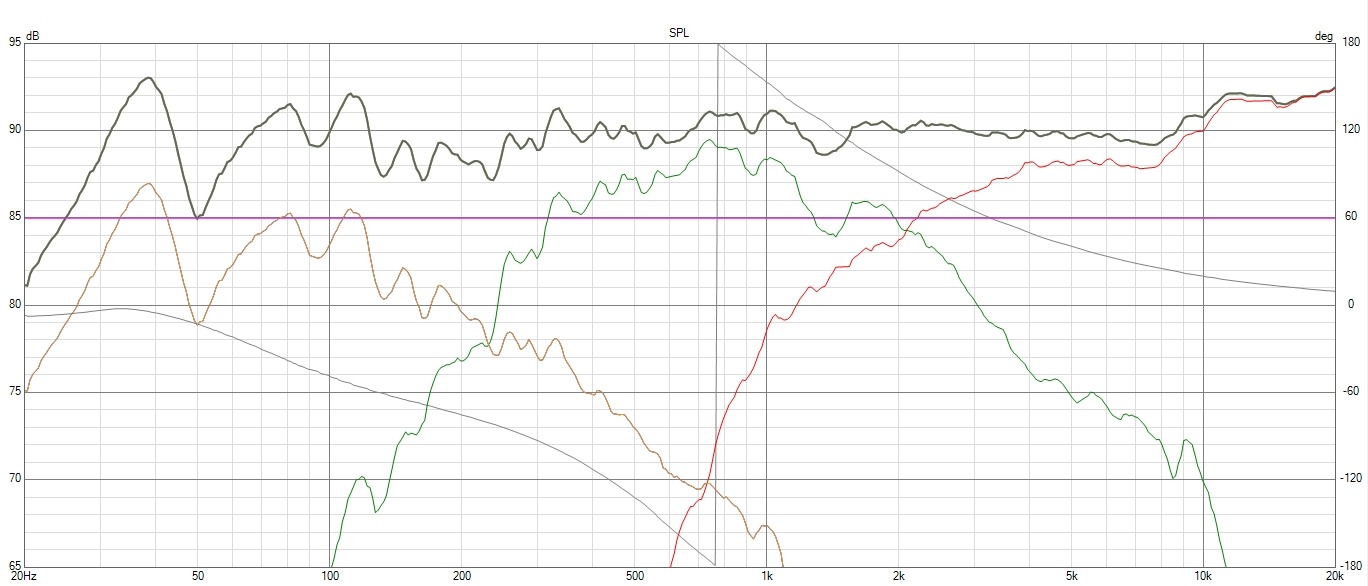

- I've got the lowpass on the woofers at 300hz. Those drivers have a fair bump at about 38hz. Am i suppose to do something to tame that down? (notch?)
- I think I will plan on having the speaker sealed, as it will be mounted pretty close up against a wall, so i dont really want it ported back into it.
- When i look at the total frequency response, it is a bit up and down, but it's only within a few db. What the accepted norm? Eg. I often see a speaker advertised as for example +-3db 50hz-20k. Does that sort of mean you will always have the lumps and bumps when its not a smoothed response, +-3bd is fairly normal?
- Also one weird thing i did discover with inverting drivers, there is a very different phase response when I have the mid inverted, vs having the tweet and woofer both inverted. Only discovered this as I don't really know what im doing lol. Im assuming you invert only one driver, not the other two.
Thanks all.
Jim,
The drivers should be as close as possible.
If you want an MTM like this.
LF-MF XO art or below the centre to centre of the 2 woofers.
dave

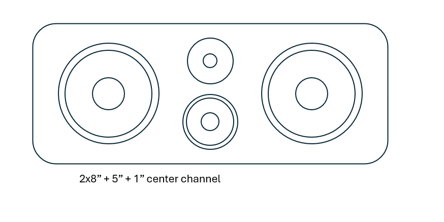

I think before designing, you should consider the position of center speaker first, because most of the time, your ear level is on the same height as position of the TV, not center speaker. The height position of the center, and its relative position to your ear level is important factor, as it will indicate which off-axis you should make the best optimization for. In my opinion, the most benefit of diy is that you can cater the design to fit your need (or your WAG), similar to the bespoke clothing.
After choosing this design specification, the design process can begin. You can have two options. 1st option is Jim & Dave suggest (WMTW), 2nd option is WCW with C is 6.5" coaxial driver. I think the second option is also worth checking. Firstly, it avoid lobing if crossover at 200-300 Hz. Secondly, since center speaker have tendency to be lower than ear level, it avoid one of big problem with coax driver, that is some irregularity in frequency response on-axis.

1. Yes, compared to a one concentric driver, then horizontal lobing of coax with WW is inferior, but the frequency range of lobing effect is not too large if appropriate crossover frequency is chosen. If woofer is 6.5" driver (SEAS L18) and all driver are kept closely, in crossover frequency c-t-c distance will be 34.5 cm, which is equal to lambda/4 of 200 Hz. So even though the lobing still occurs effectively somewhat to 400 Hz, it is not too much problem here. In addition with WCW format, at least we can force a symmetric lobing. And non-linear distortion will be lower than one coax driver only.
2. Yes again, 6.5" coax is inferior to 5.25" coax in terms of coherency, but 6.5 coax can allow 200 Hz crossover, to reduce the lobing. After all, speaker design is always trade-off games. And the Sica 6.5 coax is not too bad compared to Sica 5.5 coax.
If output is not problem then WCW with 5.25" coax, 5" woofer with crossover at 300Hz is also fine. But the distortion trade off is still there

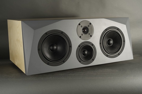

- SB Acoustics - Centre Channel Design
