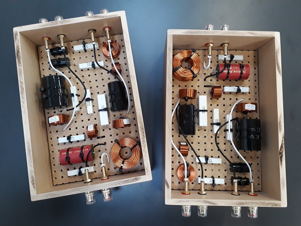

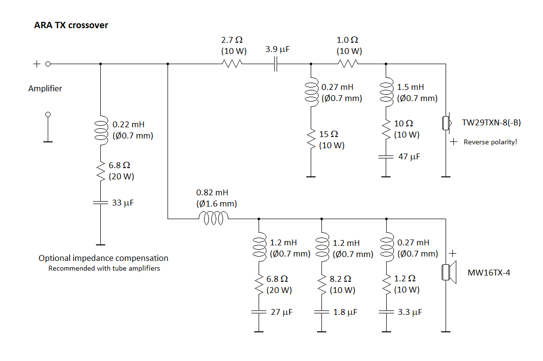

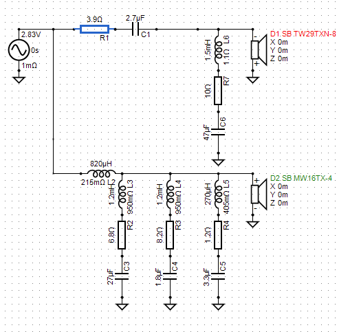

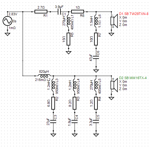

Sorry, I didn't see this post until now. I designed a dedicated crossover for the ARA-TX. This is a different crossover configuration compared to the other ARA models. It brings out the best in these drivers (dynamics and transparency). I built external crossovers for these speakers (it was a little difficult to fit everything inside the cabinet, though it is doable if you split it on two boards). You can also find the schematic on SB Acoustics website under Open Source Kits. I'm not going to elaborate on the design here.
Yes! This is not unusual with 1st order networks. One equalizes the single break-up (peak) above the crossover point, one shapes the upper roll-off (and corrects the phase) in the crossover region, and one deals with the baffle-step. This ensures a neutral balance, excellent integration with the tweeter and no residual energy that would otherwise cause a little bit of coloration.
