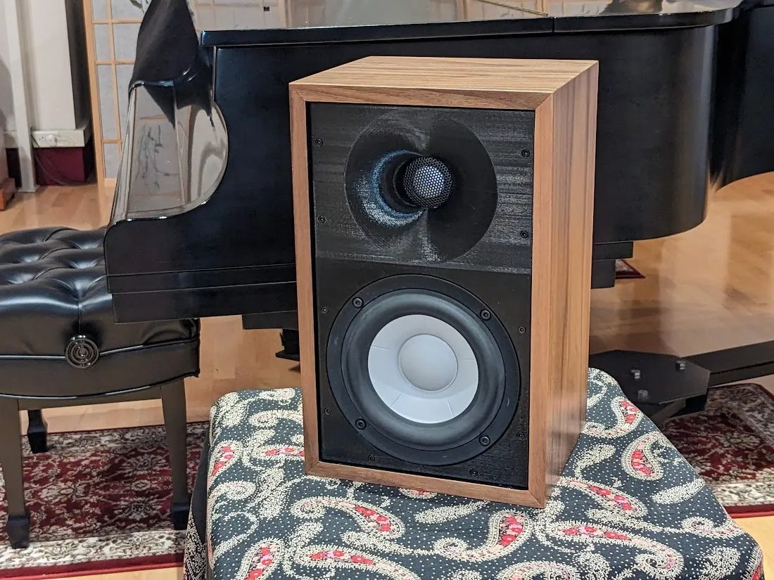

That is an excellent woofer for the price. I used the 5" version of that SB woofer in my contest winning 2-way speaker pairing it with the Visaton 1" ceramic coated aluminum dome in the waveguide. KE25 SC-8.
https://www.digikey.com/en/products/detail/visaton-gmbh-co-kg/KE-25-SC-8-OHM/10649837
If not using a waveguide the SB tweeter with the white dome is also excellent.
I put them in these 12" tall LS3/5a replica cabinets that are often sold new on eBay. I 3d printed the front baffles. If you're interested, I can share the drawing files for the front baffle. You would have to modify the size for the smaller woofer. I put a notch in the crossover to kill the cone breakup peak.
