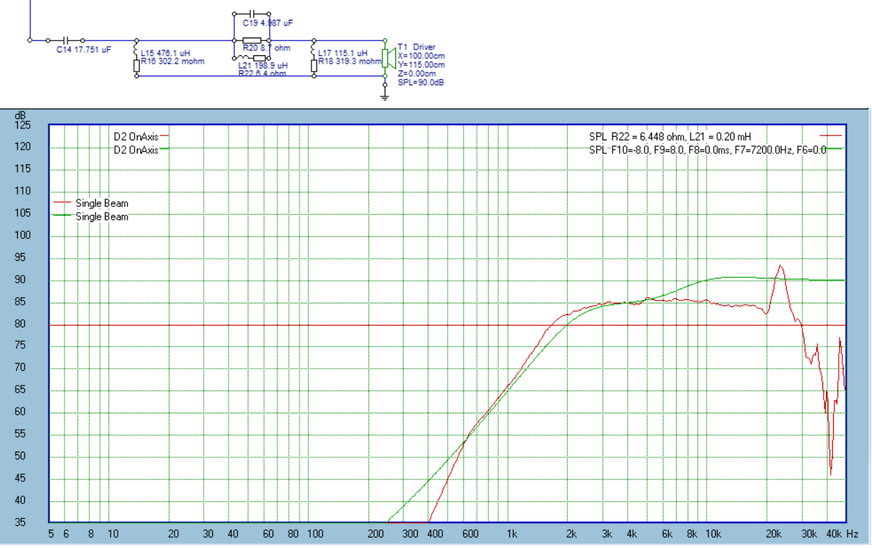

Thank you! It took me lots of different approaches to make it ruler flat 😁Ah yes, doing the same thing but with the 5khz bump instead of the 26khz breakup. I like the result!
I'm glad you like solution.
I guess that my build is 85db then.. good to know.I modeled optimized values into my crossover.. spl is the same, only impedance plummuted to 3 ohm at 2khz.Riffing off yours, I let the optimizer go to work. I have not standardized the values or made sure they are sensible, but it looks like a good place to start with nominal sensitivity of 85 dB. (BTW this the SB26CDC on the 6" waveguide on my TM, so not exactly the same as you have)View attachment 1235330
