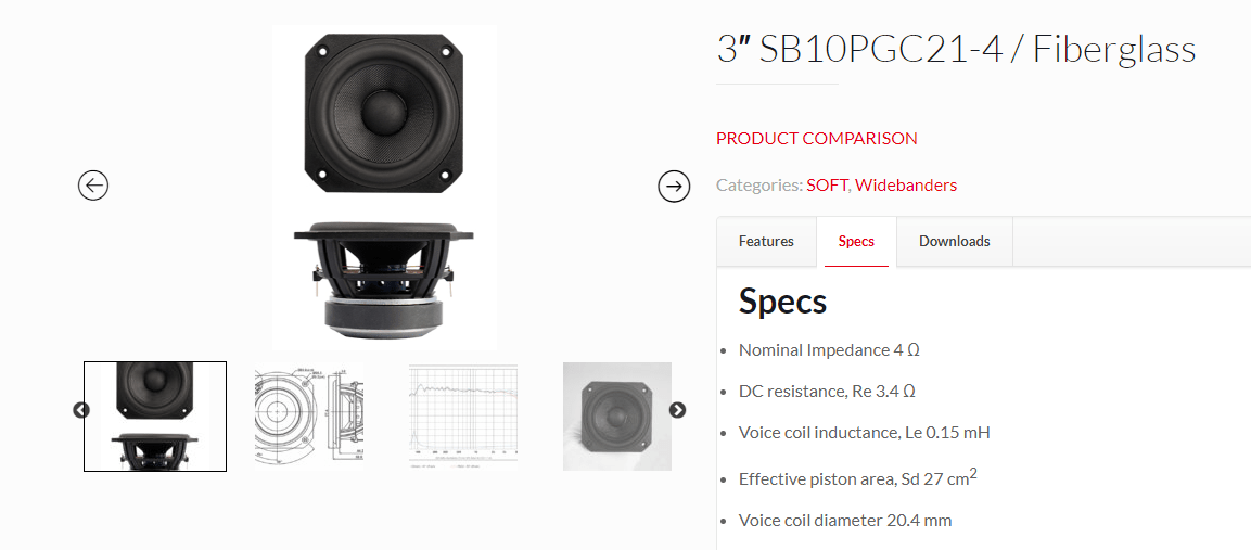

SB Acoustic 3″ SB10PGC21-4 Sealed 3rd order Butterworth Plan

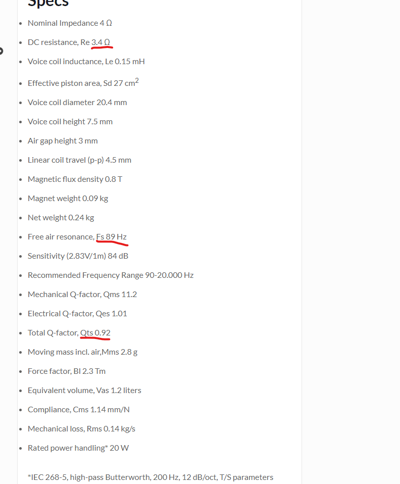

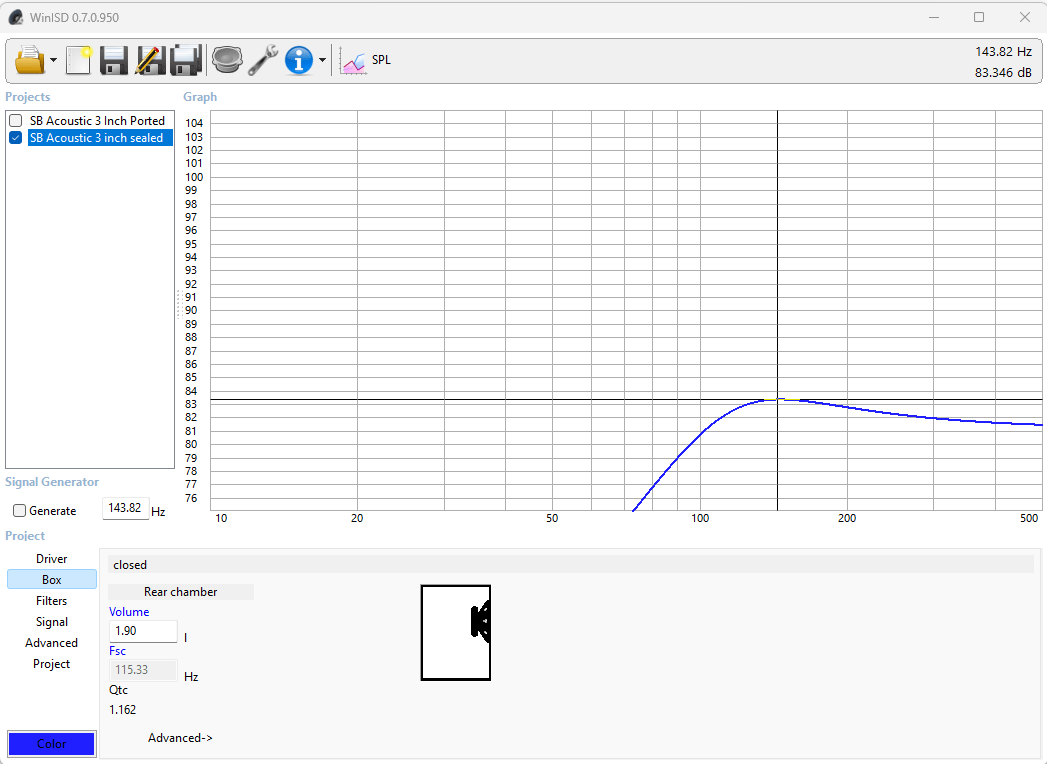

Got this little speaker here from discount. Since I need it to be portable for my office, I planned to make it small. (probably around 1.9 ~ 2 liters, sealed with QTC around 1.15~1.16, probably a bit less with additional stuffings). I don't expect bass from this because I planned to get a woofer/subwoofer in the future & probably build 2.1 or WAW system (but that's another topic)
I do need to tame the bump around 140-150 hz after some testing with WinISD. so I will put a capacitor in series for a bit of highpass.
Now at my place, the BP capacitor available here r only 100uf, 220uf, 330uf & 470uf. although not ideal. which one should I buy?

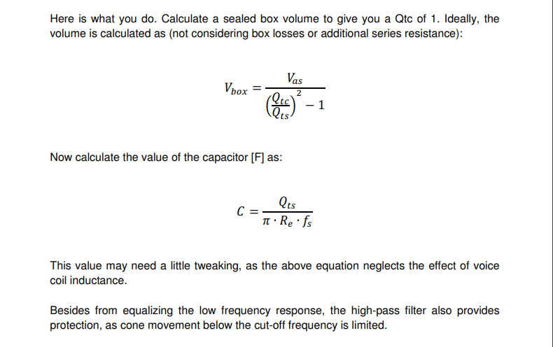

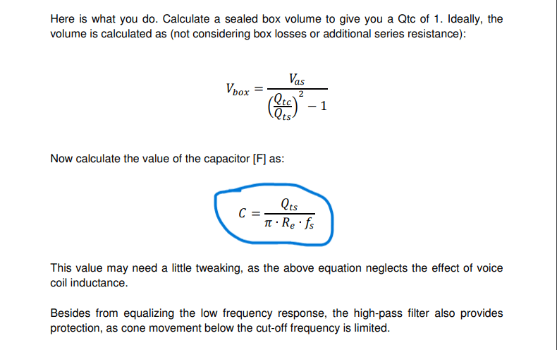

Also SB acoustic did have the formula to decide the capacitor value.....but I only know basic math, tried to search & learn it from google with no avail.
Thank you in advance.

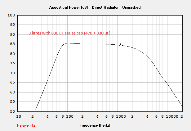

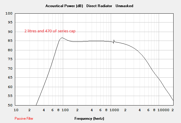

Hi WibuSquire,
here is a quick Hornresp Simulation with 3 litres and a 800 uF series cap (by paralleling 470 and 330 uF).
even higher cap values will give a more rounded (lower Q) resonance peak.
If you make the enclosure smaller and / or reduce the capacitance there will be a stronger peak at the resonance, just above lower rolloff.
here is 2 litres with 470 uF:

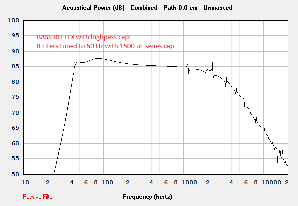

EDIT 2: just for fun, here is a bass reflex tuning with high pass series cap:
I know, you don't need that, but it's still interesting.
group delay is high at resonance (35 ms) and Xmax limit is already exceeded with half a watt at 40 Hz.
Thank you very much STV. also the included graph r really helpful
noted. then that means I can just combine the capacitors. in paralel.
Also ah yess, the 5th order bass reflex LoL
I'm starting to order the material for the box . so now I'm gonna decide the volume as well (Ideal size would be 2 liter, but I can crammed 3 liter as well)
so 3 liters with 800uf capacitor should do I think

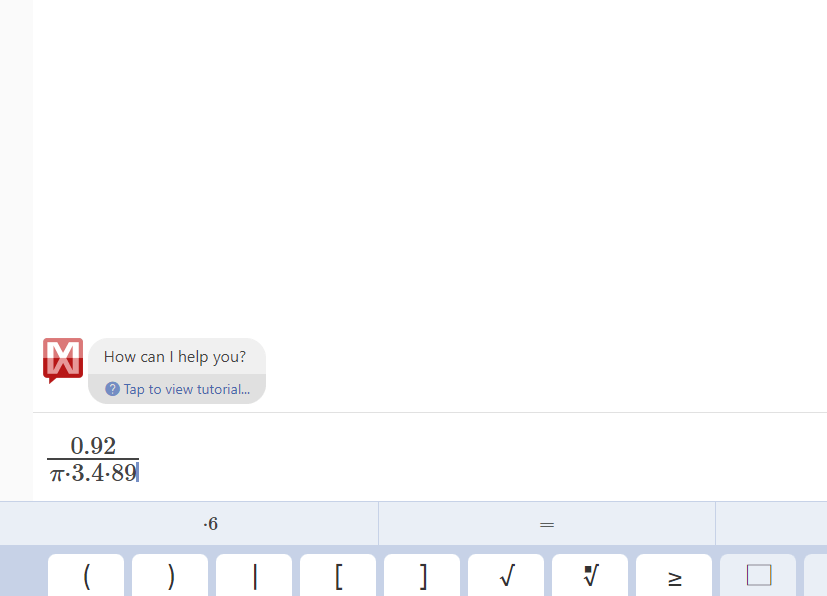

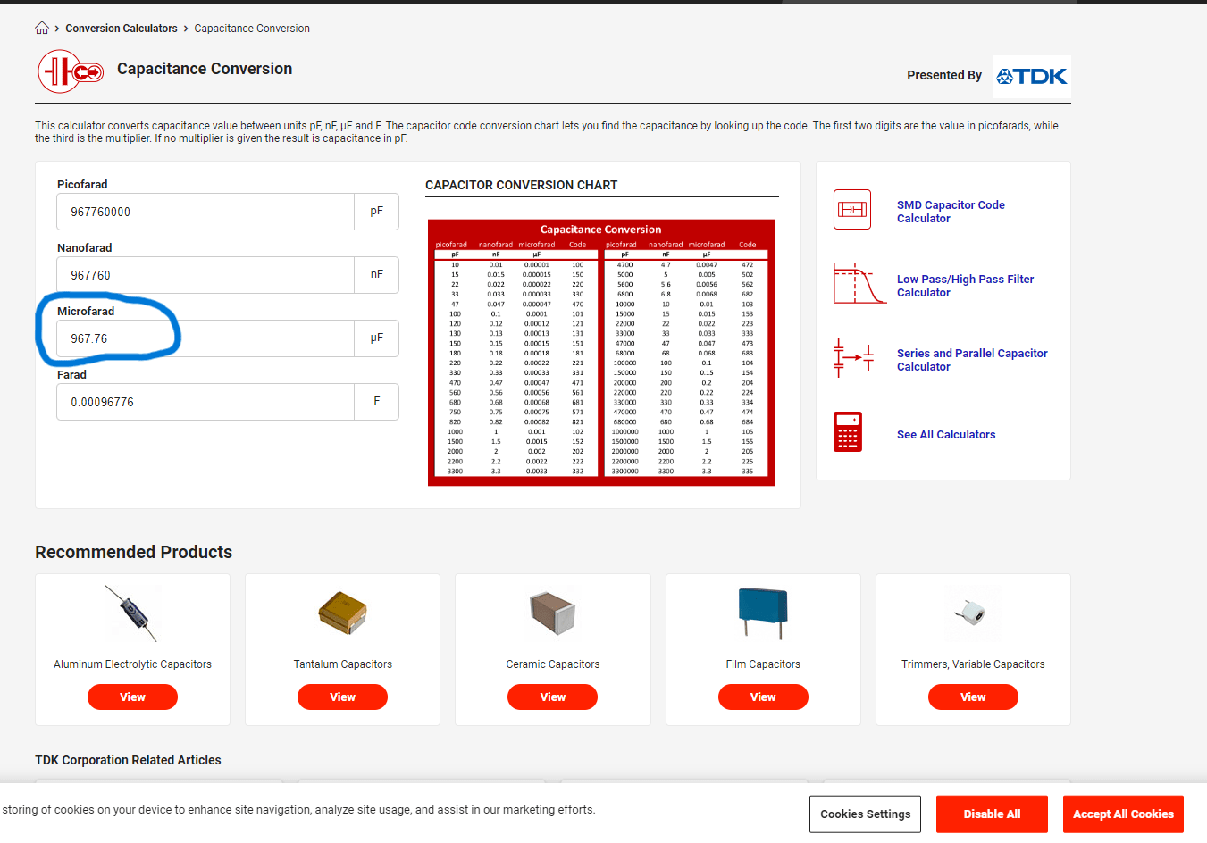

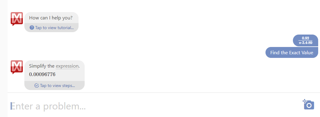

I think I manage to found how to decide the capacitor value. CMIIW, if I Input that SB Acoustic formula on online calculator + Farad to microfarad conversion I got 967.76uf. I guess its doable (hopefully)
if I just go buy some couple of 470uf bp Capacitor & parallels it, I should able to get about 940uf which is close enough

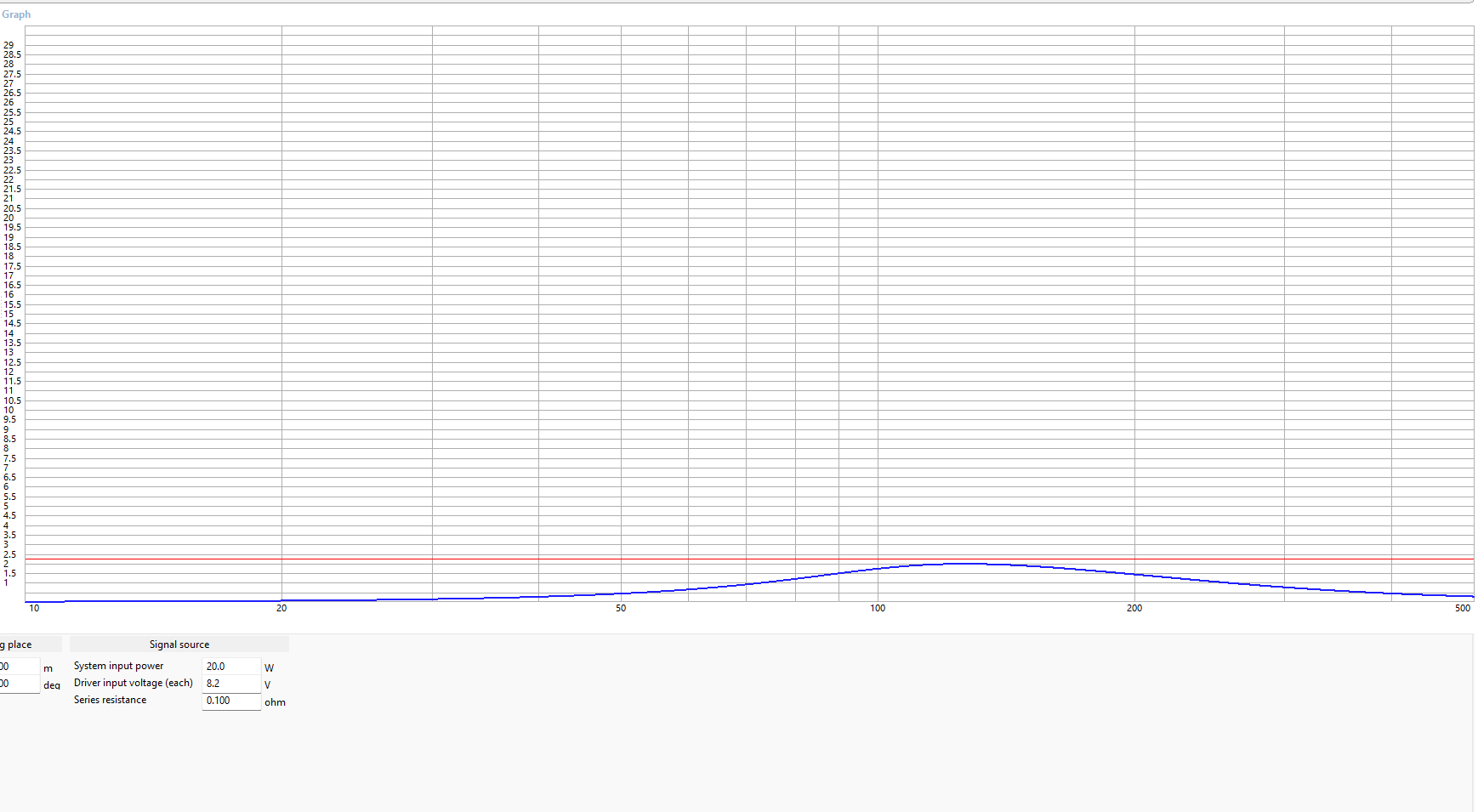

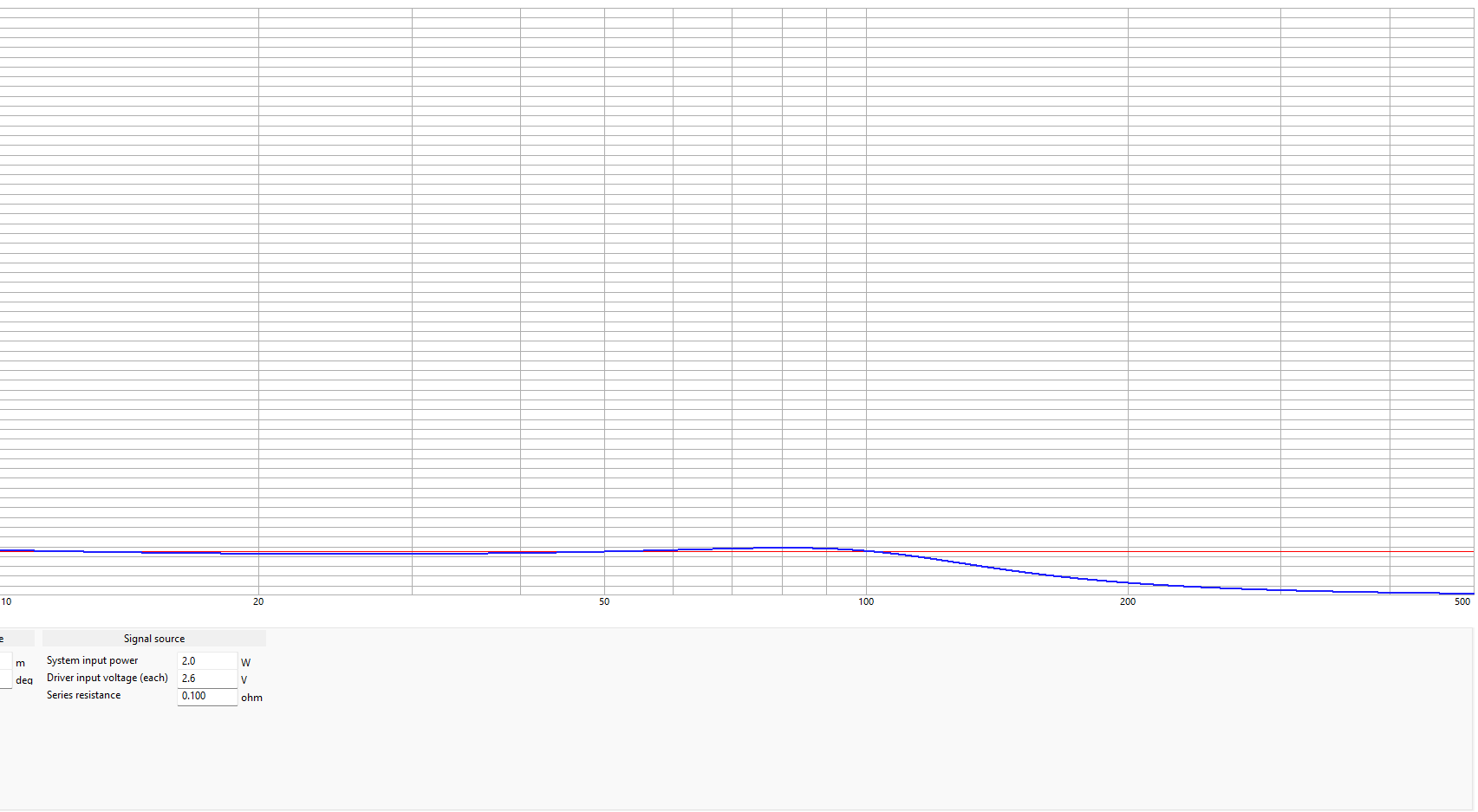

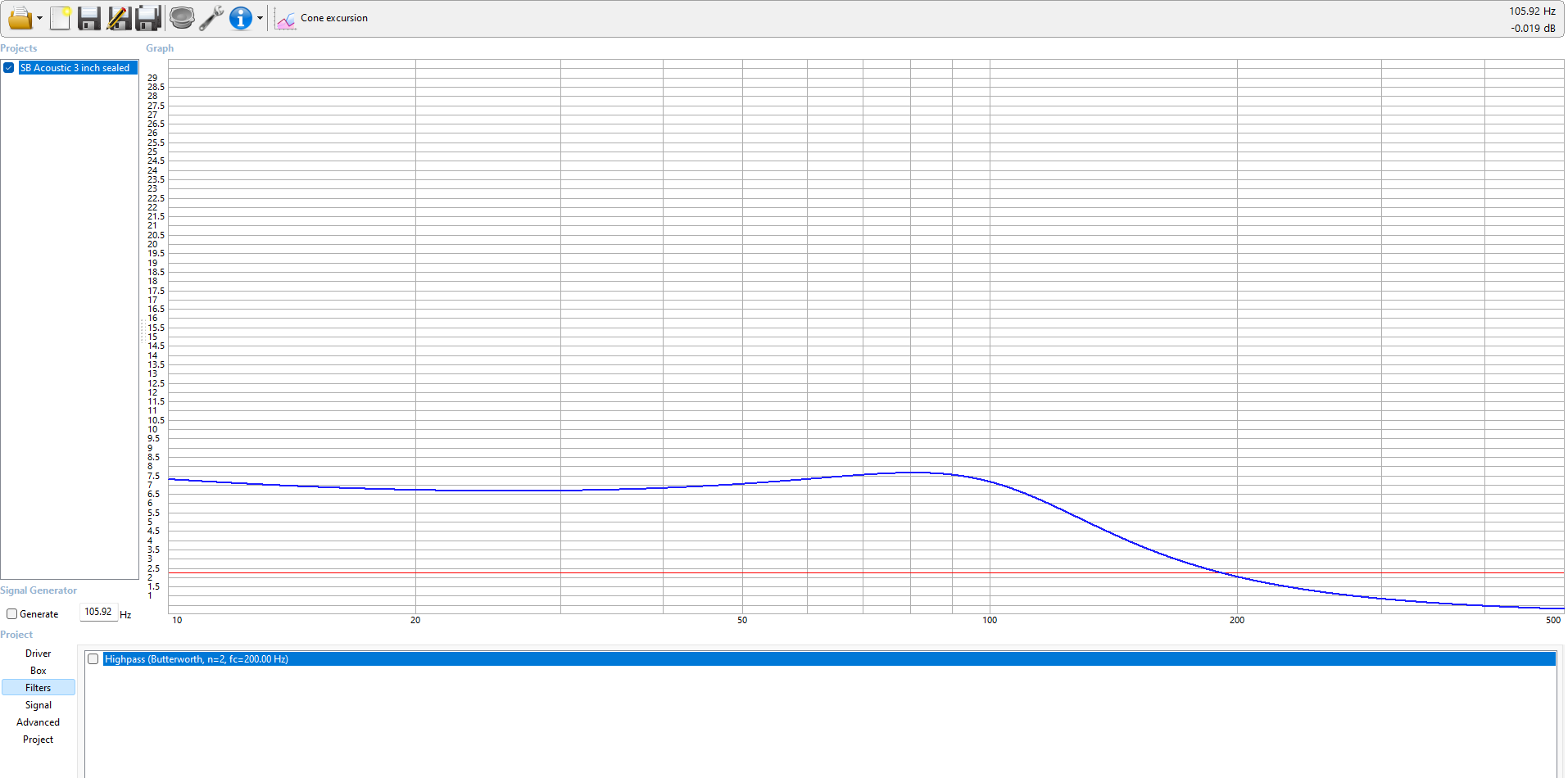

necro the thread because I need to reconfirm
the site basically said that the Power handling for this speaker is 20* watt RMS (*you have to use 2nd order high pass filter at 200 hz for the speaker to be able to handle that without over excursion)
now if I don't use 200hz highpass filter, 20 watt is too much for the driver (2 watt is probably more tolerable)
Does that means this speaker is strictly for FAST/WAW setup with common sealed box?
