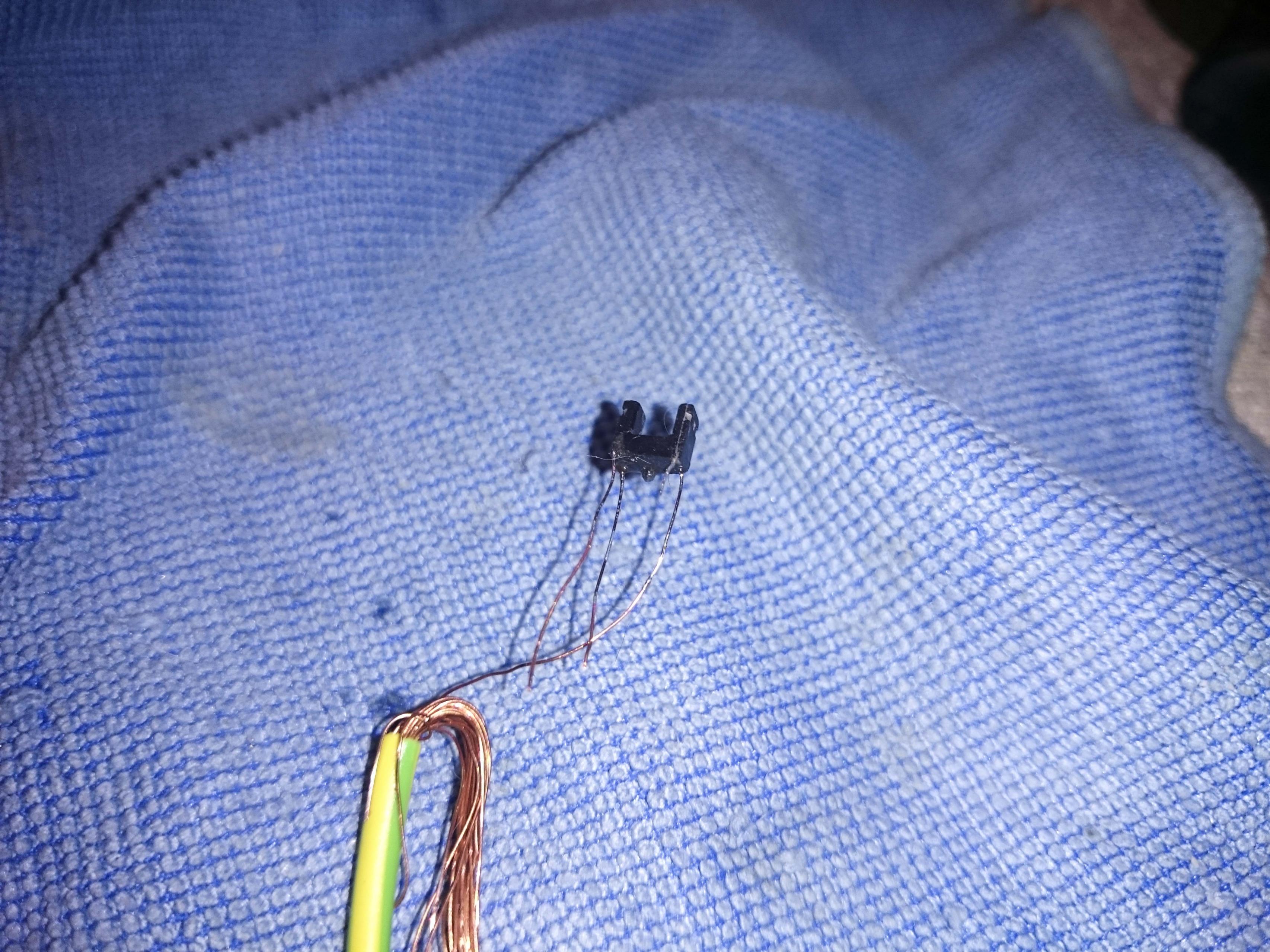

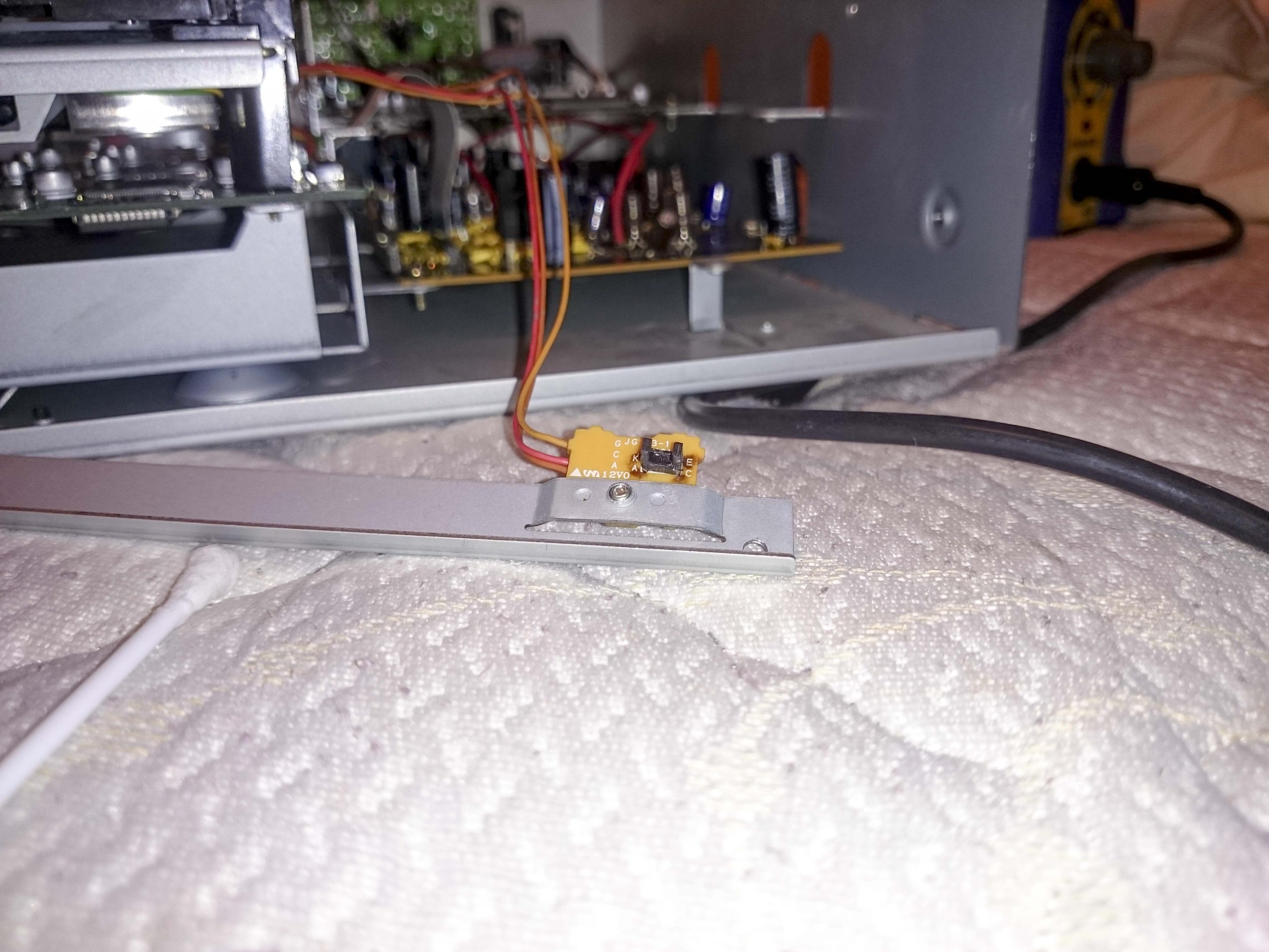

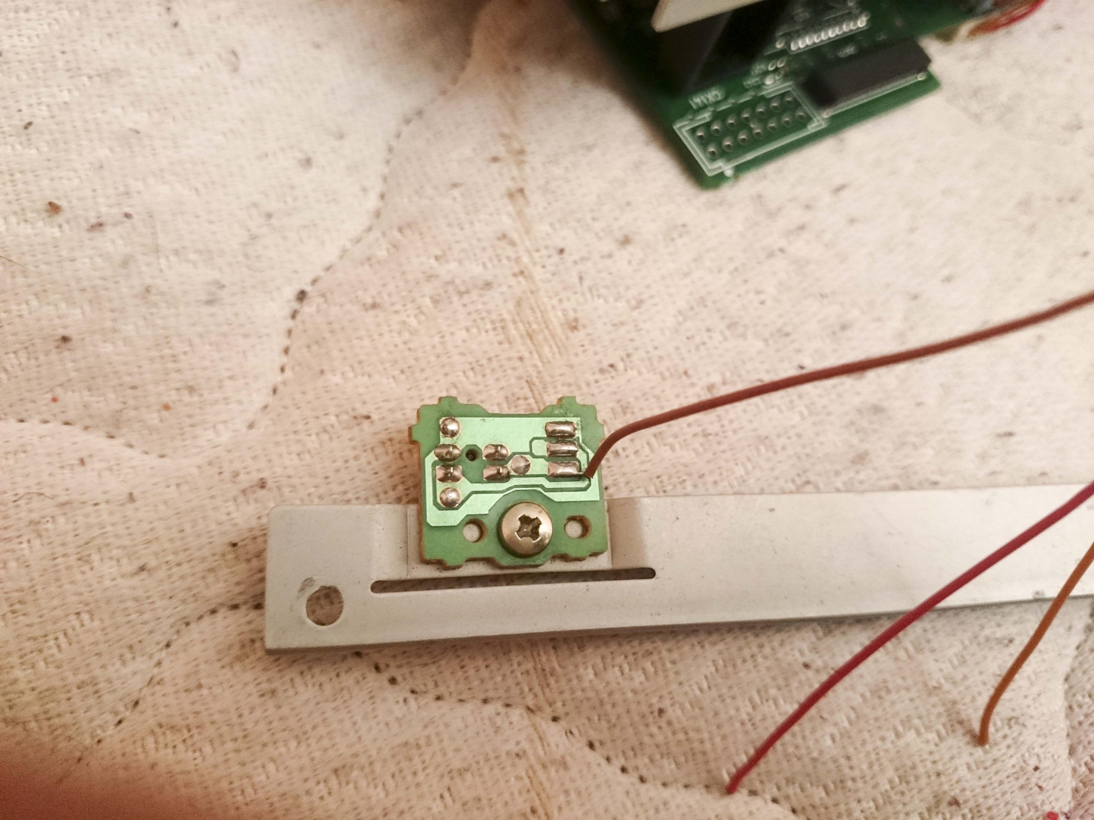

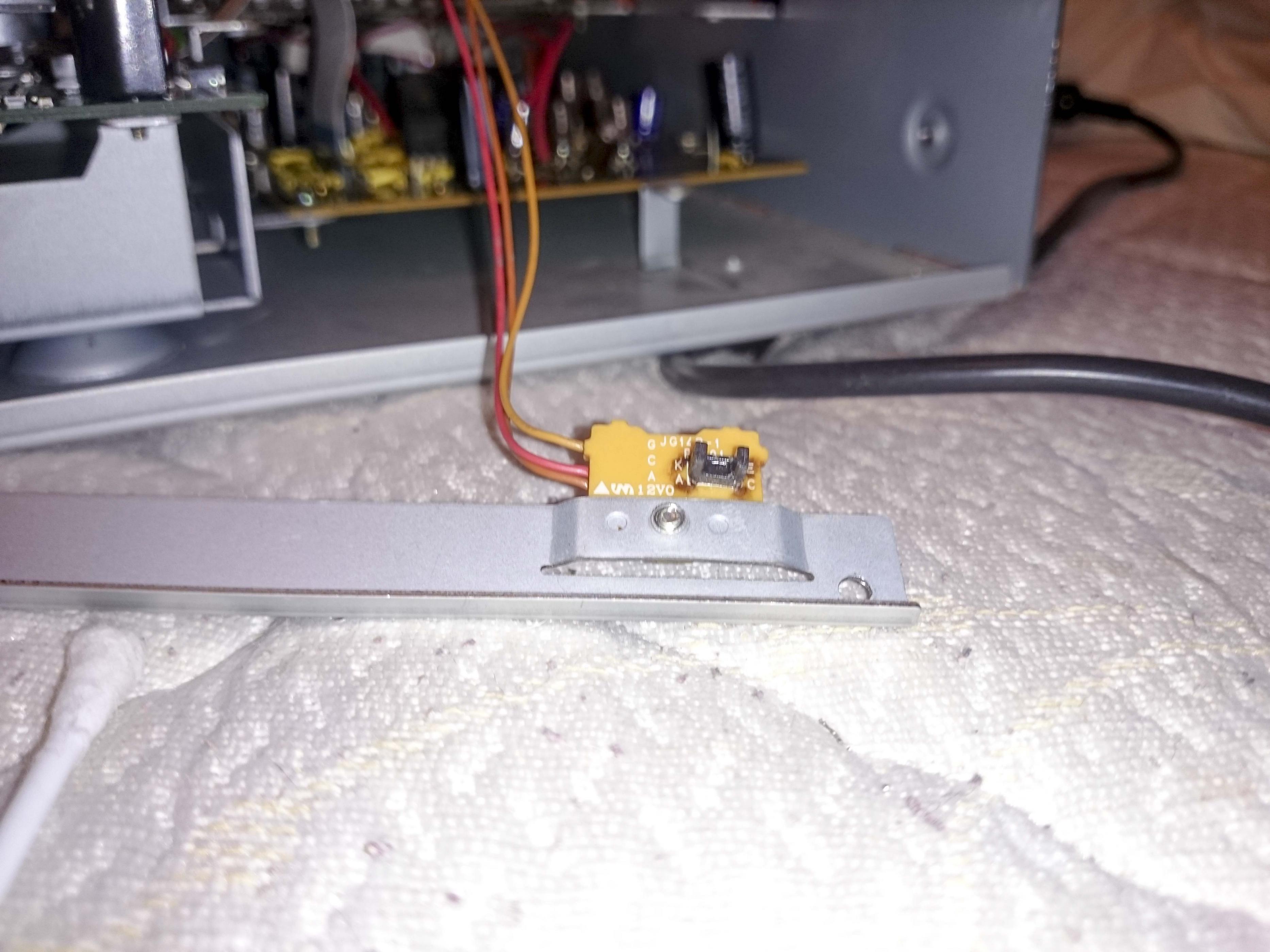

During the repair of denon dvd 2900
Stuck tray.

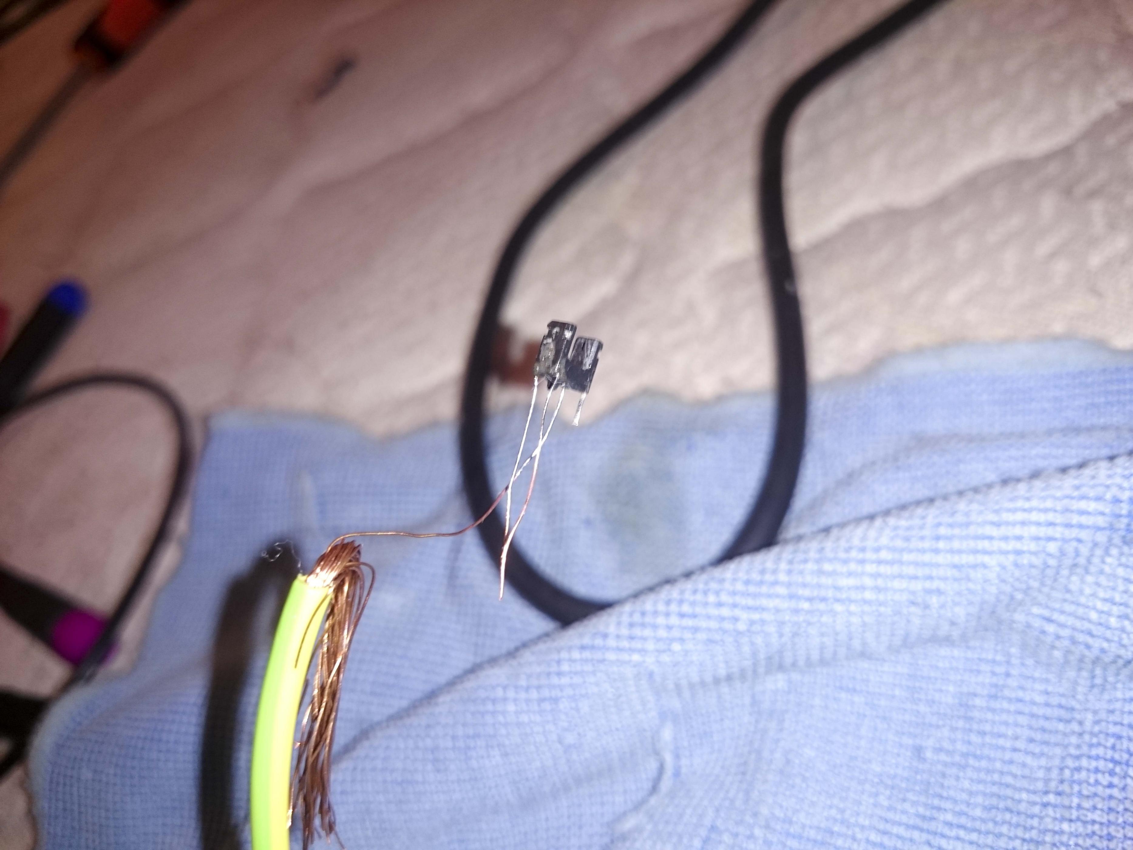

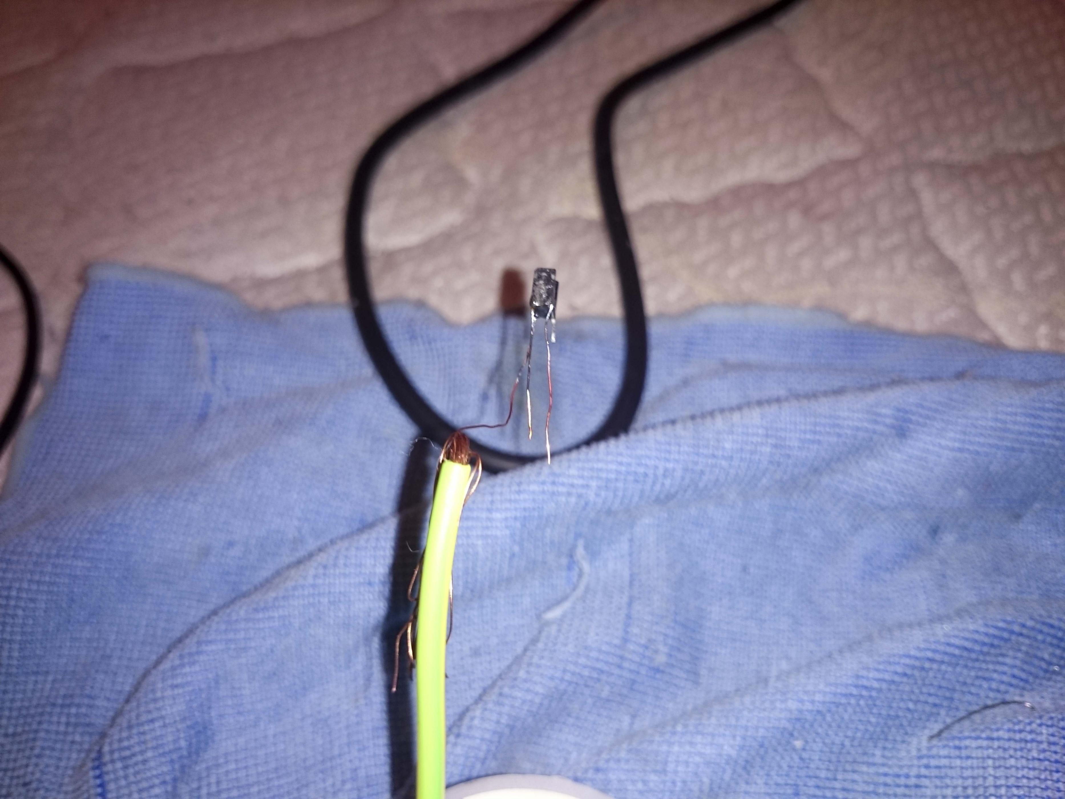

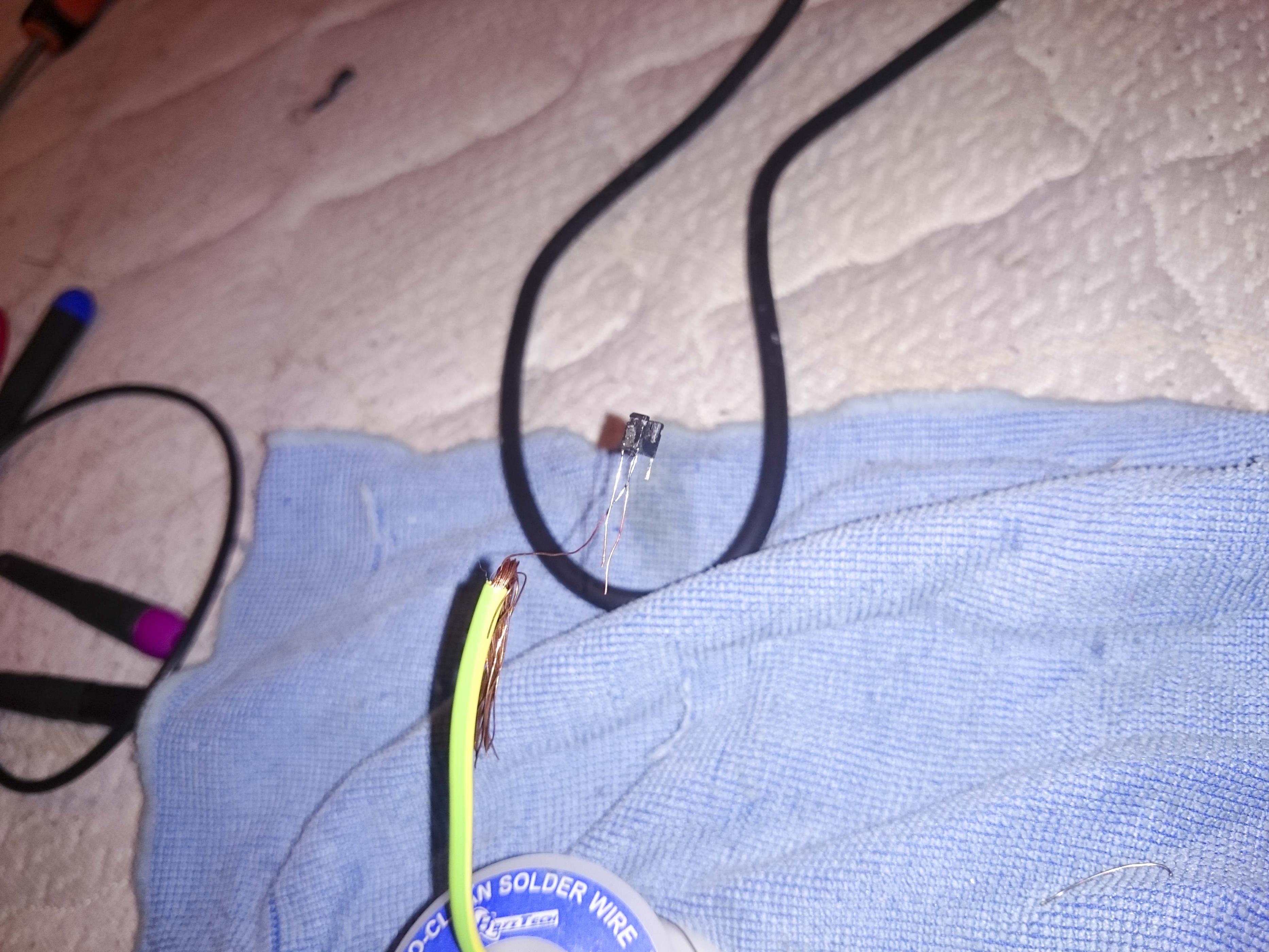

accidentally broke the optical sensor
the 4 legs Completely broken .
So I tried to save part.
Carved with a knife the plastic of the sensor
And stitched with thin copper wire
4 new legs
And working to my astonishment
Video of the tray is closed after opening the attached youtube link
