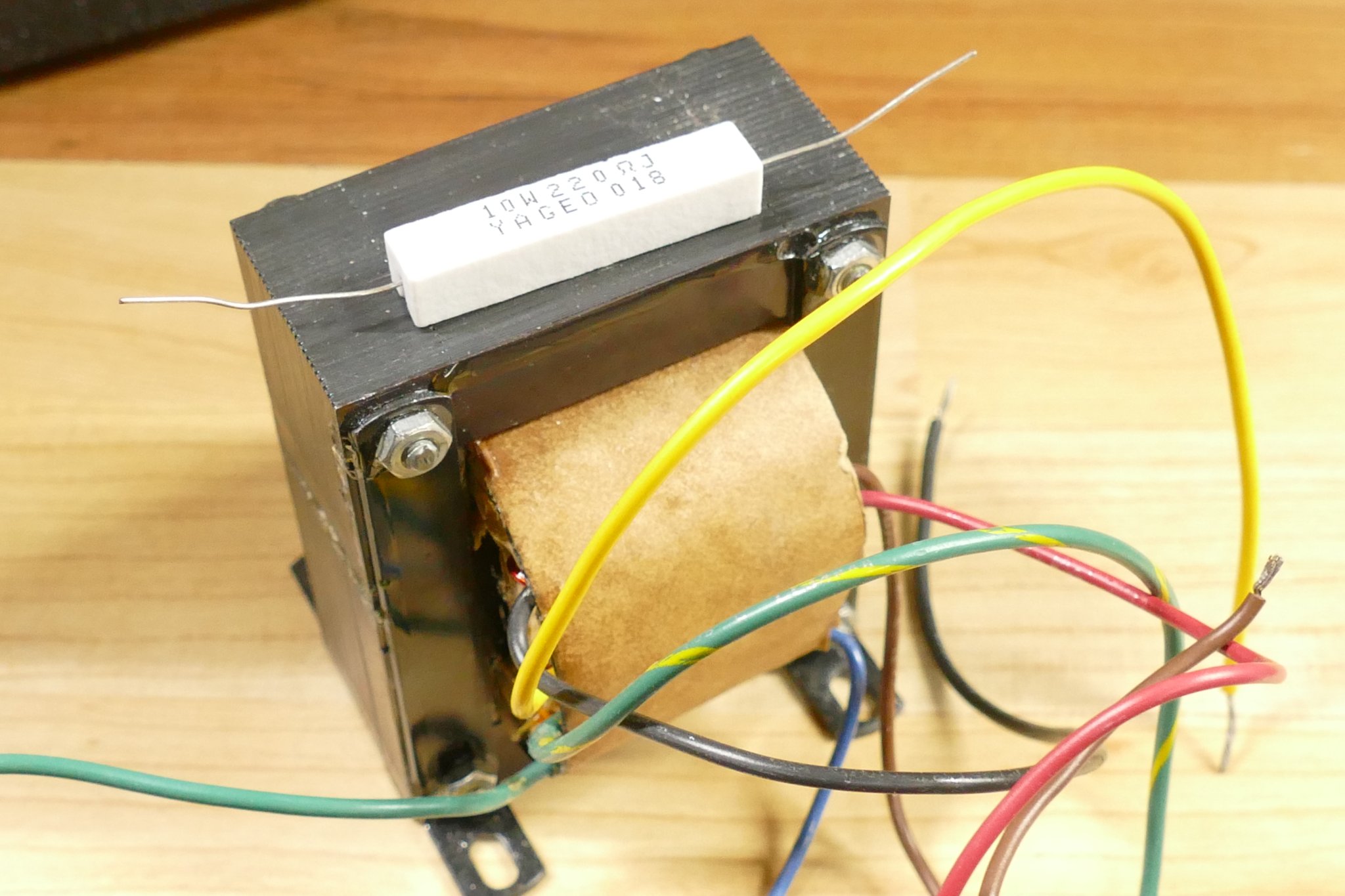

One of those white ceramic "cement" resistors rated at 10 watts and 100 ohms wired across the speaker terminals allowed me to unplug the speaker at full crank on a test amp without any fireworks. This amp used TV sweep tubes for output and a generic 6600 ohm guitar amp quality OPT that was wired for 3300 ohms. I set an identical OPT on fire several years ago when my DIY test load made with Radio Shack parts failed to an open. The same large sweep tubes were used in both tests. Some would argue that the resistor consumes a few watts of power and affects the sound. These are true statements, but losing a couple watts on a 100 watt amp would not be heard, and the sound IS changed according to the scope pictures.....that nasty spike on the trailing edge of a clipped square wave gets rounded off a bit. To me it sounds better.

The nasty spike on the trailing edge is high frequency content. A zobel network of 0.1 uF and 10-20 ohms does pretty much the same thing without as much waste power with typical music.
The spikes will go away completely with free wheeling diodes. Clipping is flat top.
A zoebel network works great on a HiFi amp that rarely sees clipping. The resistor smokes and the cap gets hot on a cranked guitar amp, as it must dissipate all that HF energy. The diodes do work, but some don't like the sound, and they are also prone to failure. Parts added to reduce failures may actually increase or move them. These effects are highly player and speaker dependent.
Reactions: dubadub
A 10 ohm zobel actually runs cooler than 100 ohms that gets full range. Even when driven to 11, or even 15. You just need the same 5 or 10 watt resistor, not a 1/2 watt like you would see on a hi fi amp. All the big transistor PA amps oversize them. As far as the cap getting hot, you just need a low tan delta cap, to keep the dissipation where it belongs. In this application it’s not really a “zobel” anymore, it’s a snubber - just like the one used to prevent HF ringing on the power supply transformer. I’ve seen it across the primary, but the only ones I’d trust there are class 2 3KV+ ceramics, as they would see 1200V on a 600V B+. Those are quite nonlinear, and not low DF either. So on the secondary it stays when I build one.
The diodes are absolutely required with transistor amps, as even a “benign” 2X overvoltage is instant death. They are never what goes out, even on big iron pigs like the CS800 that DJ’s often crank to 15. When they do fail, they fail short - but their current is limited to the amount that was stored in the inductance - it can’t spike higher. Pretty hard to kill a 3A rectifier when the cathode can only emit an amp of current to start the reaction. It has to tolerate the voltage anyway, even in normal operation.
