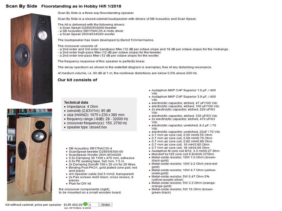

Setting a financial budget, deciding on new technogies like bi-amping the woofer + TM, and understanding the limits of your woodshop can help your build decisions.
There are a few 12" woofers like the $172 SB_Acoustics SB34NRX75-6 which produce deep 36Hz bass in a tight transient SEALED 3+cuft cabinet. The 12" can be mounted on a wide side panel, and the cabinet can be tall to get 3+ cuft volume. Example attached. Narrow front baffle with Avalon-style truncated pyramid baffle top, side wide enough for 12" woofer, height with tweeter mounted ~39" high. A tweeter-midrange stepped baffle for time alignment is a second alternative to Avalon bevels.
SB26ADC-4 $50.20 Aluminum Dome Tweeter
SB17NAC35-4 $70.45 sealed 6" midrange
SB34NRX75-6 $172 sealed 12" woofer
......................... $293
I chose (almost) these exact drivers for my active 3 way project which I completed in April. I used the SB17CAC and SB26CDC versions (aluminum with aluminum-oxide ceramic layer)... Within the SB lineup of drivers, the aluminum and the ceramic drivers are so close to each other they are almost interchangeable.
I found the SB34NRX75-6 to be an outstanding driver. I have a very large listening room, 22 ft x 32 ft, with a ceiling that slopes upward from 8 ft to 19 ft high. The room is open to the rest of the house, so all the other rooms act as bass traps (for better or worse). I found a pair of SB34NRX75-6 in 3 cubic foot boxes are more than enough.
