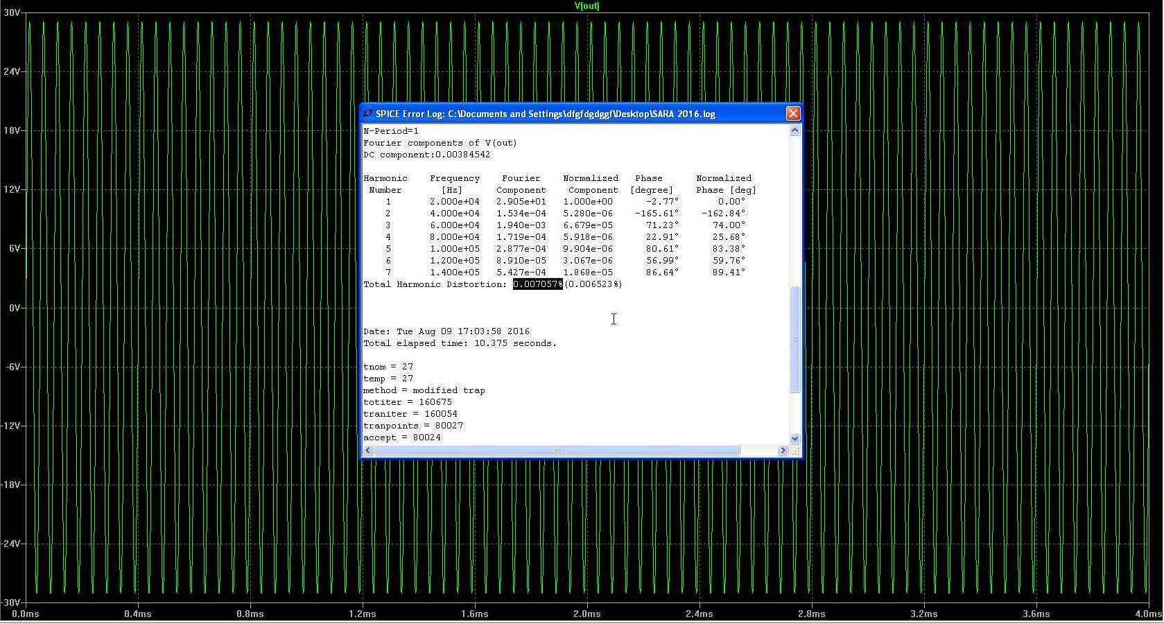

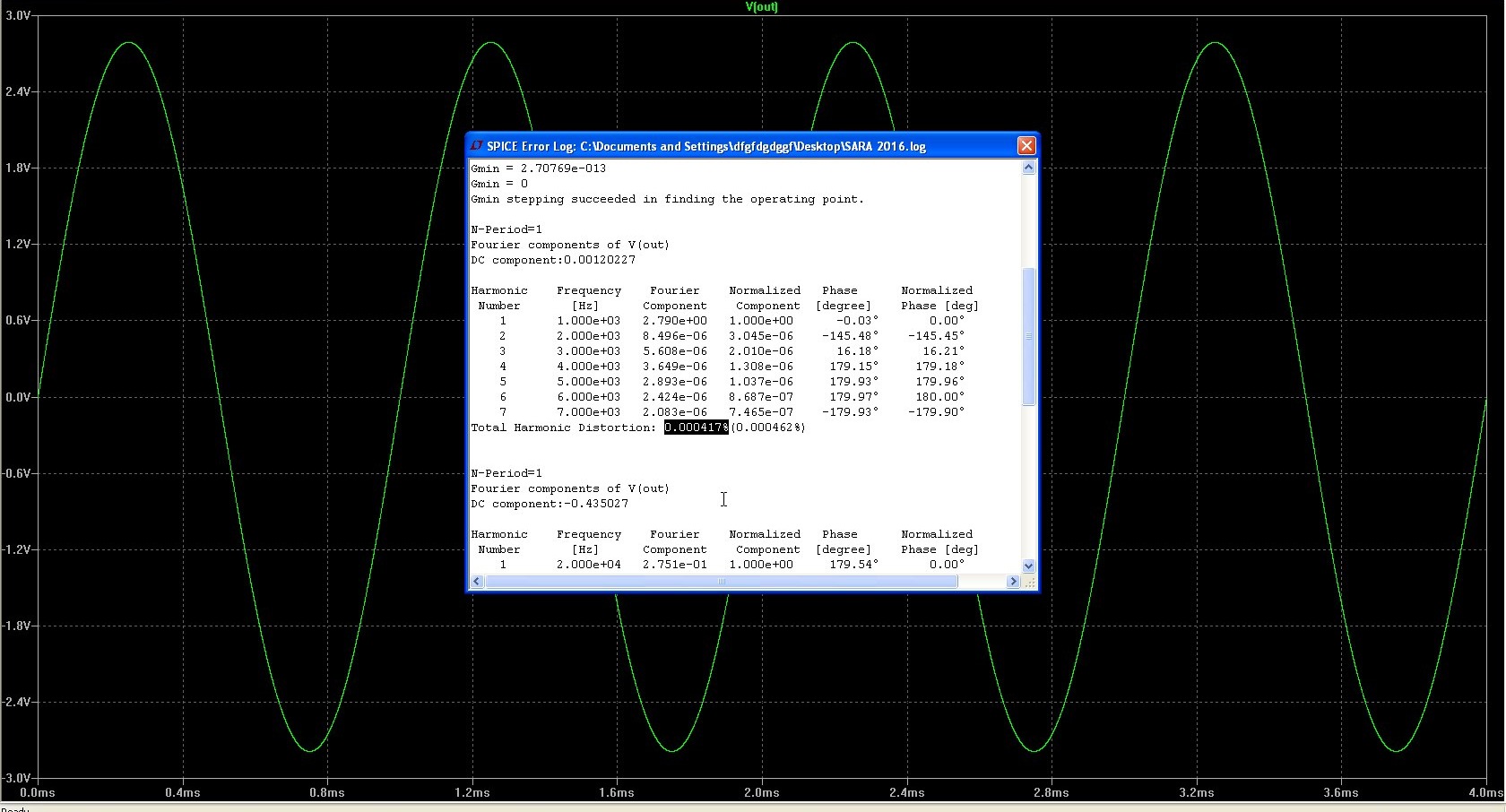

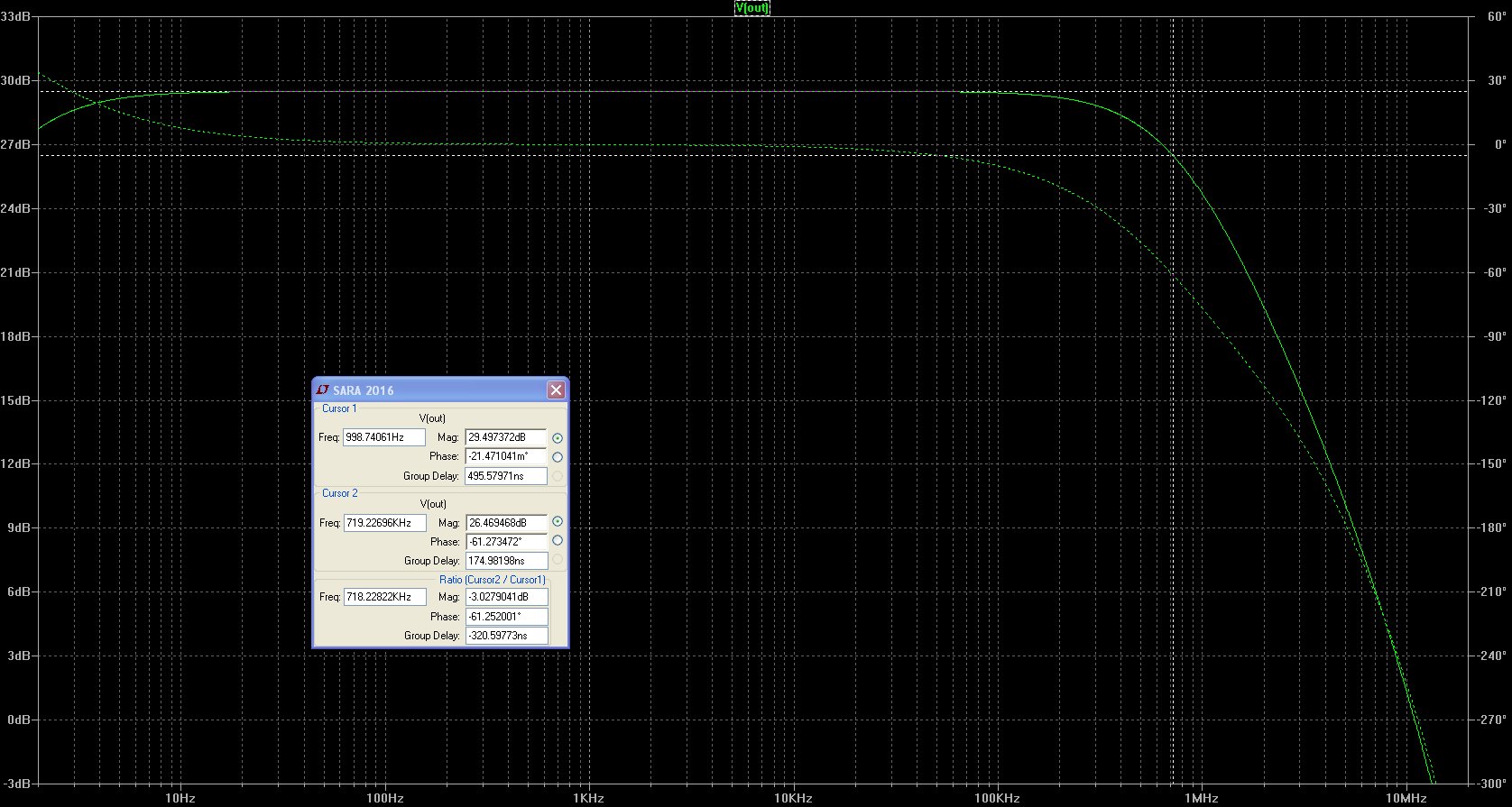

SARA-2016

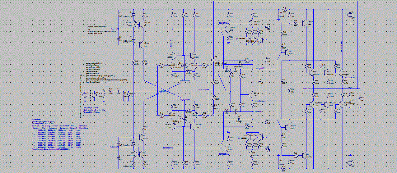

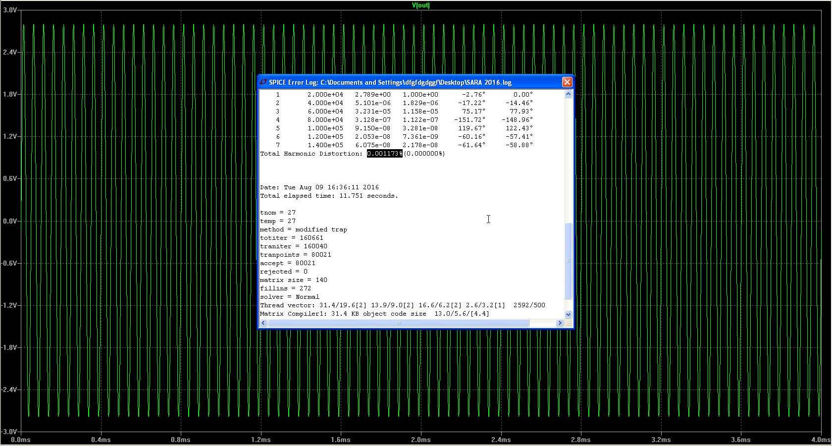

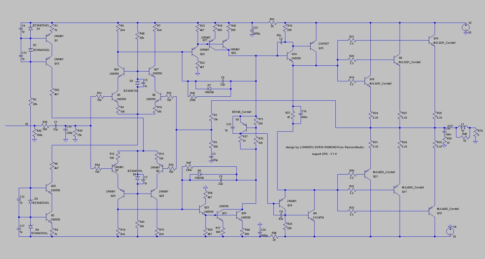

A simple scheme and pretty

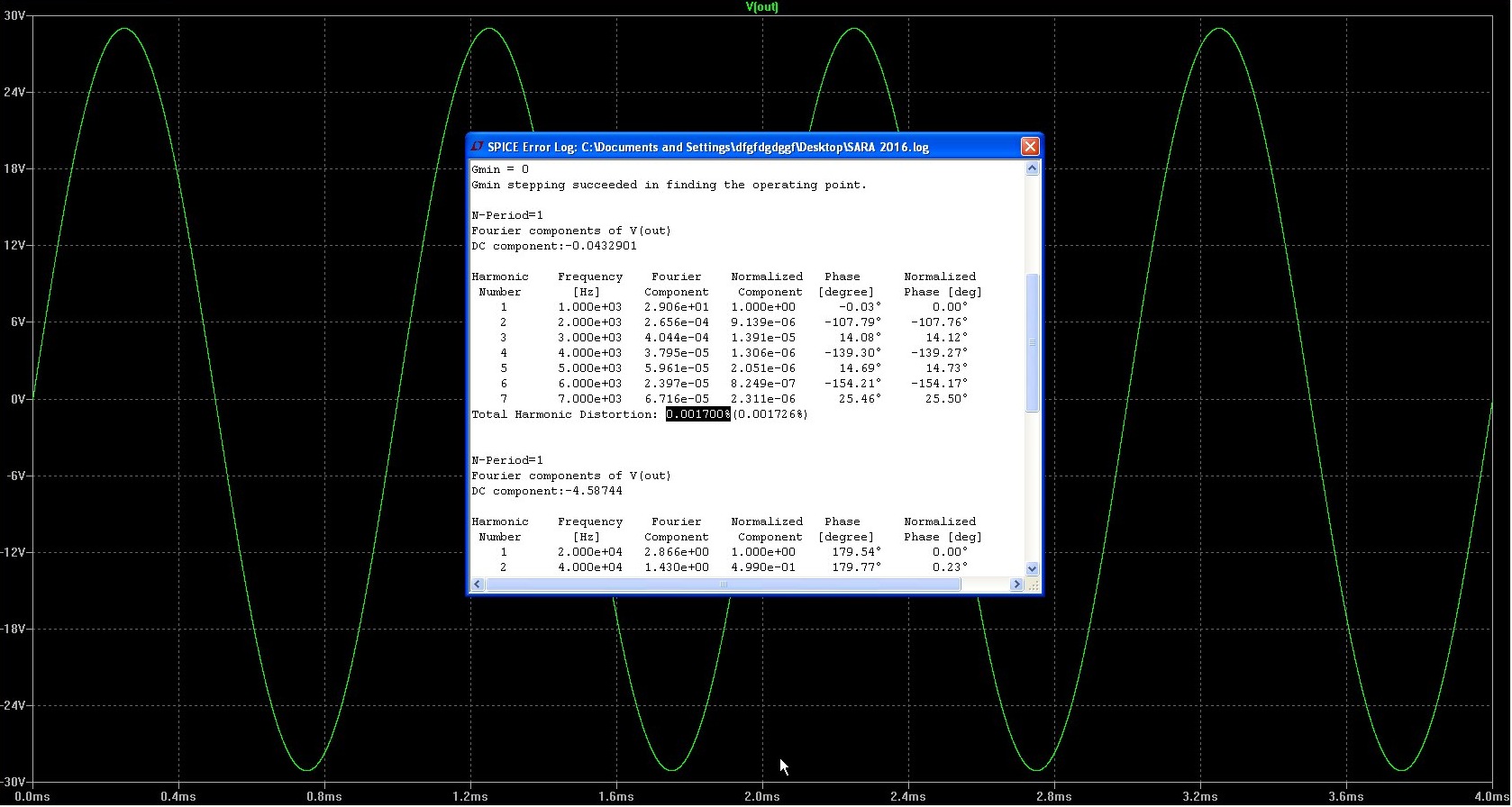

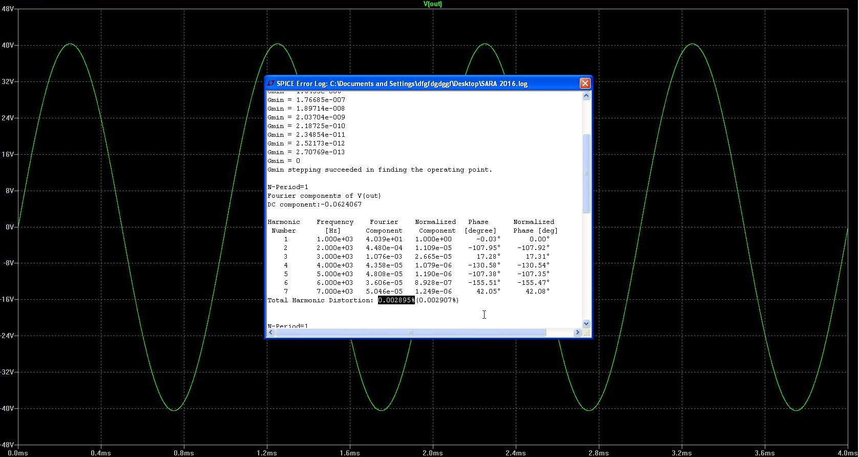

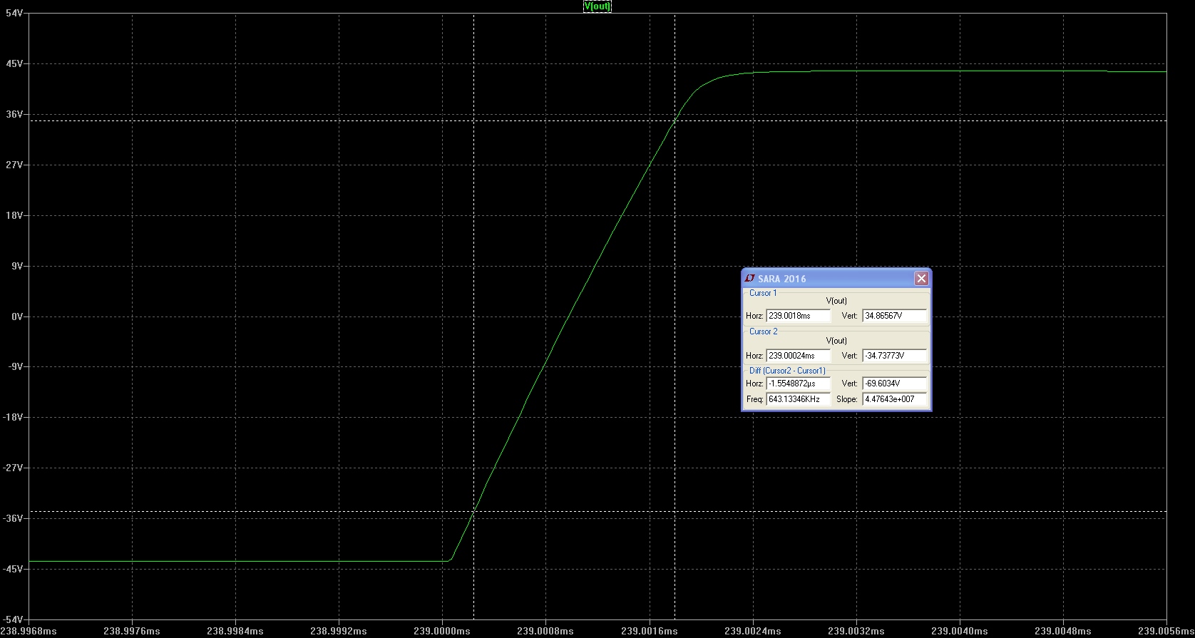

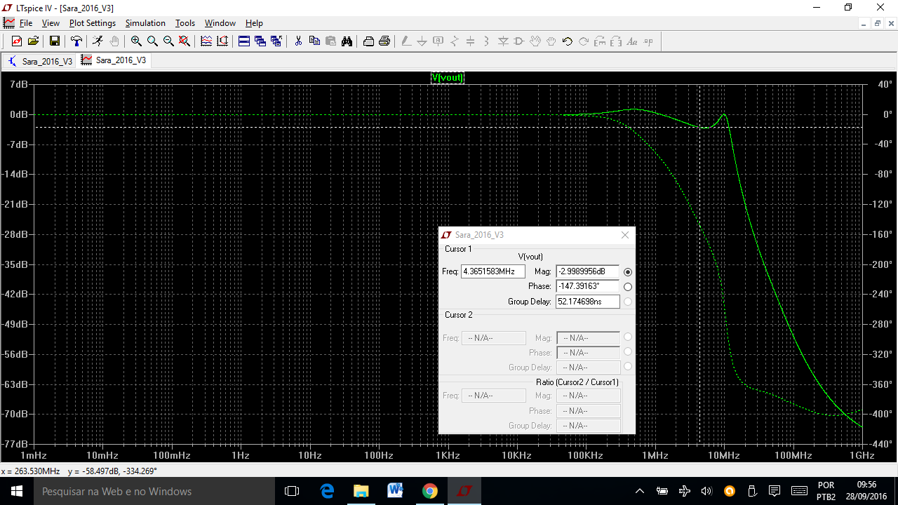

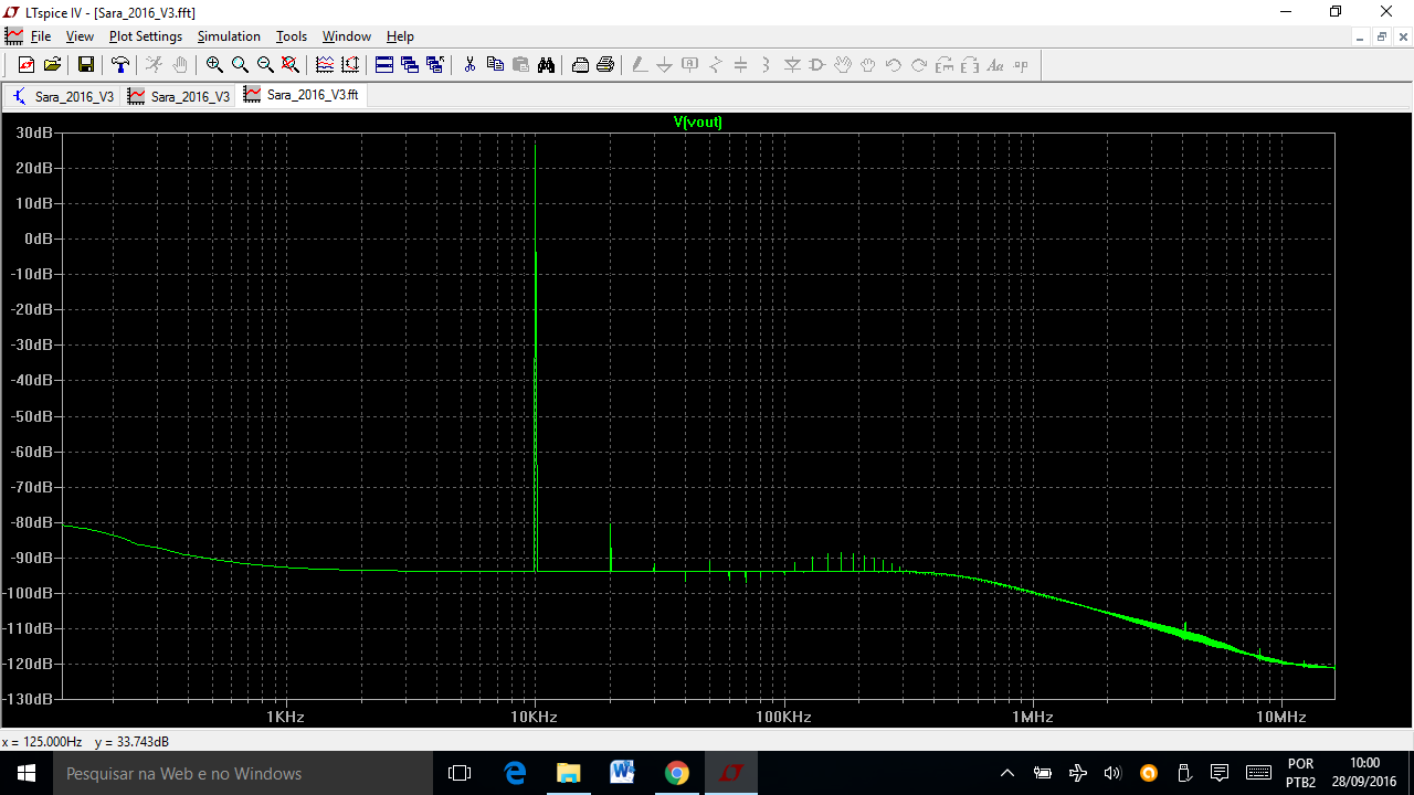

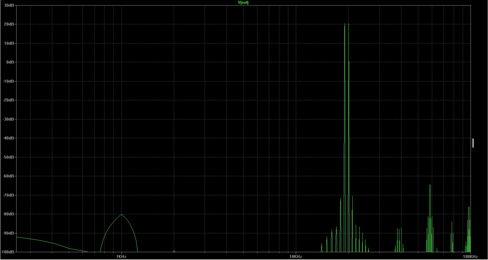

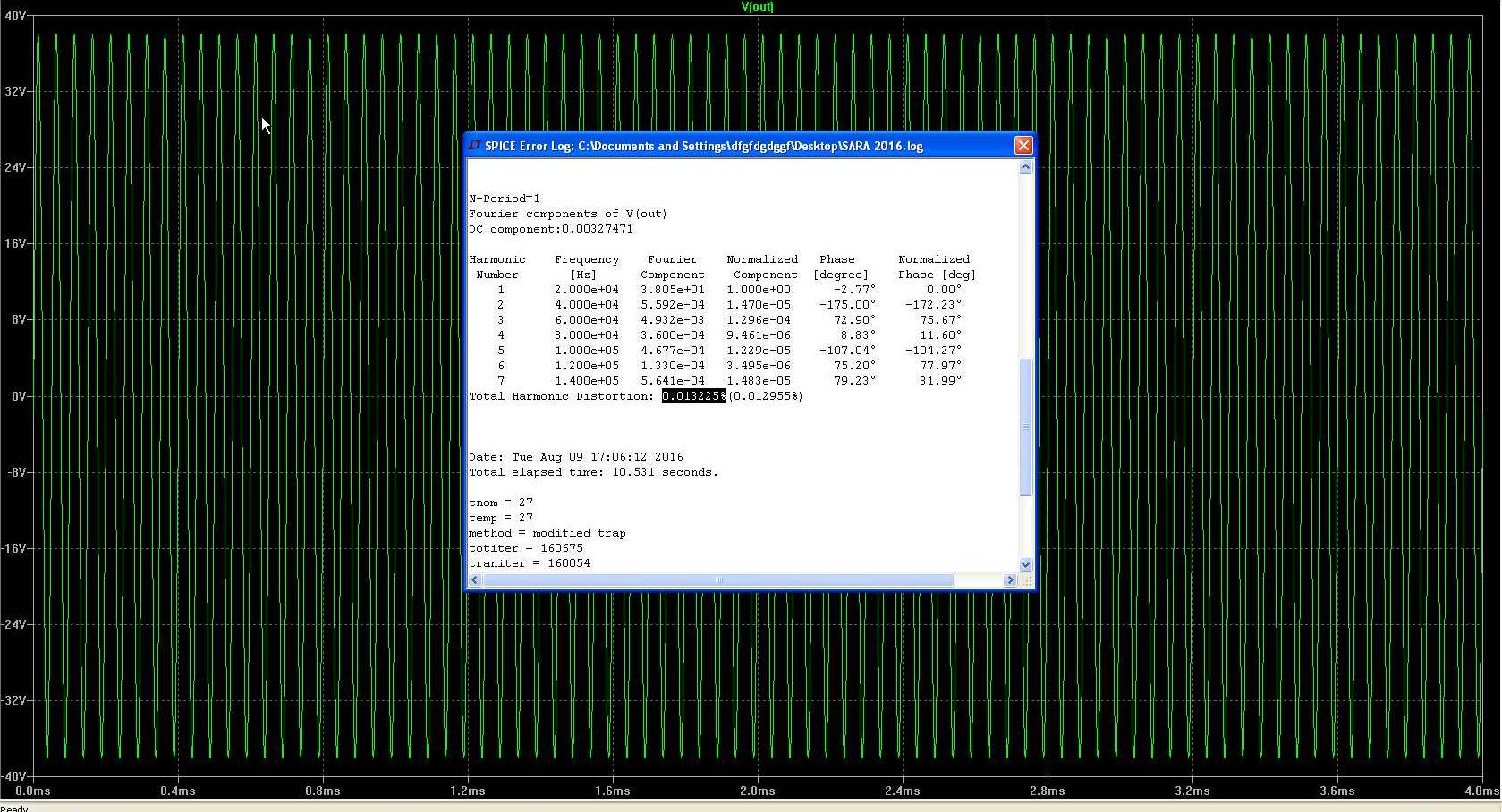

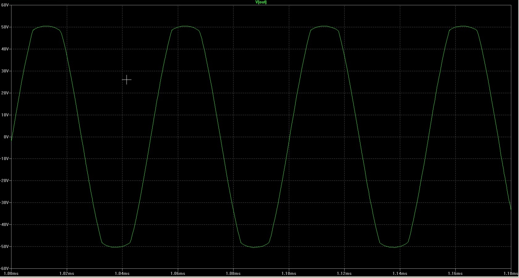

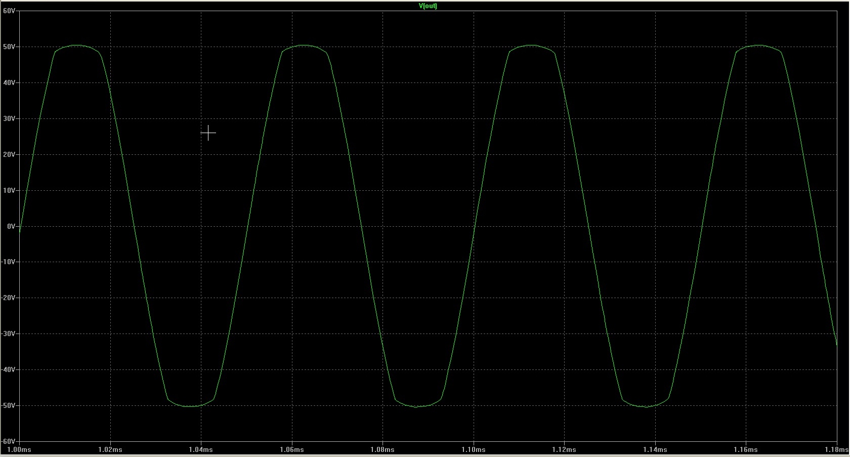

Hi Greierasul
Looks to be a very interesting project.
Why you do not use MJL4281A as ON Semi apoint as complementary to MJL4302 in datasheet of mjl4302?
Did you have any offset issue in simulation?(I forgot my english class...)
Regards
Ronaldo

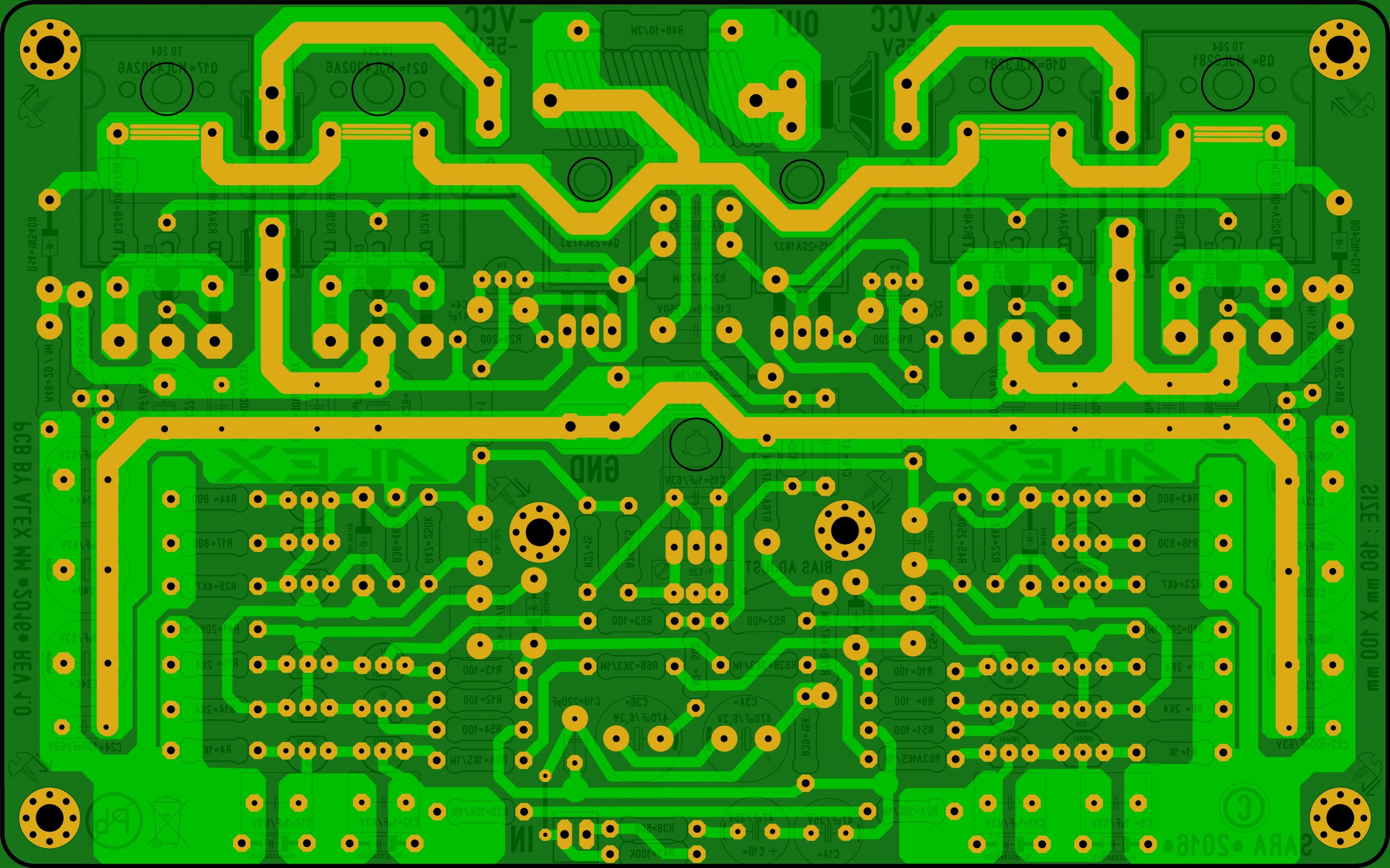

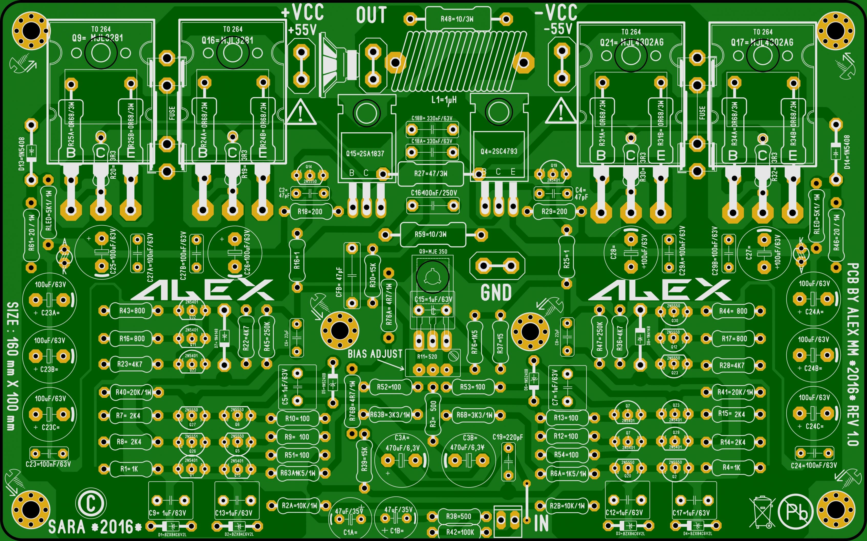

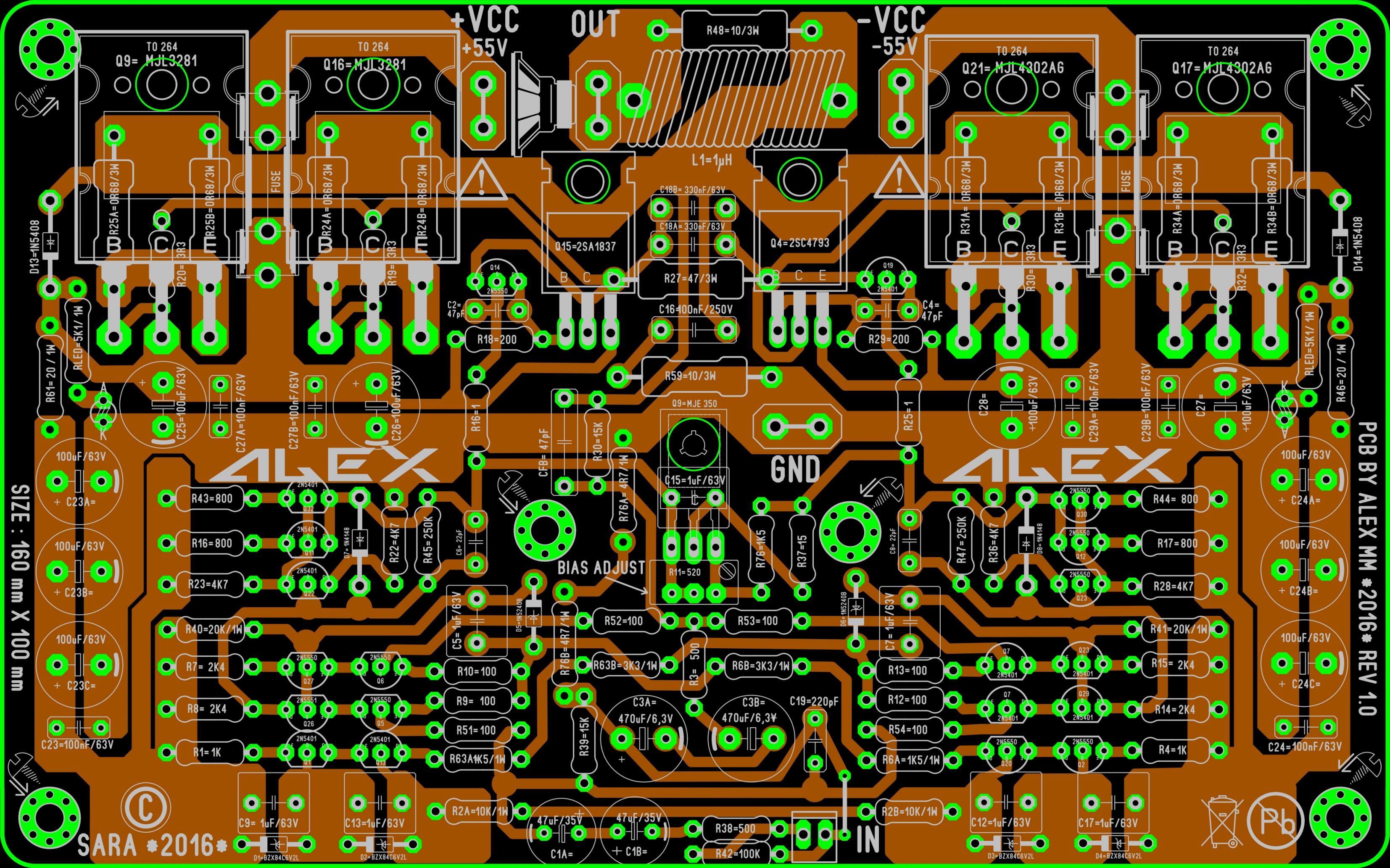

I ask my self ,if someone it's interested to build this amplifier .... and a decent PCB it's was layout by me in this case .🙂 I will prepare B&W pdf.documents 😉
Best regards,Alex

Hello Alex
There in quite some time I watched your SARA amplifier on youtube and other PCB design, and it's really a nice amplifier.
The necessary files to its realization or pcb available are welcome.
PS: I have your PCB for the USSA-5 by Fab, congratulations for drawing!
Regard's

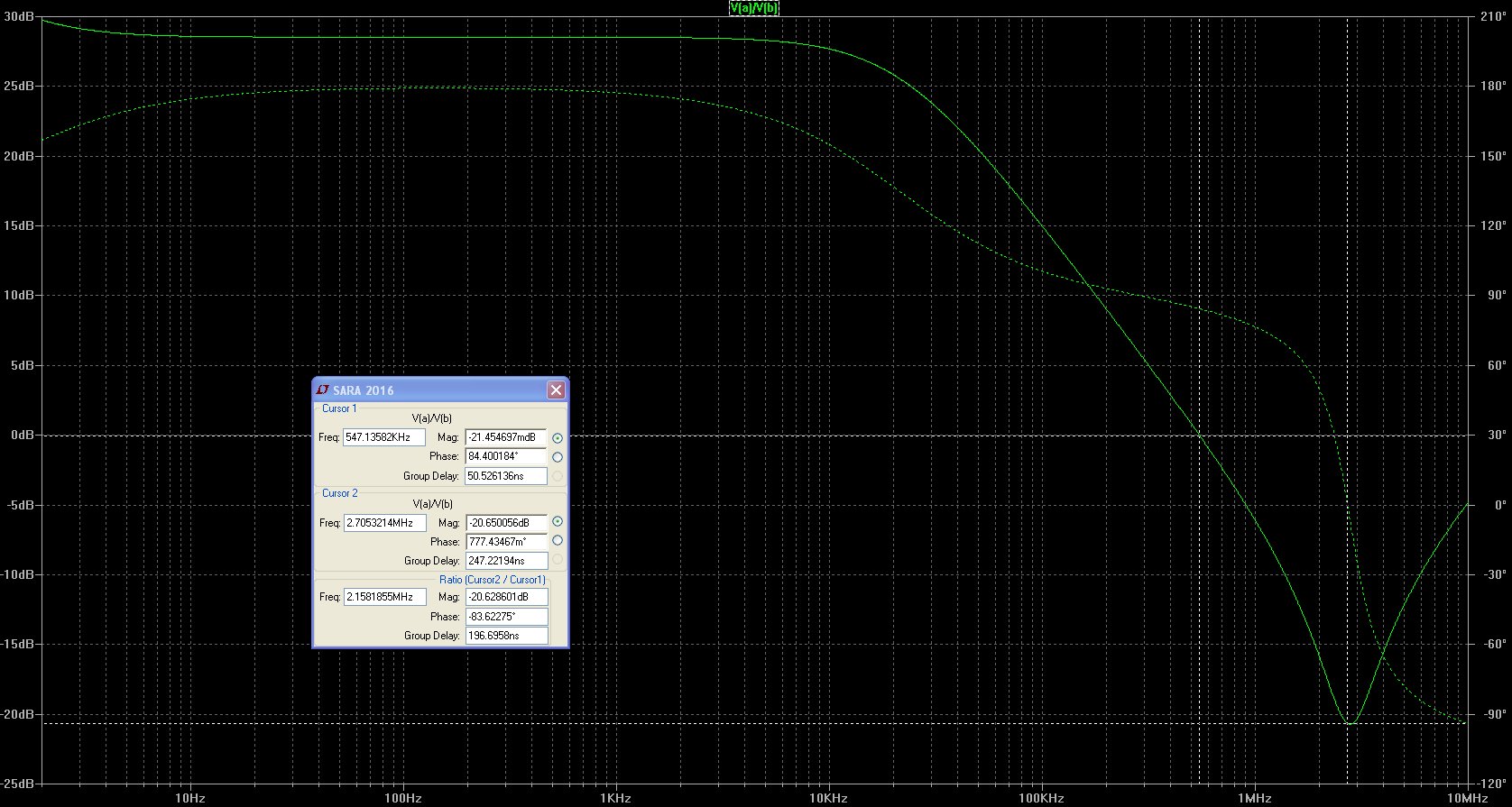

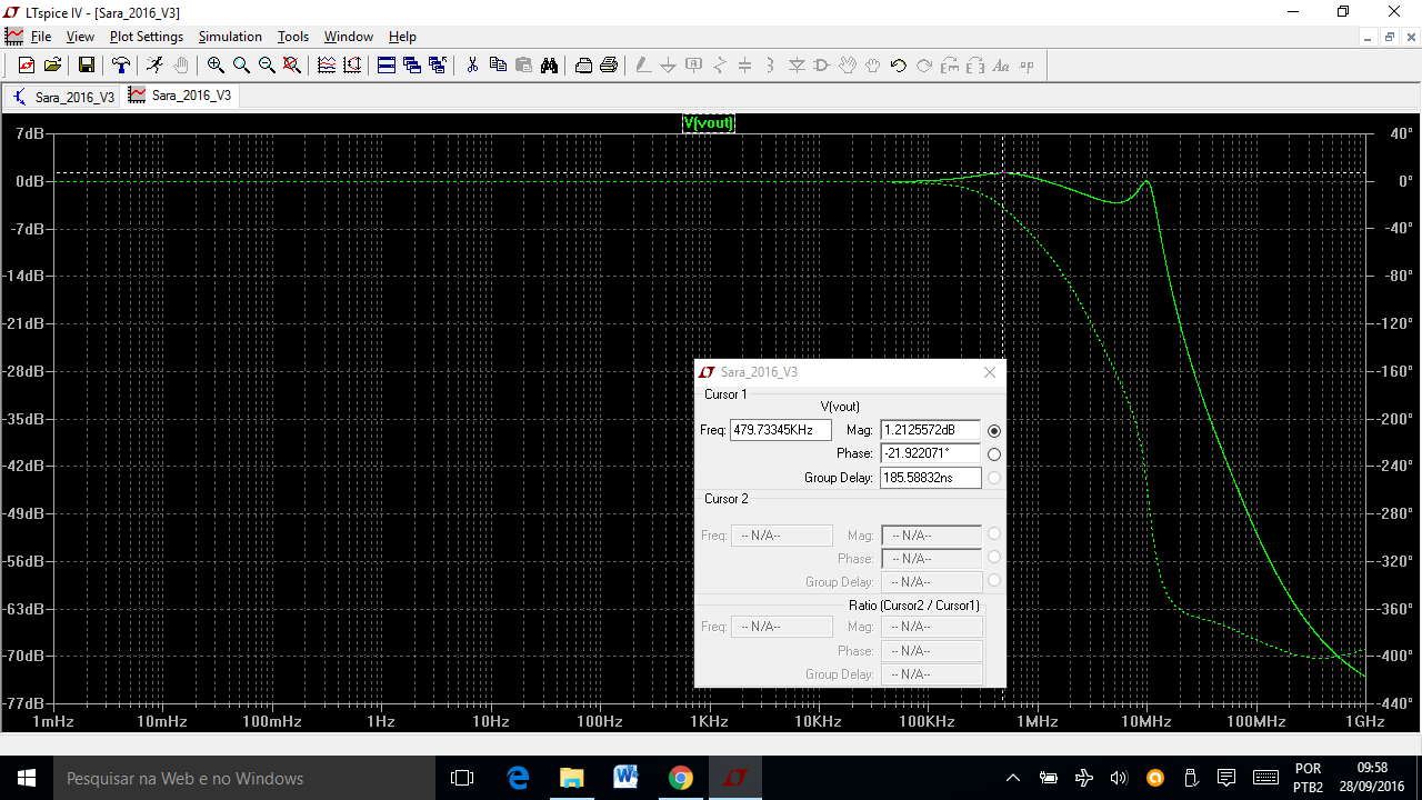

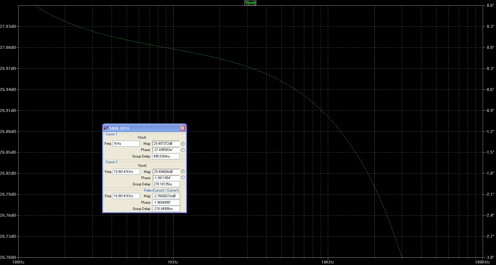

My personal version of SARA
After some simulations and other personal changes I get this result.
I followed the basic topology and component selection.
Please have a look and comment
