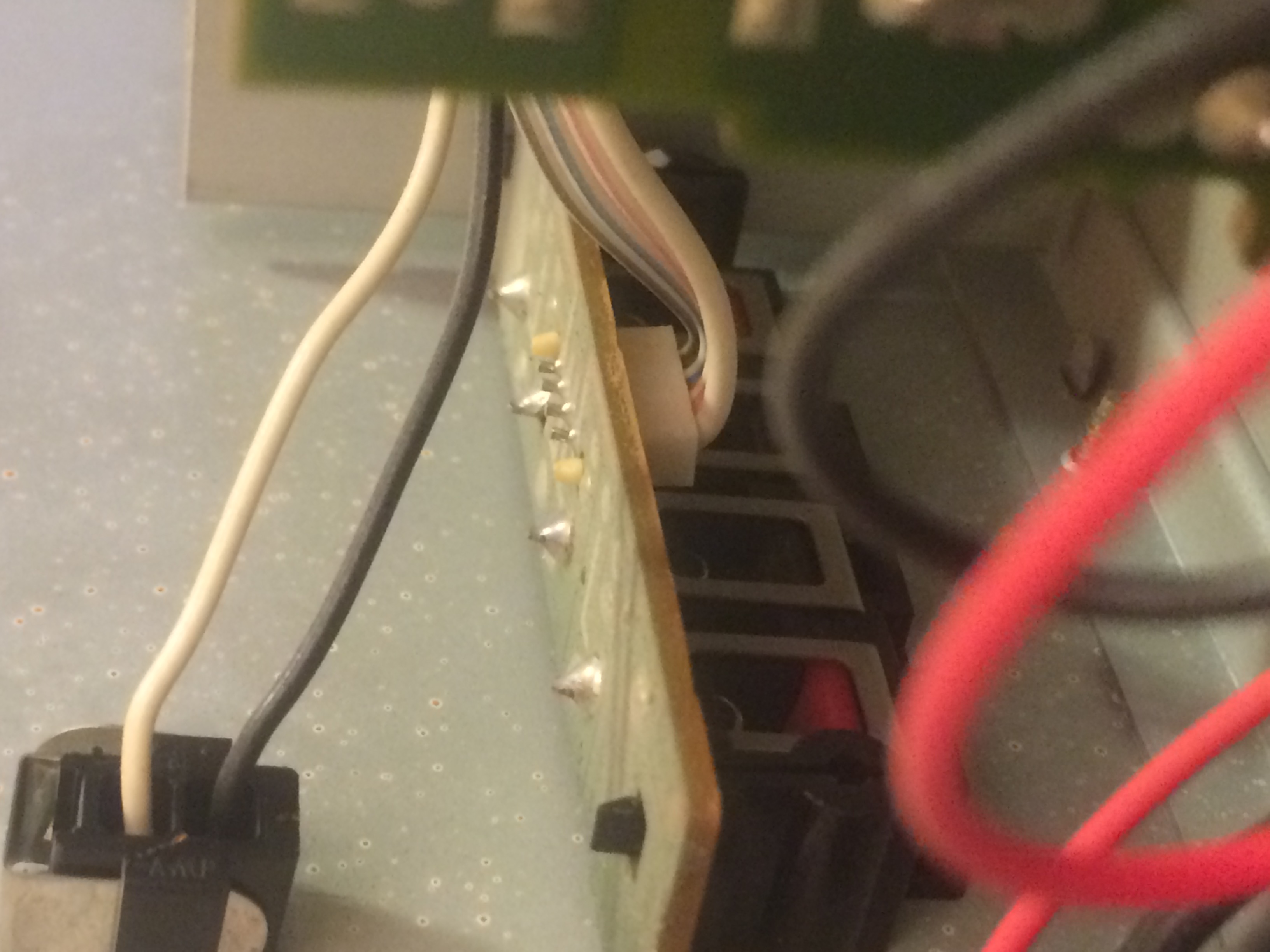

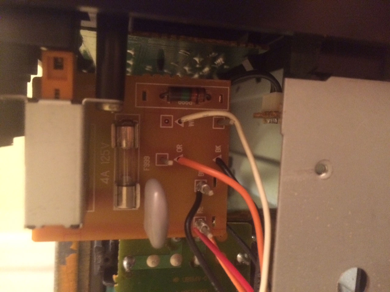

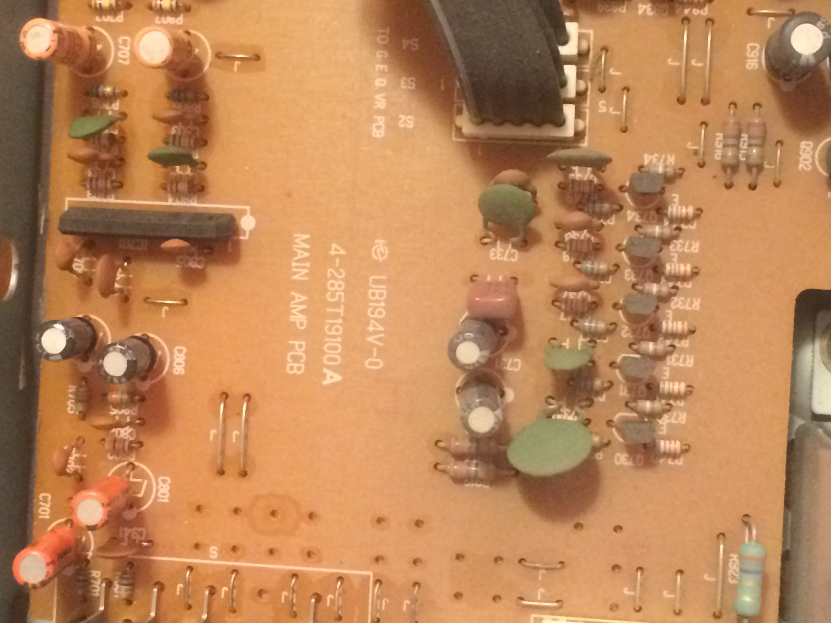

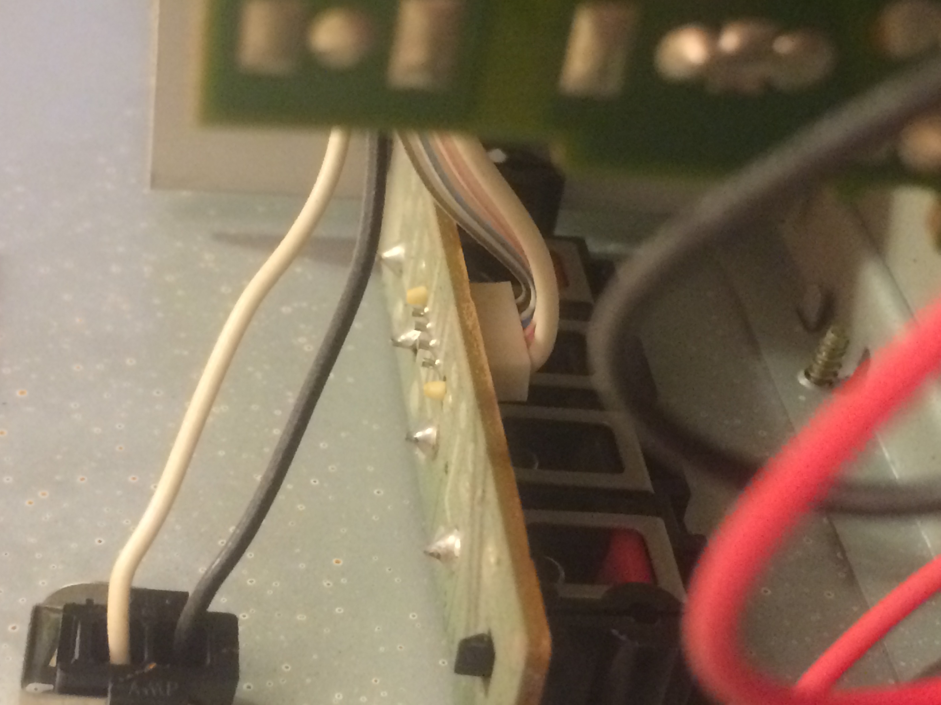

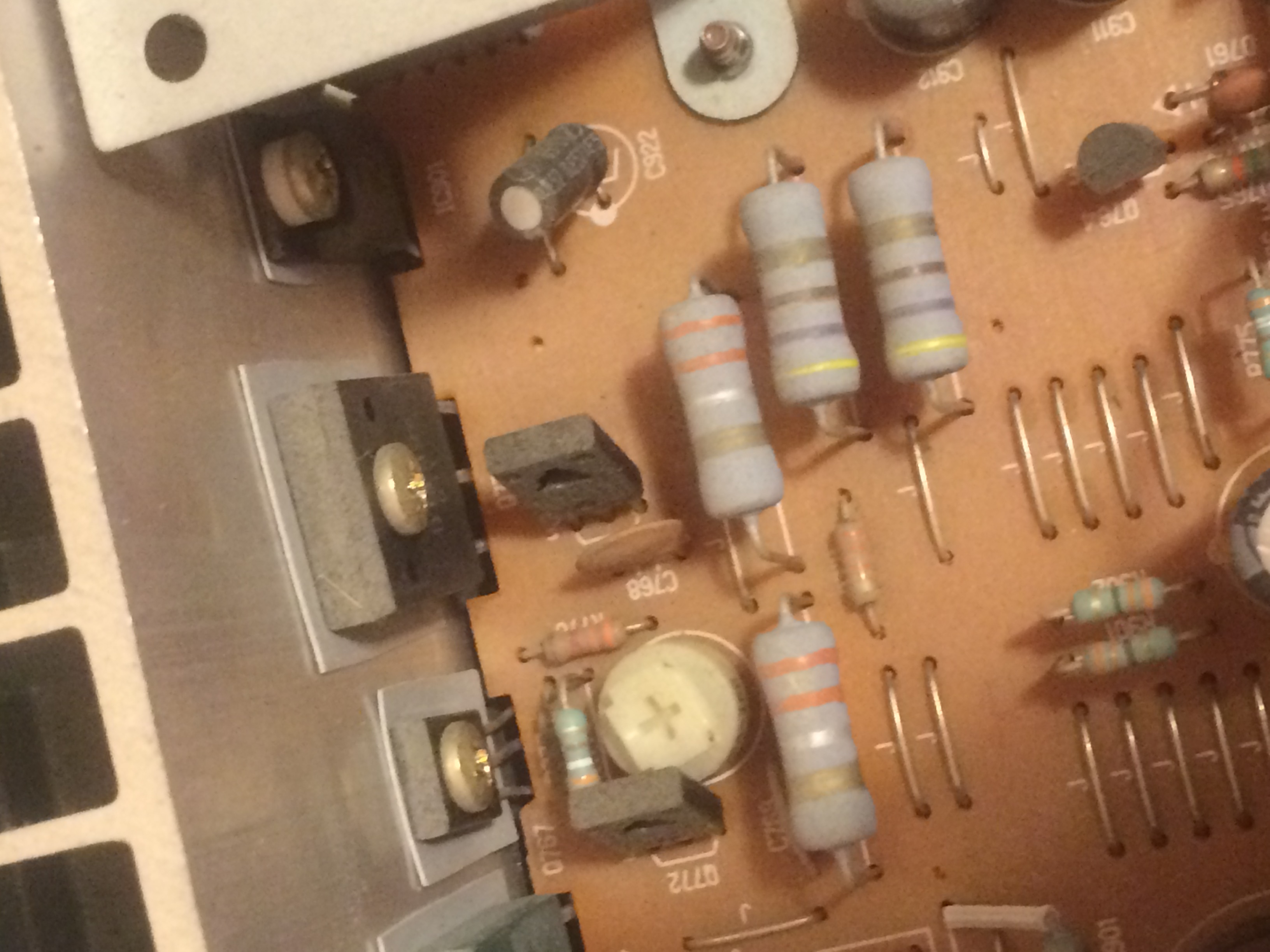

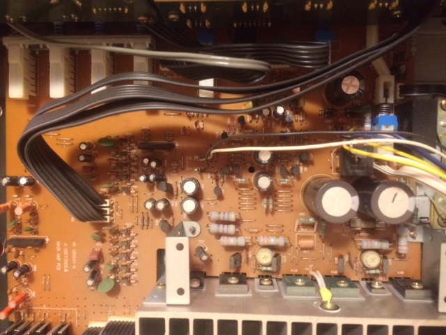

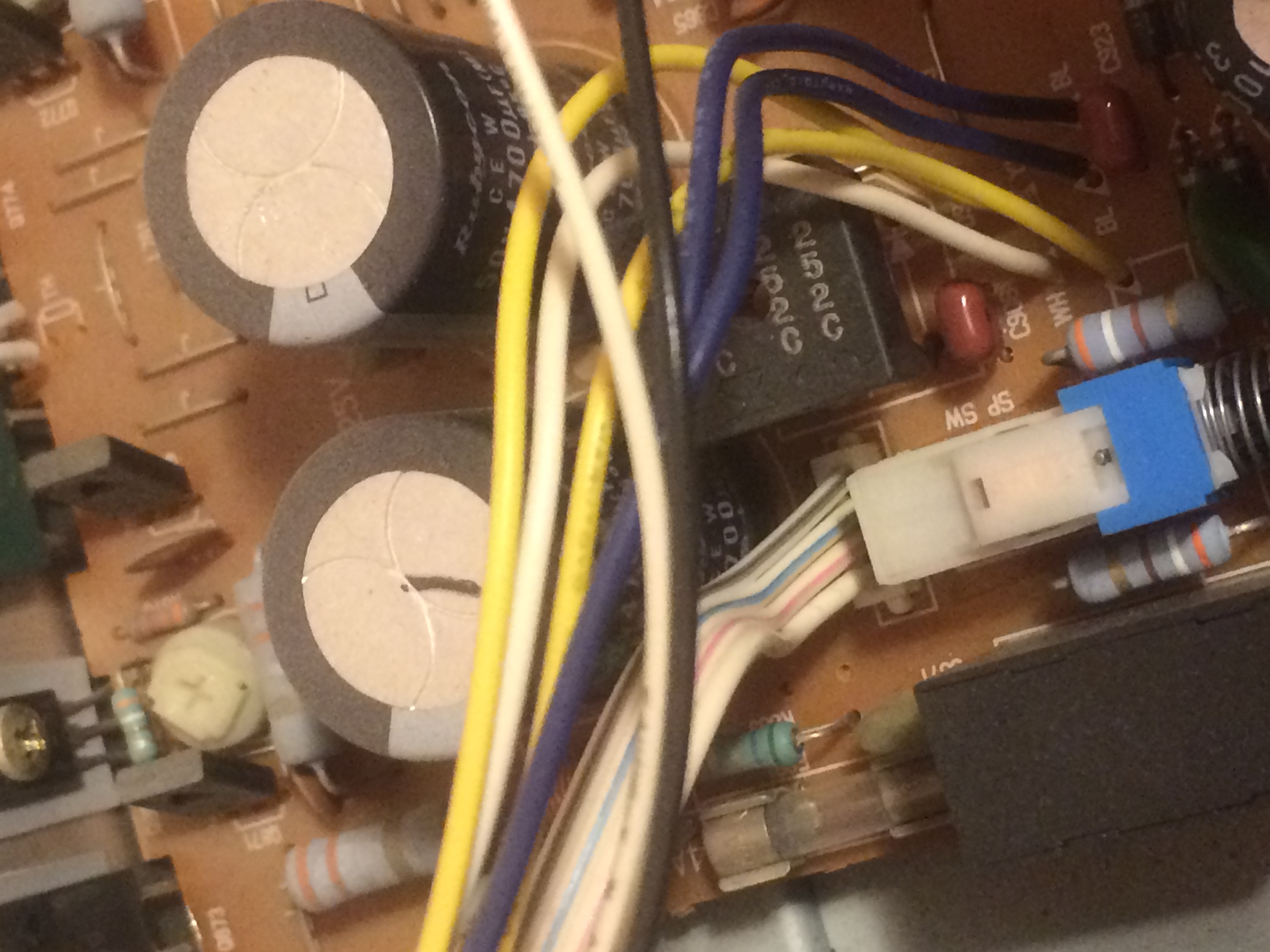

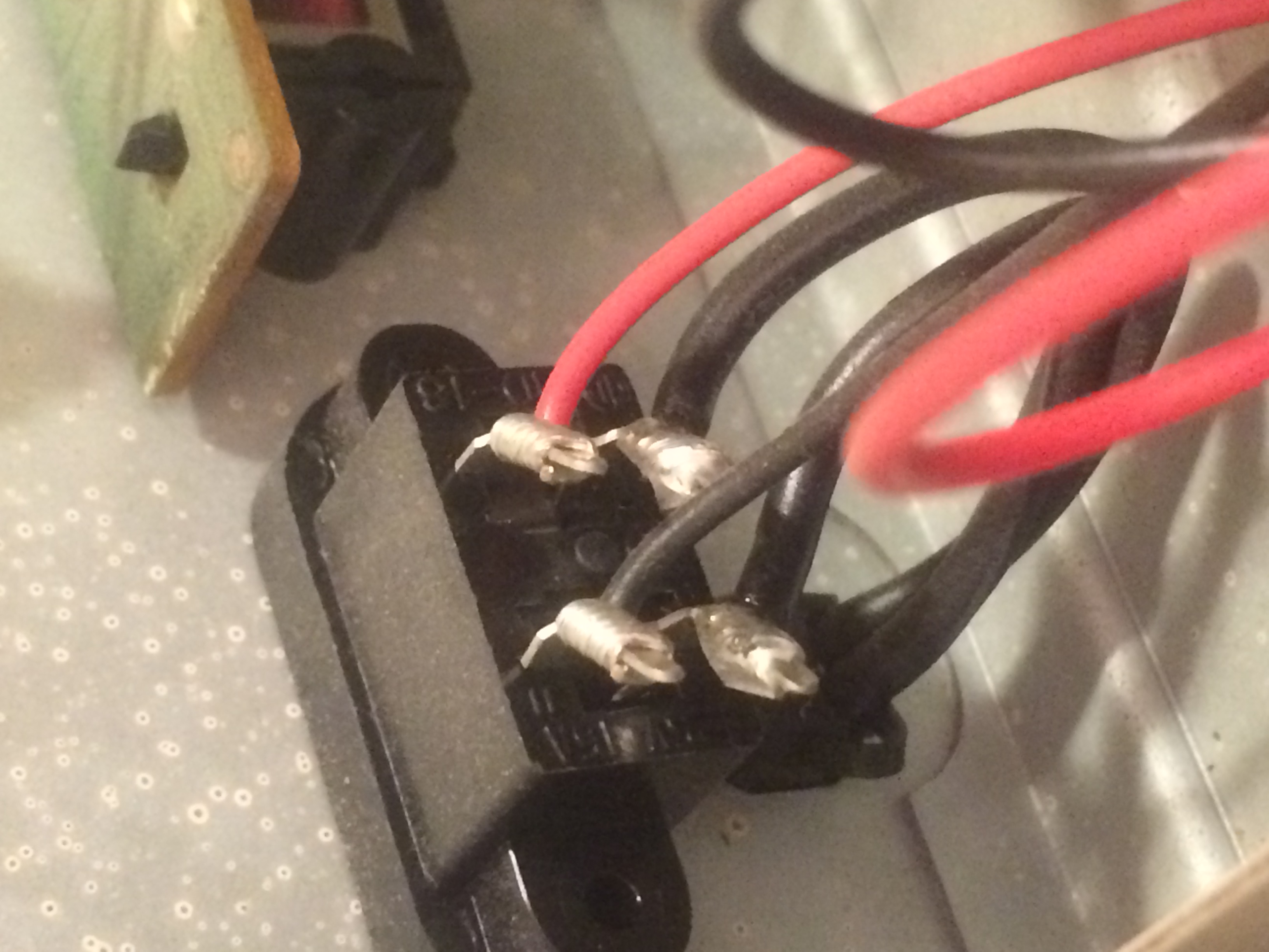

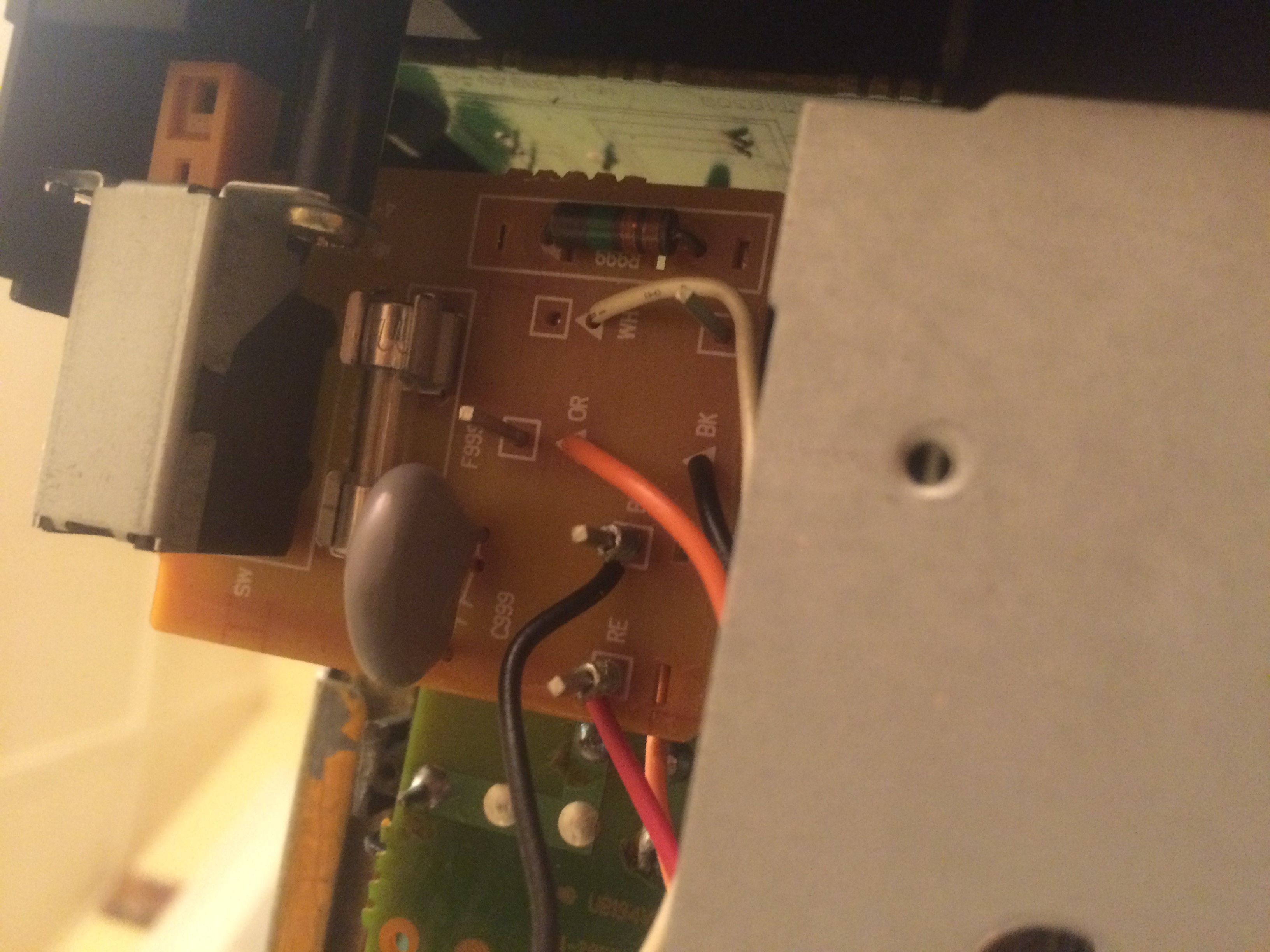

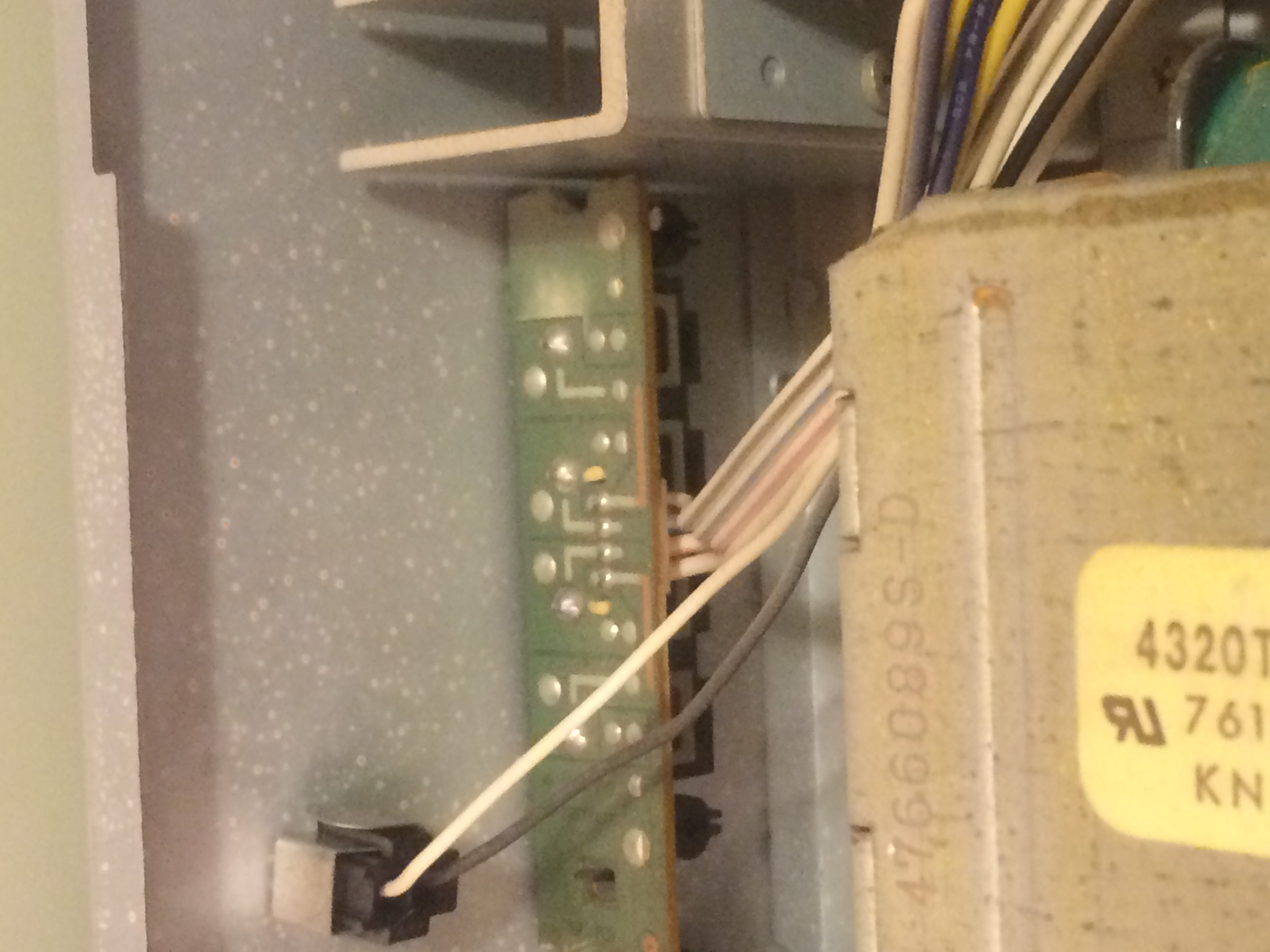

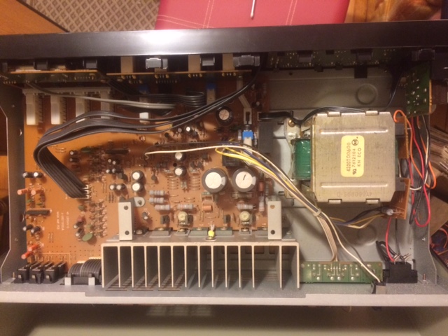

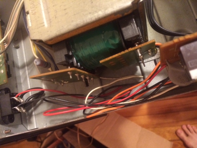

There seems to be little info freely available on these models. I would suggest posting some good pictures of the internals of the amp, good close ups of the pc boards top and bottom. Many fellows around here can tell a lot just from pics.
ok here are a bunch of pictures if you anyone needs a more specific picture to help me just let me know!!! thanks!!!
Before getting your hopes up, do you have a Digital Multimeter to run some basic DC health checks on the amplifier? If you hope to do repairs without the right tools you won't get far unless its a dumb error or a mechanical contact issue.
An initial question - when you turn it on, there should be a short delay and a relay kicks in, joining the amplifiers to the speaker terminals. If you hear sound in at least 1 channel then this must be happening, as I assume that's a relay at the end of that bundle of wires from the speaker terminals back to the centre of the amp. When you switch on, is there a click and even the faintest sound in the quiet channel?
