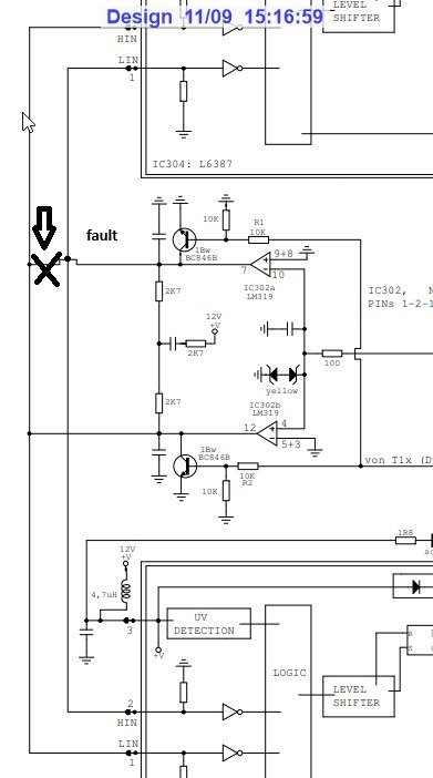

Sanyo/B&O Icepower 200AC Rev.D, schematic about rev. engin., not complete finished

I have a failed Icepower 200ASC ver. M from a B&W ASW608 subwoofer.
The yellow LED (protection) lights up when the voltage on the speaker or 4 Ohm load exceeds 4Vrms, so only 4-5W are output instead of "200W". After a few seconds, the protection switches off, but will reappear if the output voltage exceeds ~4Vrms.
Any ideas?
