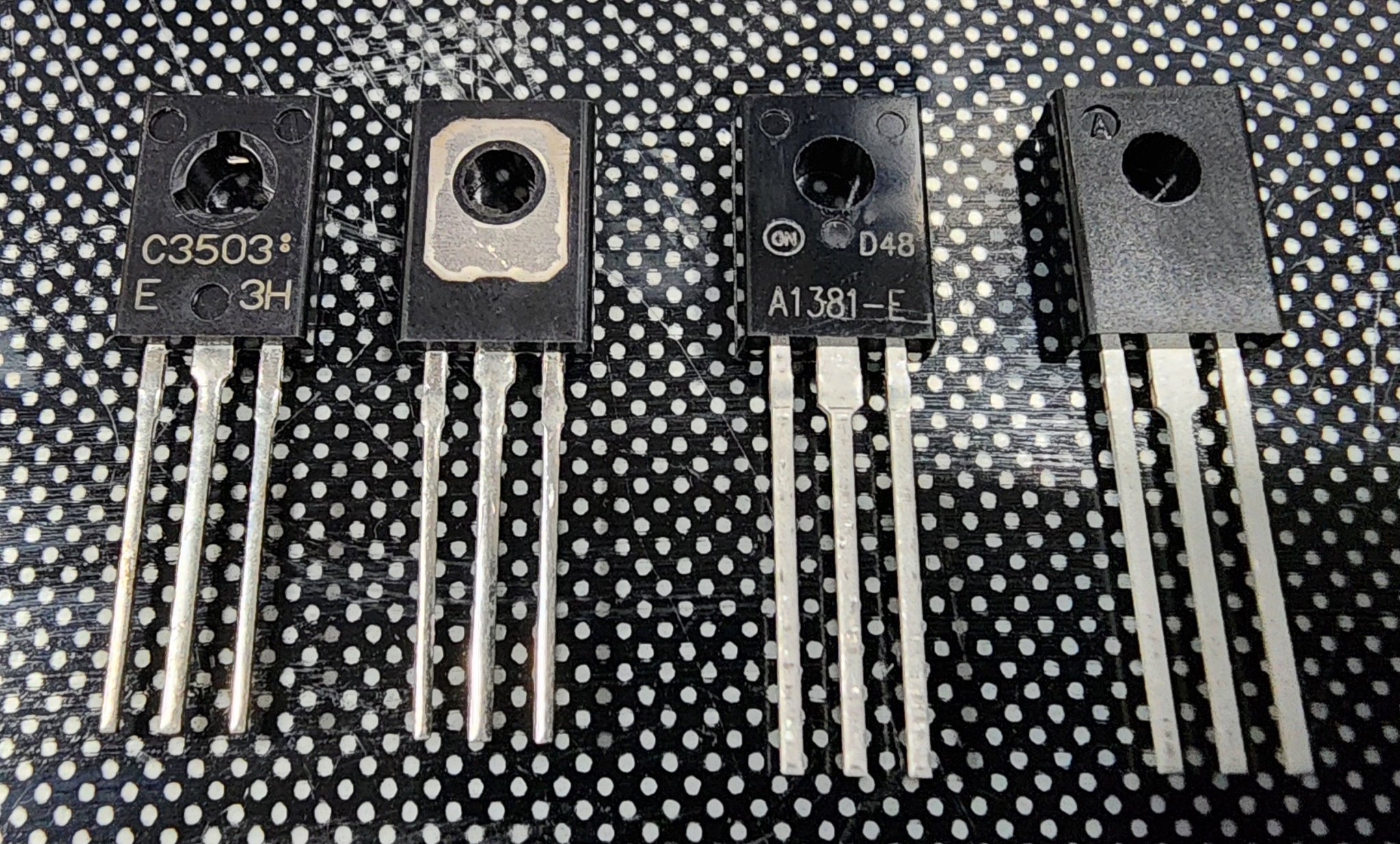

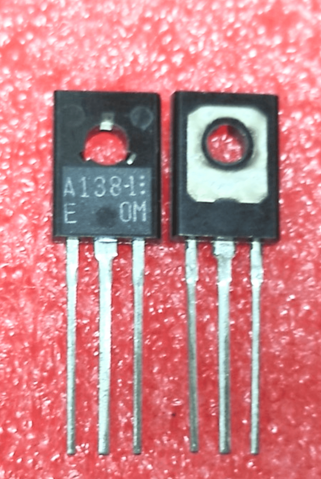

Out of curiosity, can you please post a couple of pictures?I have had good luck with Ebay seller ceitron. They have some listed. Item # 292292728038

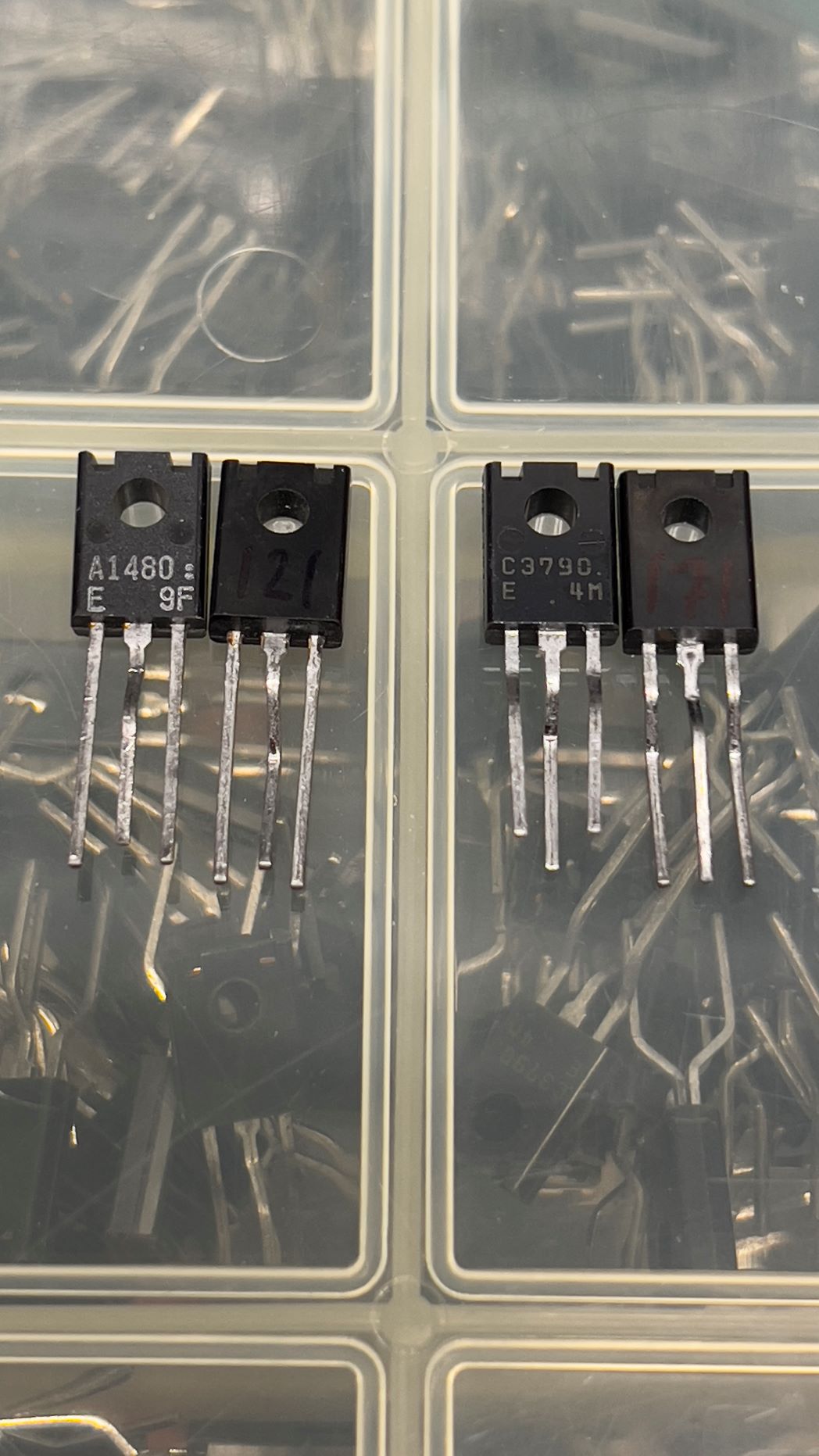

- 2SA1480 - 2SC3790

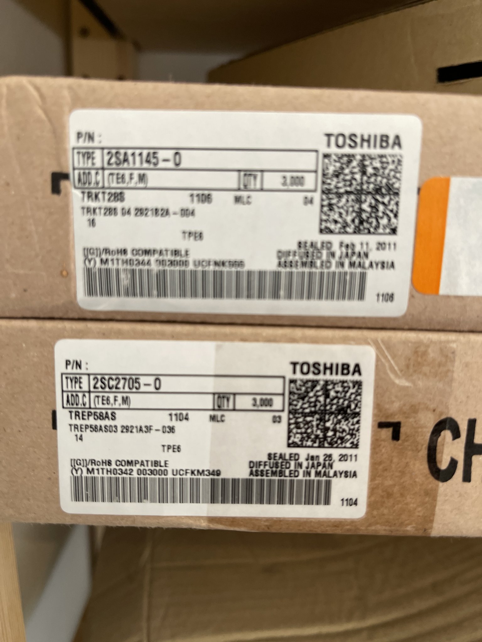

You can also use 2SA1145/2SC2705

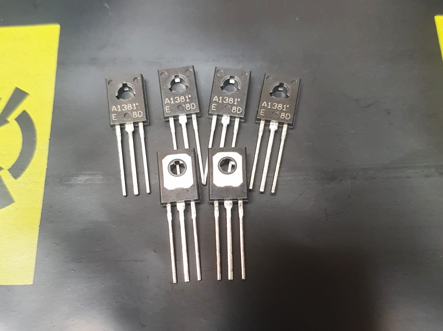

I dared to buy from this seller on Aliexpress to see if they are like the originals I had in stock from Japan.
These are 100% original, low COB, good HFE and breakdown voltage verified.
I bought another 50 pairs and all are exactly within datasheet specifications.
