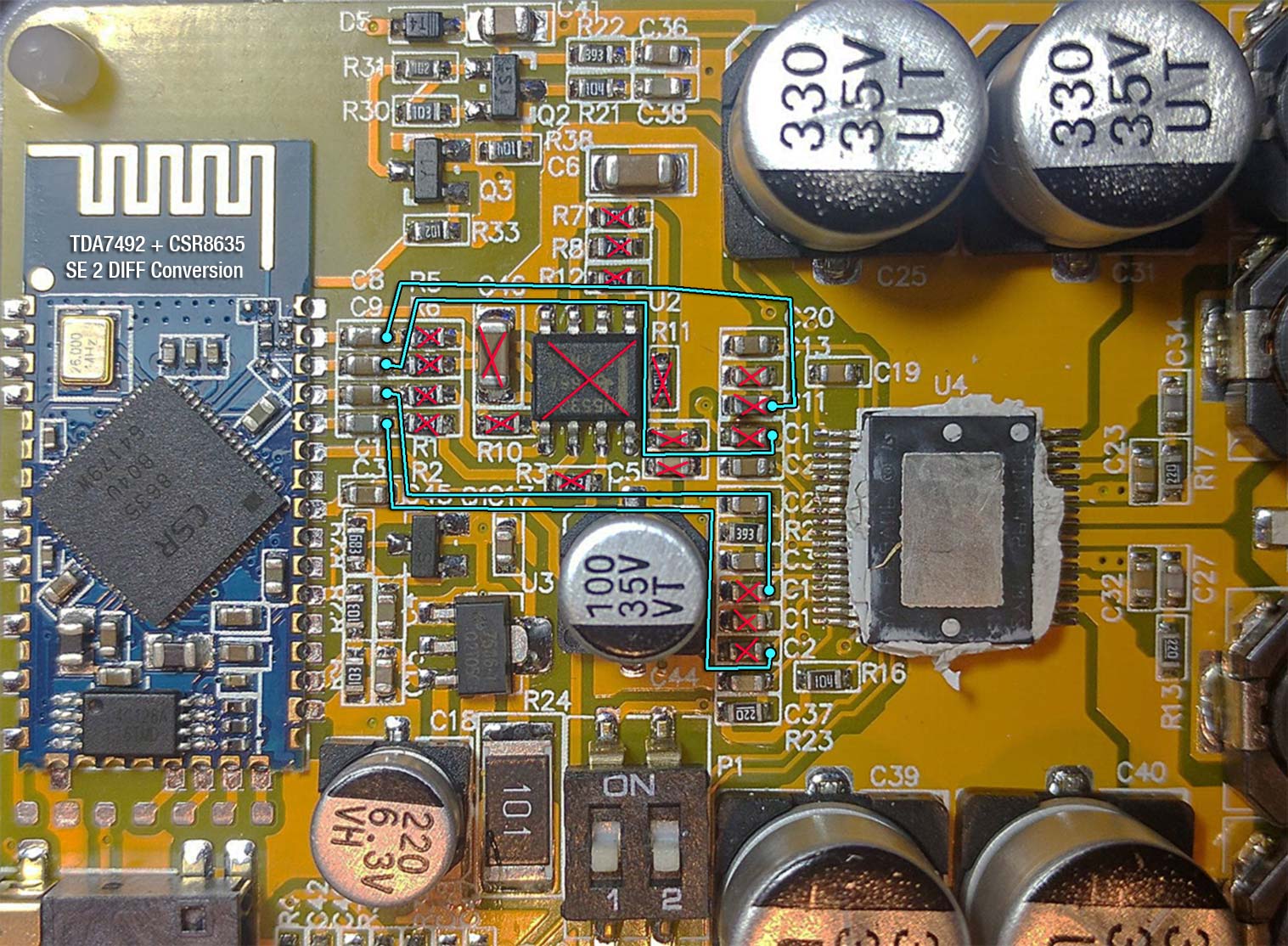

I did it, and it works! Noise is no more present!
But i have a feeling that speakers are quieter now, volume is lower i think... Is this normal? 🙁

Yes, i tried it now. It is louder, but lower quality. If i get step up converter, i think it will be better.... or no?

Haha, yes indeed. C6 can also be omitted, forget to mark. Keep the wires close together for best performance. (Per channel)
I will remove it too. But does it really matter? It looks like its not connected to anything right now.

After few minutes of playing, there is strong popping, distortions, and speakers not playing properly. What can be the problem? I tested with different power sources.

Thats interesting, i removed heatsink. But chip is not hot, it is almost as cold as idle...

No no,you didnt understand me. I have removed heatsink before... When modding.
I havent put it back again, because chip is cold when working.
I will try to put it back on again, but i dont think it is needed. I used it for 3 hours without heatsink before modding,and it worked normally

Very loud popping, sound skipping - stopping, buzzing, distorting... I have to shut it down to stop it.
I dont know what happened. I will try to remove wires and resolder them tomorrow.
I hope its not broken, i cant wait another month for new amp to arrive...

Good news. I resoldered wires, removed one resistor that i missed last time, reattached heatsink... And everything works well for the last 1.5 hours... Hope it will stay like that 🙂

Not sure if this is related or useful, but I took delivery of a KKMoon rev2.0 board.
TDA7492 w/CSR8635 Bluetooth and it had a terrible 'digital' noise/hiss when Bluetooth was connected but not playing/low volume.
Soldering a short piece of copper cable (2inch or so) to the Bluetooth antenna sorted it out and reduced the noise to almost imperceptible levels. (best result was found by attaching the wire to the antenna at the nearest point to the edge of the board.
