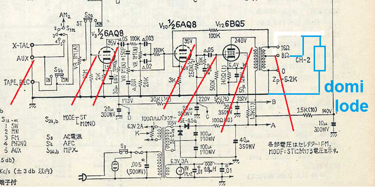

Do you have an oscilloscope?

niznai :......did briefly scope the signal when I was testing with a 1kHz sinewave from my generator and I found the sound level after the transformer was lower than that out of the output tube plate, but that may be just the higher voltage present at the plate. Didn't actually measure it because the scope I used isn't calibrated. I did however try to turn it up to clipping
. does the channel with the most distortion have a ok output choke? Or is it the one with the problem?
- conect domi load to 8 ohm outpt terminal in L and R (8 ohm 7 watt sement resistor)
-Apply a 1 kHz sin signal with a 1v p-p... to the input aux L and R . of the faulty channel.
-connect the scope first to the domi load of at the output faulty channel
-. Turn up the volume until the signal starts to distort in output of faulty channel..
- What is the amplitude of the signal in output Before Completely distorted?
-Repeat this test on the ok channel. Here is what the amplitude of the signal before completey distorted ?
-scope shuld be in ac input and x10 probe.
-please take pictures of tow test on scope.
After completing this step, we can continue and the solve cause of the distortion. First, look for abnormal distortion scope.

Hi hooman, right now both transformers are good, so I don't think that is where the problem lies. I have done exactly what you described but as I said, the scope I used is not calibrated so not sure what the output voltage is. I will clean the pots and switches first and try to check as many resistors as I can and other things and then I will run the test again with a proper AC voltmeter to measure the output at clipping. I managed to change the input RCA connectors last night, so another job ticked off.
Well, cleaned the switchgear and pots and have run another listening session. After a little while on the dim bulb I found no reason not to go to full power.
On the dim bulb I found one of the output tubes was not lit up (or not much, can't tell very well, it has some sort of shielding above the cathode) and on checking I found it was weak, so I replaced it with another unknown tube saved from my stash of dead receivers but this one went very well. The distortion was gone.
