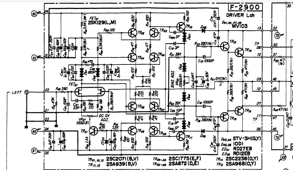

It might be worth pursuing the stability theory but I would have to see a full circuit to see if anything could be altered easily.

The New drivers are the same as running in the good channel. The only other new transistors are on the amp driver card (I guess these are pre drivers) TR2-5 (Orig 2sc1775) replaced with KSC1845 and TR6-9 (Orig 2sa872) replaced with KSA992.

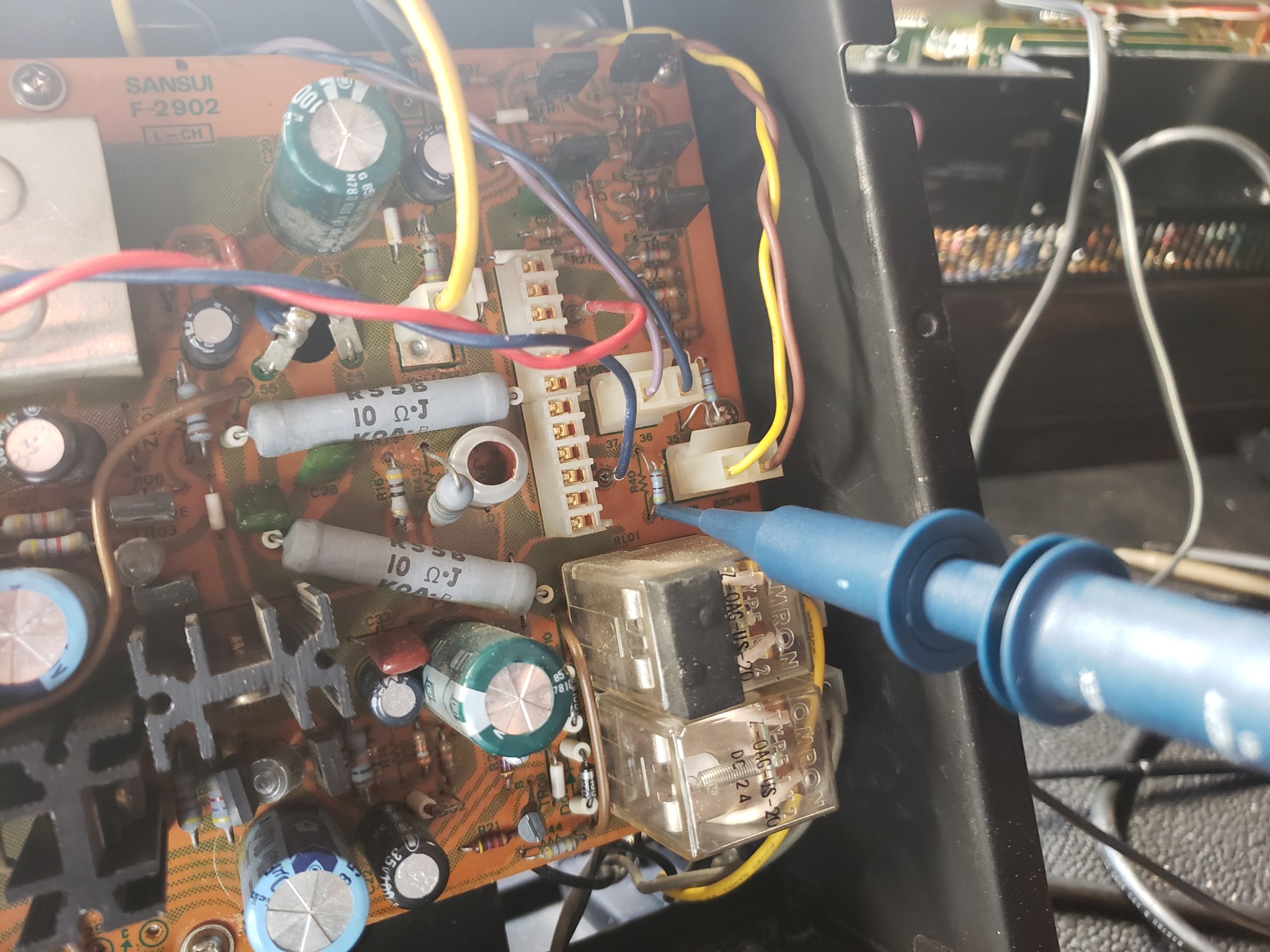

The 10 ohm resistors show 0V AC and DC (There was a few mV DC but I adjusted the offset to 0 and it is now 0). I had to pull one leg of the .047 uf caps to test but they test ok with infinite resistance and show the correct capacitance.
I do have an analog scope and did not see any ripple on either side of these resistors.

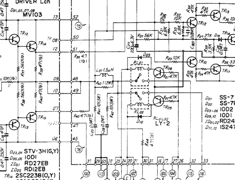

Thanks for the diagram.
That's exactly as it should be. Remember the B/E junction behaves a lot like a diode and so it should not be able to support a highish voltage across it. The voltage should limit out at perhaps 800mv if you were pushing lots and lots of current through it.
This is why I said the theory won't fail us. If you are seeing a volt or more over the B/E junction then something isn't how it seems.

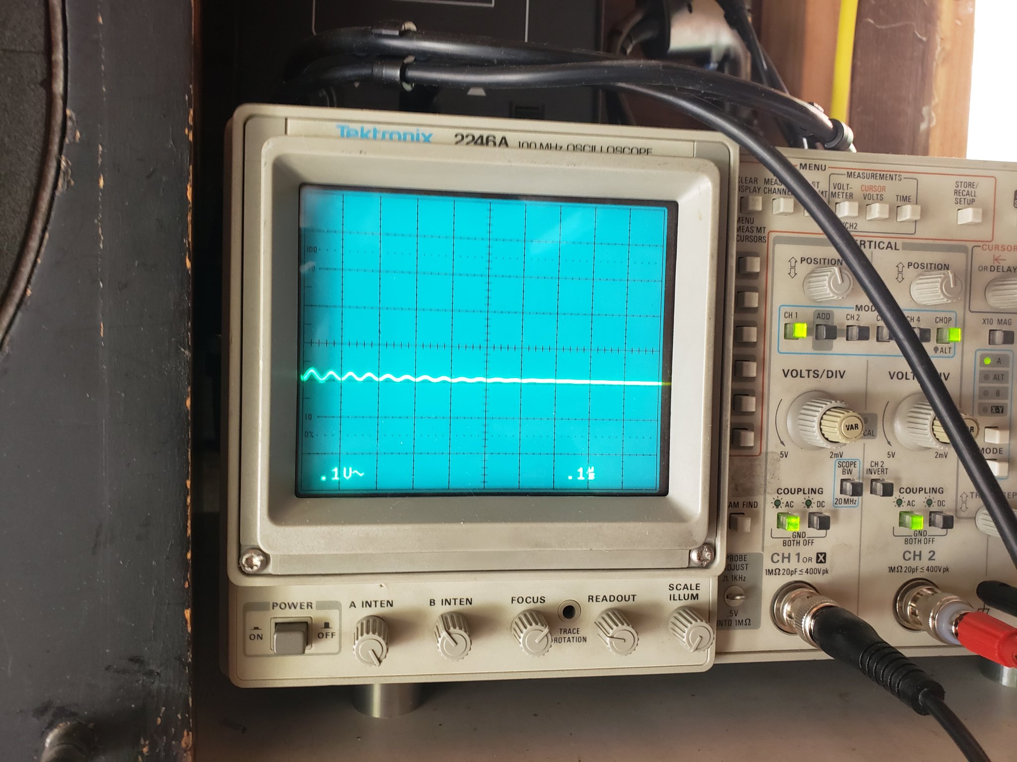

So with the scope grounded to chassis you are saying the 1.2 volts DC is clean when measured on R39 and R40 (the 4.7 ohm that goes to the base of the outputs)? The scope trace should be a thin clean line (no signal of any kind). Use AC coupling on the scope and make sure you are using something like 100mv/div sensitivity.

This is the waveform I am seeing when clipped to either the r39/40 4.7 ohm resistors leading to the base of the outputs. This looks the same on the good and faulty channel.
I just want to say thank you for holding my hand through this and helping me try to figure this one out. I really do appreciate it and feel like ive learned quite a bit walking through the steps you laid out..

You need to check this methodically. Do not assume anything as being correct. Measure it and prove it. This is very important if the amp has an unknown history. For example have the leads to the board with the output transistors had the connections to the base and emitters reversed... sounds mad but check it. Prove it.

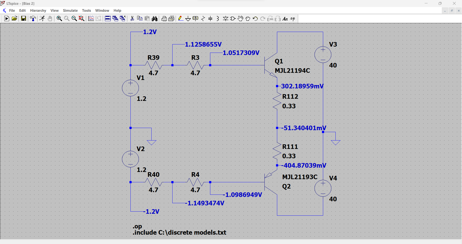

This shows the idea. The voltages sources on the left are your measured -/+1.2 volts. You can see how that turns the outputs fully on and generates a massive bias current. Note how the base/emitter junctions levels out at around 700 millivolts. It can not go higher for a silicon transistor.
In the simulation look at the voltage difference across the 4.7 ohms. You can see just how much base current is flowing,
If these conditions are met then the output pair must conduct.
Prove by measurement that the base and emitter connections (the wires between the boards) are correct and not reversed.
