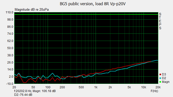

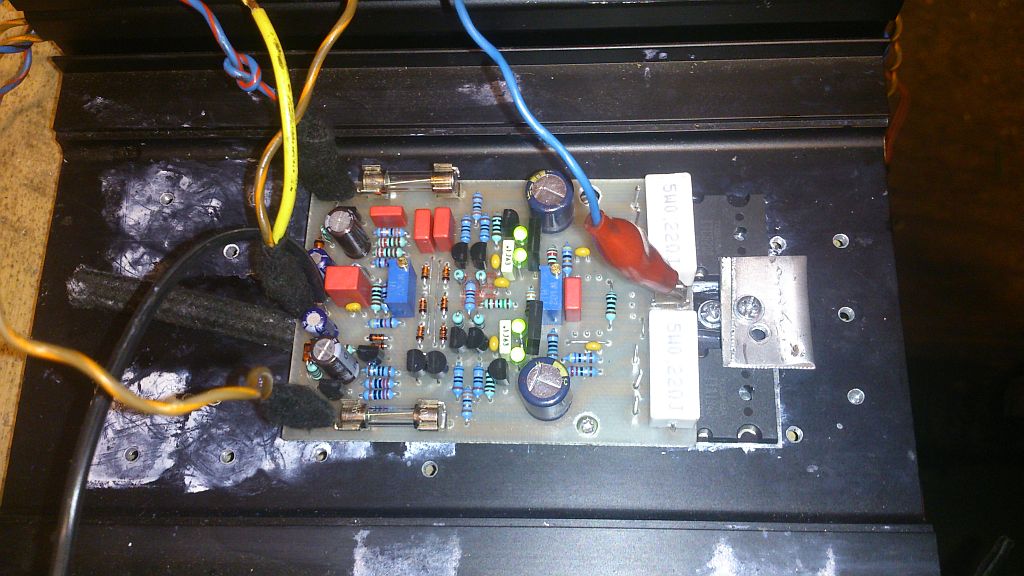

I have build a much simpler version. The amp is sounding very nice. I think there is really worth of spending more time for some tests and improvements. I have done few version of the amp. The thd measurements are very good, sound is very neutral. Two front stages can provide a massive gain so the prototype must be well tested to eliminate stability issues.
Please keep us updated if You are decide to build it.
Bellow one of my prototypes.
