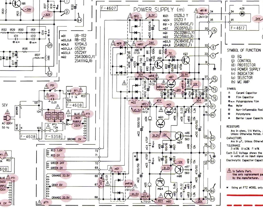

After repairing and overhauling a C-2102 preamplifier, the following error appears.
The relay LRL 1, which is connected to the connector with pins 31...32...33 on the power supply board, switches on and off rhythmically.
All components in the circuit branch on the power supply board are intact and as soon as I remove the on/off LED from connection 34...35 of the power supply, the preamplifier works perfectly.
Can someone explain to me why this error occurs and perhaps give me a tip as to where I should look? Thank you in advance for your effort and I hope you all have a nice day

Without LED there should be 23.5V before the safety resistor R1. Measure the resistor (2.2k) and check if the LED is working.
Diode reading on a DMM should measure no short or test with a 1.5V battery and a 68ohm resistor.

There are all the values around Q7, normally it shouldn't be too hard to find the problem.

Then a quick glance at the manual (no time to change glasses) and I was at a loss. I somehow misassigned the power supply to the LED.
OK, maybe it was 4 beers🥴
This made me focus too much on the relay voltage part of the circuit and neglected Q7. My big mistake, sorry
I'll look into it again later and report back.

When measuring with the oscilloscope, I discovered that the supply voltages were correct, but the voltage for the LED had a high ripple superimposed on it. When checking mC18 it turned out that the value (despite being a new part) was less than 10uF. Instead of 22uF, I used 47uF (bridge rectifiers are resilient enough) and now the preamp runs stable.
