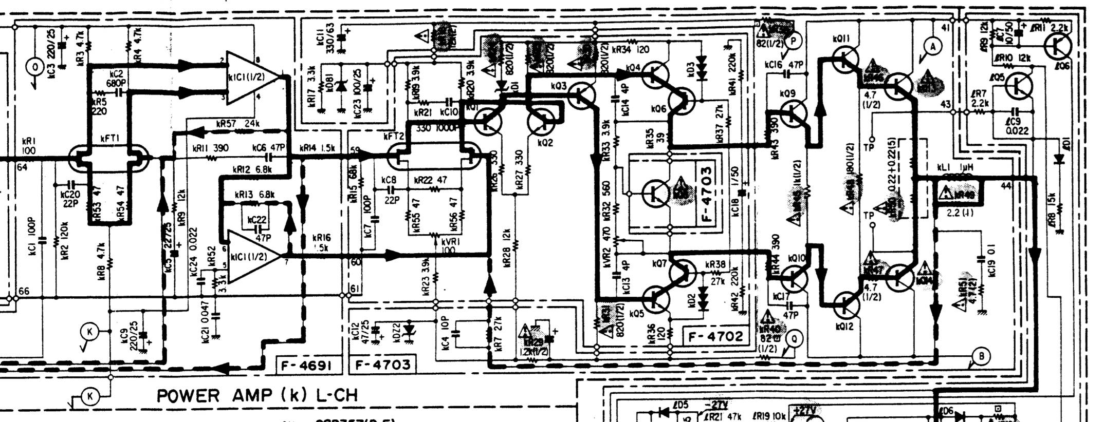

I refresh this old thread with similar problem. My amplifier is AU-G50X with the same F-4702 board. The effect is the same as described above but without any load. The protection switches on when the volume knob is at 13 hour. The amplifier works with headphones. I checked the offset voltages. Initially they are close to 900mV! I reduced offsets in both channels to 1mV or below. Unfortunately the bias in one channel is invariant (kVR2 potentiometer doesn't change the bias). The voltage on proper resistor is equal to 5mV instead recommended 10mV. What to do?

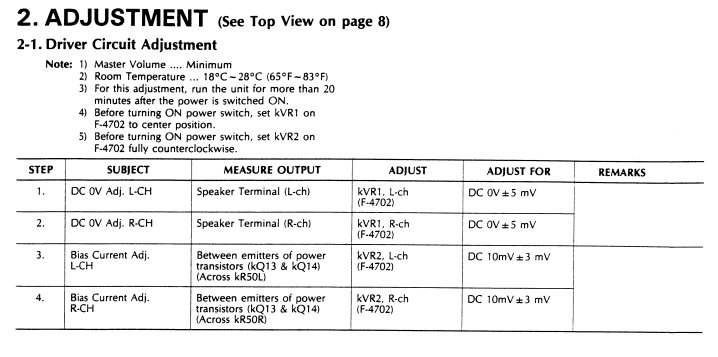

My weird problem is that I cannot adjust bias to more than say 3mV over R50 on both channels. So this occurs before protection kicks in.
R50 is a dual resistor and you have to measure the bias from the middle and to either of the other two terminals.
Gajanan Phadte
Yep, they are so even kind as to provide 2 pins connected to emitter sides of the resistor package.
As per service manual I should be getting around 10mV but I can only adjust between 0 and about 3mV.

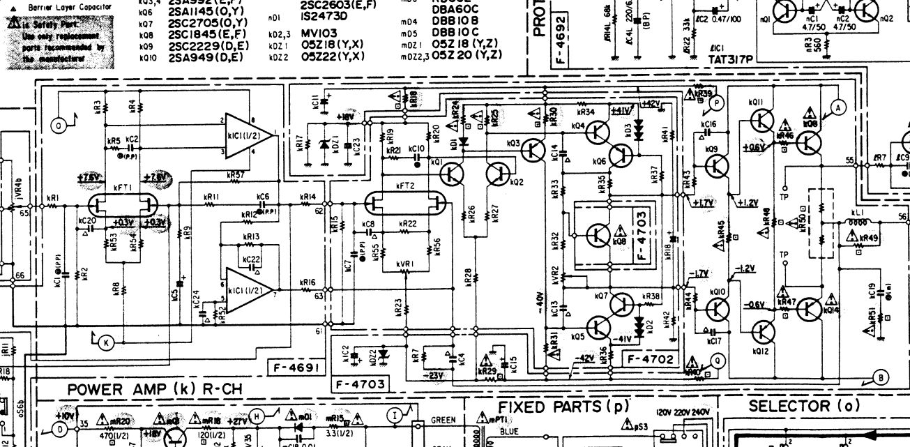

Try giving the variable resistor a spray of contact cleaner and work it back and forth about ten times,sometimes they get an oxide build up. Or better still replace them with 25 turn sealed plastic Bourns variable resistors. Check other resistors in the circuit haven't gone out of value and check the differential input transistors because if they are failing you'll never get it biased properly.
Turned out to be a corroded wirebridge near the psu caps.
Corrosion due to the glue used for the psu caps.
When measured it seemed ok but it fell apart when I resoldered the ends.
After this bias adjustment returned.
(Still goes into protection though)
Next will be replacing other suspect wirebridges
