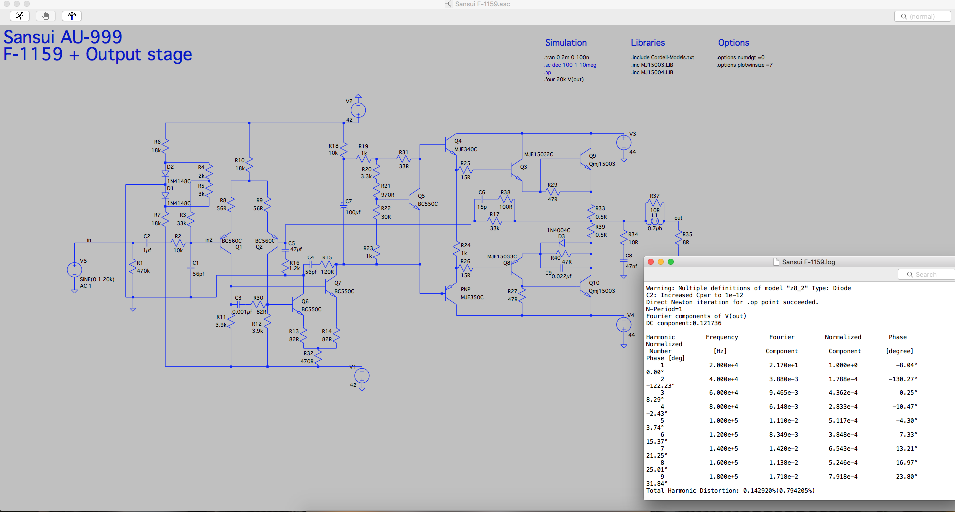

Hello,
As my first complete LTspice -> KiCad -> PCB manufacture project I wanted to remake my damaged driver boards for a Sansui AU-999 integrated amp from the early 70's.
I wanted to see whether there are any circuit improvements I could implement into the new PCB and I wanted to ask you guys for a bit of help in trying to achieve this.
I'm attaching the original circuit schematic for the amplifier, the F-1159 outlined circuit is the driver board I was aiming to rework.
So far, the possible improvements I have identified are:
1. Adding a Baxandall diode to the quasi-complementary output stage - could someone advise on the best location? You can see I already attempted to implement this in my schematic, I tried different configurations and this one is giving me the lowest THD figure. It was done purely by experimentation and looking at other qusi-comp circuits.
2. Changing the value of output pull-off resistors from 220R to something smaller as suggested by @steveu in another thread - The suggested 47R seems to give a good improvement in THD and helps improve the x-over distortion
3. Adding a small value resistor in series with the 15pf feedback cap - steveu also suggested adding a small resistor (100R as starting value) to the feedback cap to prevent RF from getting into the LTP input transistor
4. Adding current limiting - suggested by the same user, what and how simple it would be to implement.
5. Improving the input differential pair - this is something I wanted to investigate, would adding a current mirror/source be a simple matter with the existing configuration?
6. Adding op-amp-based DC servo - this might be too much for this project as I would need to add step-down regulators to create a dedicated bi-polar PSU rail for the op-amp to operate, I'm not sure if that would be worth the effort?
I would be grateful for any additional suggestions or help with the above,
My knowledge is still very basic but so far I've learned quite a bit from this project and I really would like to see it completed.
I'm attaching the original amplifier schematic along with my LTspice files, inc. custom libraries.
Thanks for looking into this!!

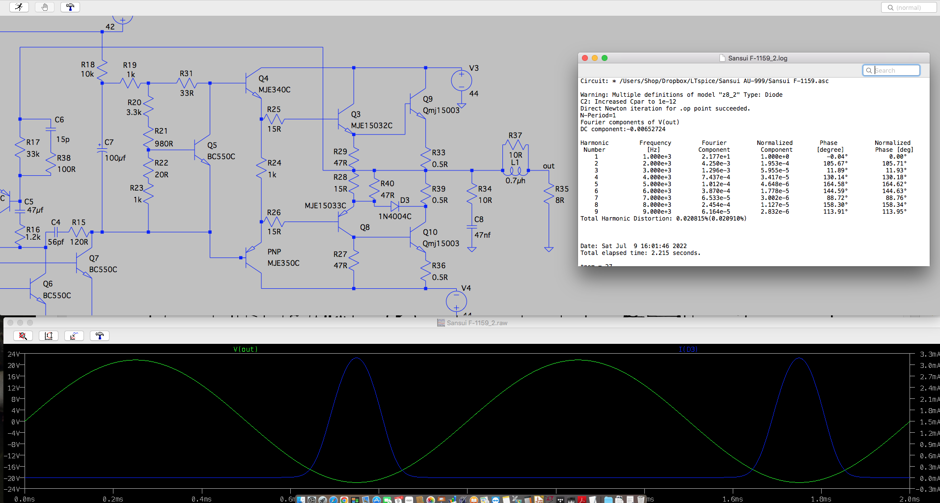

I would recommend using a complementary pair, perhaps swapping the lower MJ15003 for an MJ15004, but you may like to check how well the PNP is matched to the NPN.
I have tried placing the PNP MJ15004 in place of the NPN device but I can't get it to work properly. I guess this modification will involve more than just simply replacing those parts?
A 1N4148 in the main current path is not going to survive the first piece of music power.
I saw this arrangement in another circuit and it actually gave me the lowest THD figure in this amp. It must have been taken from a low-power amplifier where this arrangement was acceptable.

1. Connect the lower end of the UPPER NPN base resistor to the emitter not the centre rail.
I'm not sure if I fully understand, do you mean (looking at my LTspice schematic) R33 to the emitter of Q10?

3. Add a third 47 ohm between the collector/resistor junction and the emitter of the PNP driver, and shunt it with a 1N4002 diode rather than a 1N4148.
Sorry, do you mean add 47ohm (with diode in parallel) between the collector-resistor junction of the lower NPN output device and the emitter PNP driver? Or resistor and diode between collector and emitter of PNP driver itself?

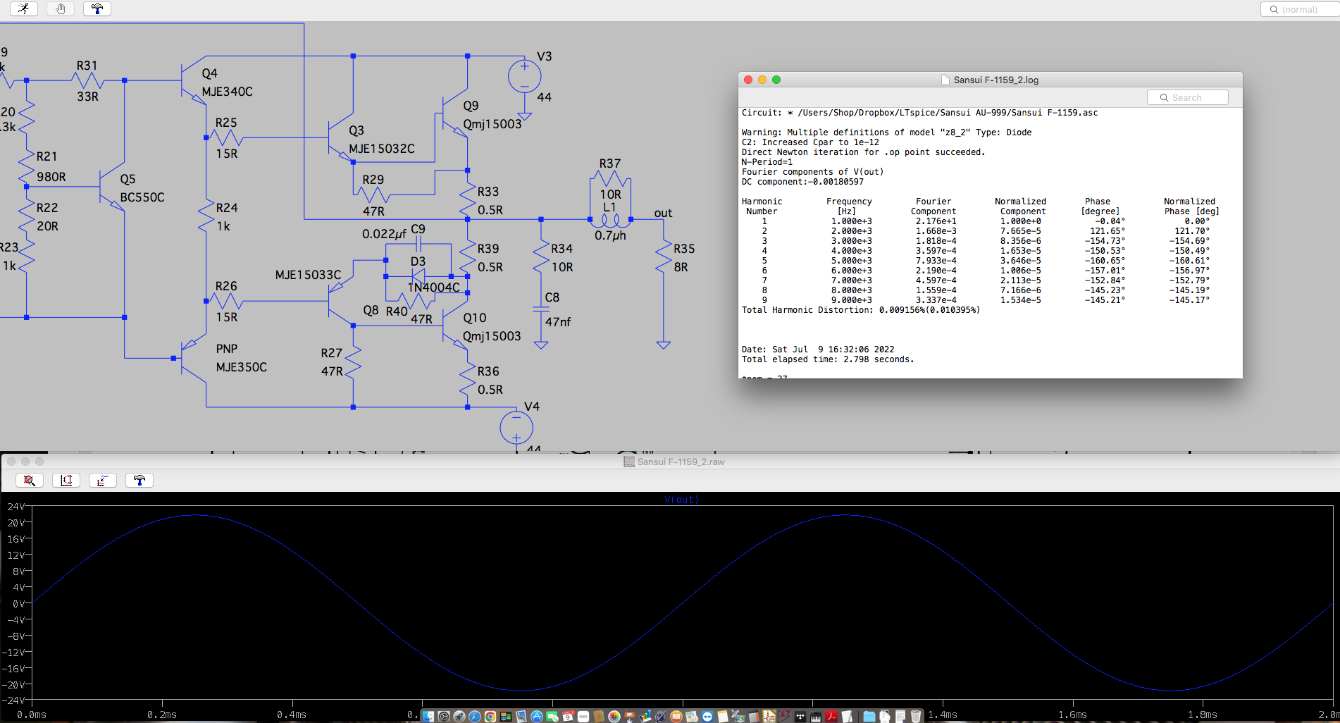

In post 6 - the 15 ohm should not be there in the emitter of the PNP driver, and the diode is the wrong way round.
In post 8 the lower NPN emitter resistor need not be there - it is less symmetrical keeping it as that is a cross between the two options.
When you said that the MJ15004 did not work properly, remember that you need to change the bias circuit to allow for 6 Vbe's, and with a triple output stage you may need an alternative circuit to the simple one transistor Vbe multiplier, but the arrangement in that amplifier is targetted at the rather unusual resistor load of the VAS transistor, which will give larger current variation than using a CCS.

Thanks for pointing this out, I realised about the lower NPN emitter resistor and removed it.
This is the final output stage configuration I settled with, I also added a current source and current mirror to the diff input stage.

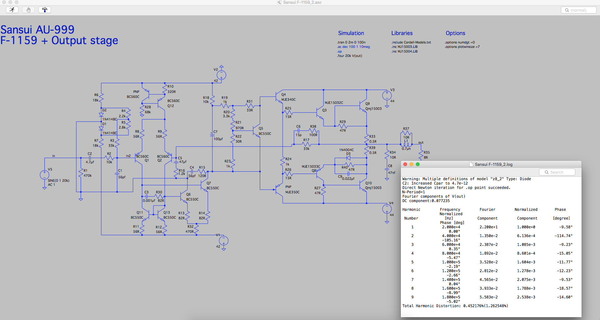

All of this has lowered my THD considerably, however, I'm a bit puzzled why the input stage modification made my high-frequency performance worst than the simpler diff pair. see below
Upgraded input stage at 20kHz - high THD

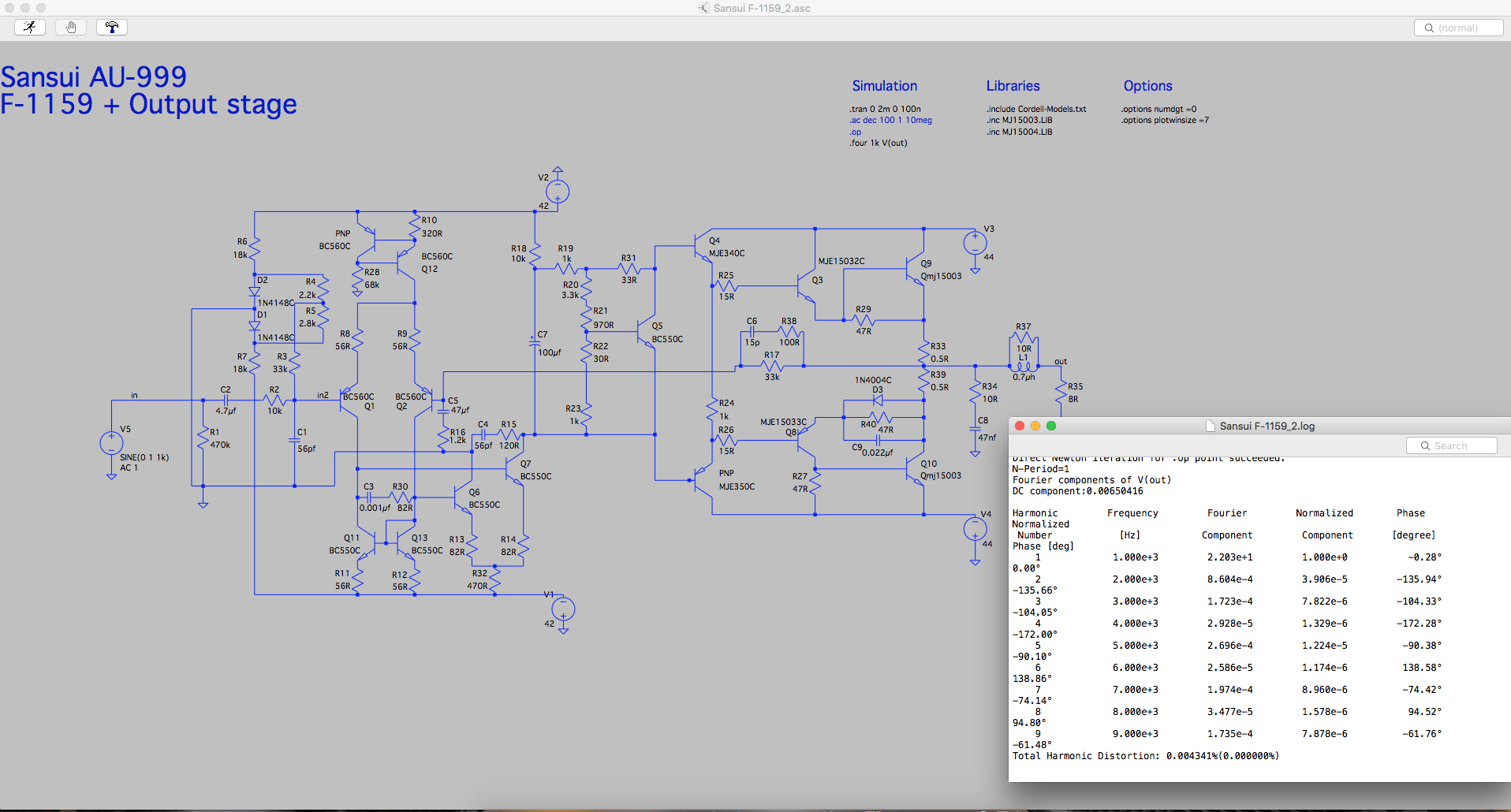

Standard input stage at 20kHz - lower THD than above

Is there something in that differential pair with the current sink/mirror that is slowing the amp down hence the high THD figure?

First thoughts - bias current the same?
bias (of the output stage) is the same (+-0.5mA), set as per the original service manual at around 30mA.
In fact, all the operating currents are basically the same across the whole circuit.
40V/10k=4mA, do you not need 150 ohms if you use your transistor pair for a CCS?
Sorry John, could you clarify to me what part of the circuit am I looking at? I have 4mA going via 10k resistor R18, I can't locate the 150ohm resistor, are you referring to Q11 & Q13 emitter resistors? If so, there is no improvement in THD when they are removed. The CCS is supplying 2mA to the input stage.
Check the curents by measuring the voltages across R11, R12.
Currents with the more elaborate input stage are matched to 4uA,
The simpler one is matched to 2uA.
Could that small difference cause such a large THD increase? The more complex input stage still performs much better at 1khz but just not as well at higher frequencies.
