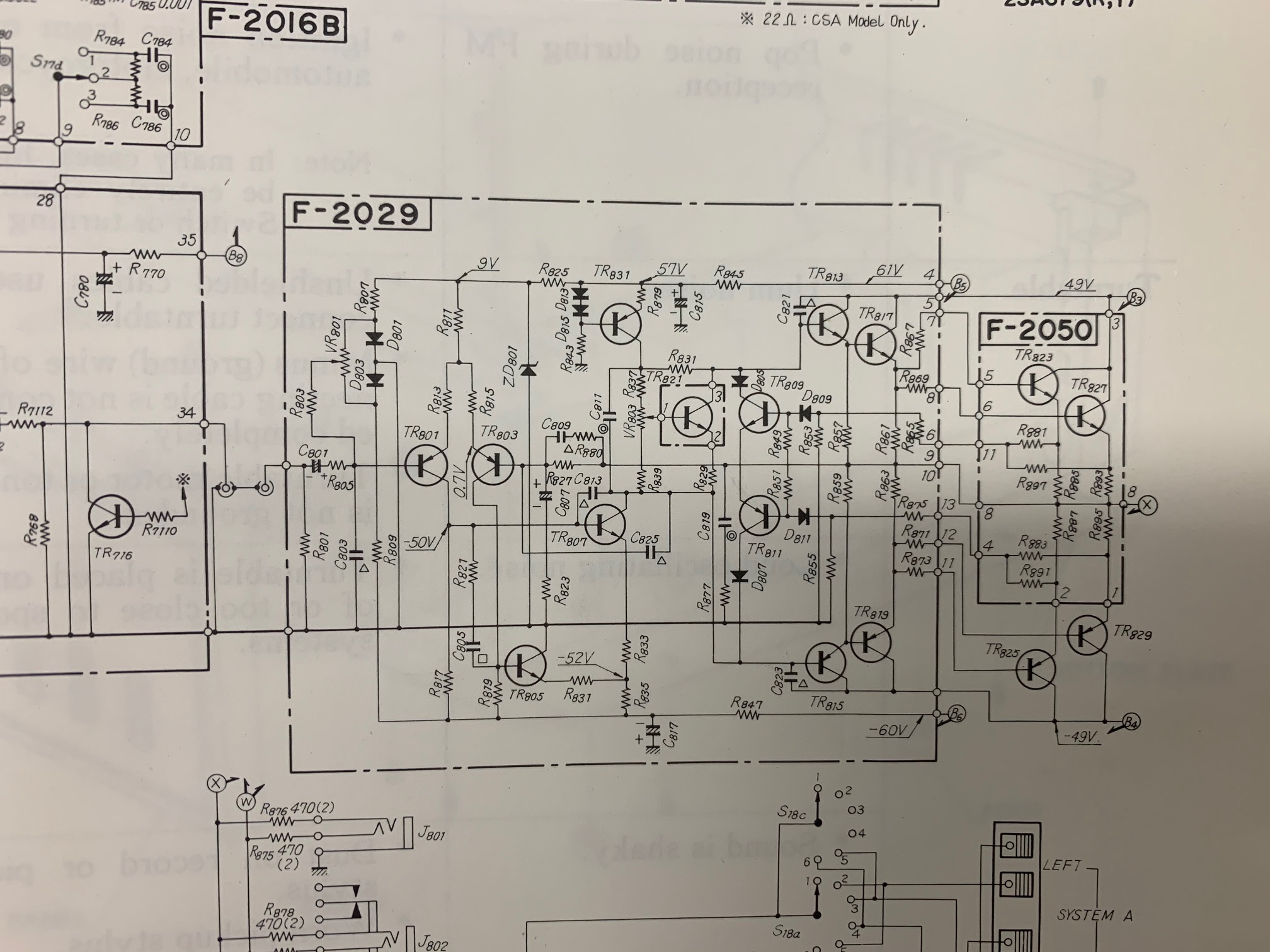

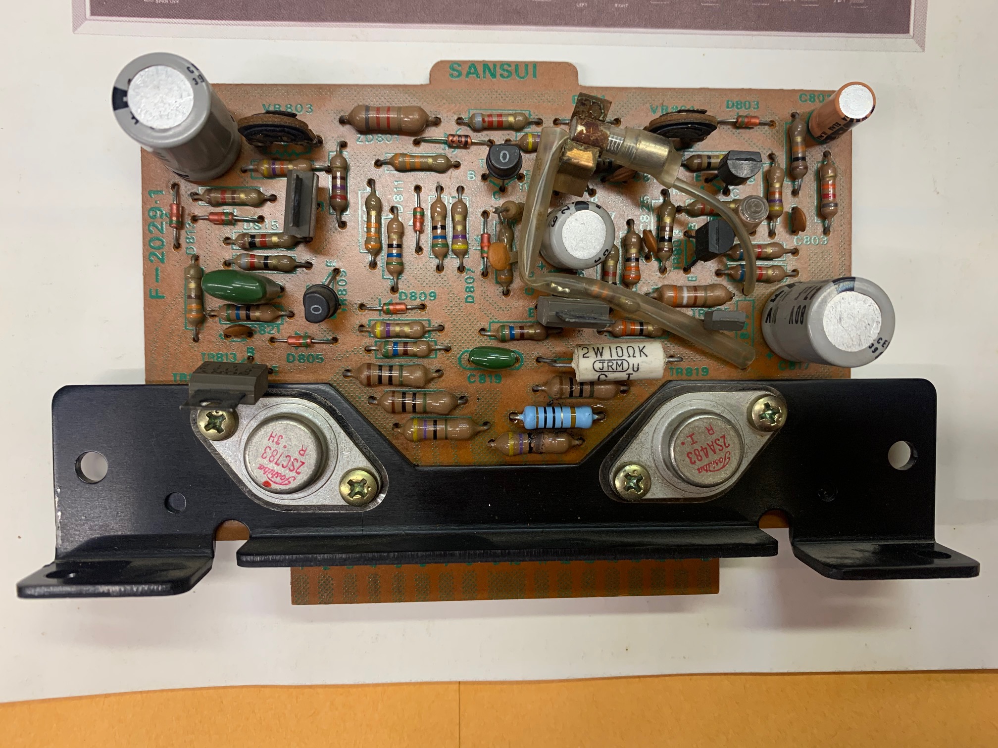

Hello,
I have a Sansui AU-9500. I noticed that one of the channels is lacking some mid frequencies making the vocals a little muddy on one channel.
Doing some troubleshooting I swapped the left and right driver boards and the problem followed. I'm not sure what I should go after on this driver board that might cause this problem.

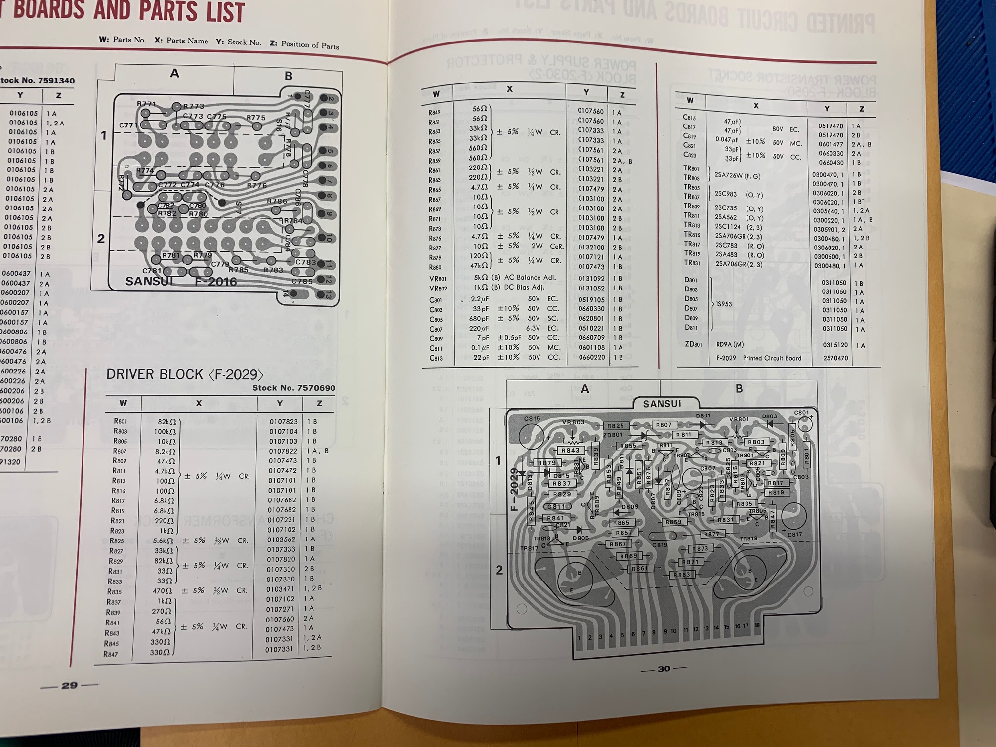

I've attached some pics of the board and schematic for reference.
