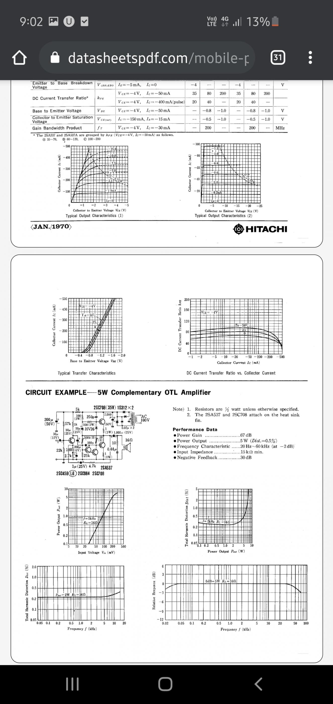

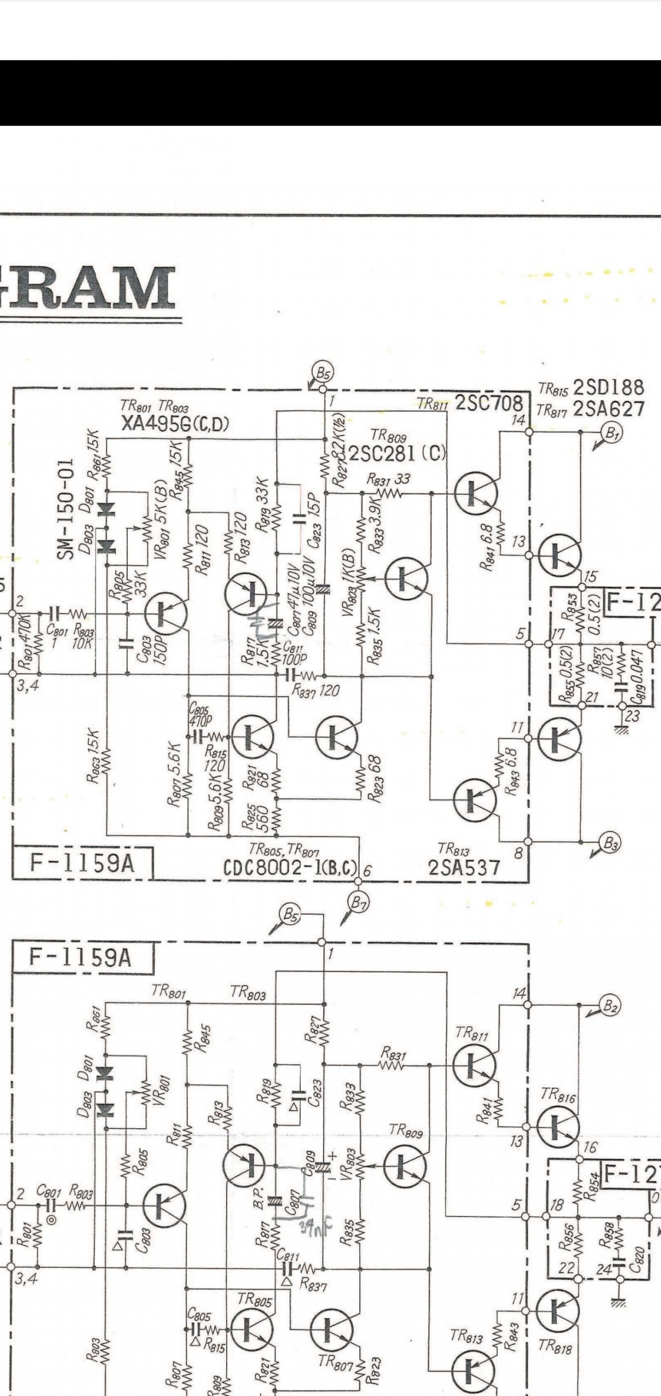

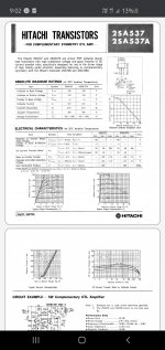

This early 70's amplifier of mine uses Hitachi drivers, 2SC708/2SA537 pair.
I'd like to be given some suggestions as to what would be an ideal replacement, these are also used in other Sansui models, the Eight being one example.
Suggestions for current available parts and obsolete parts are welcomed, I do like using well regarded Japanese transistors in my equipment if I'm fortunate to find them.
Previously I upgraded the 2SC871 to 2SC2240 and
CDC8002 to 2SC4793, there's no doubt of the improvement with those new parts in.
I'll do my best to upload the originals data sheet and the schematic of the amp.

What I'm looking for is a driver of aprox ~1A Ic and ~1W dissipation. Also one that shares a fT of ~200Mhz
I have also the 2SC5171/2SA1930 pair but never tried them as I assume something closer to the original specs might perform better.
The 2SD669/2SB649 would be another good option.
Any advice or suggestions for subs welcome. Thank you
