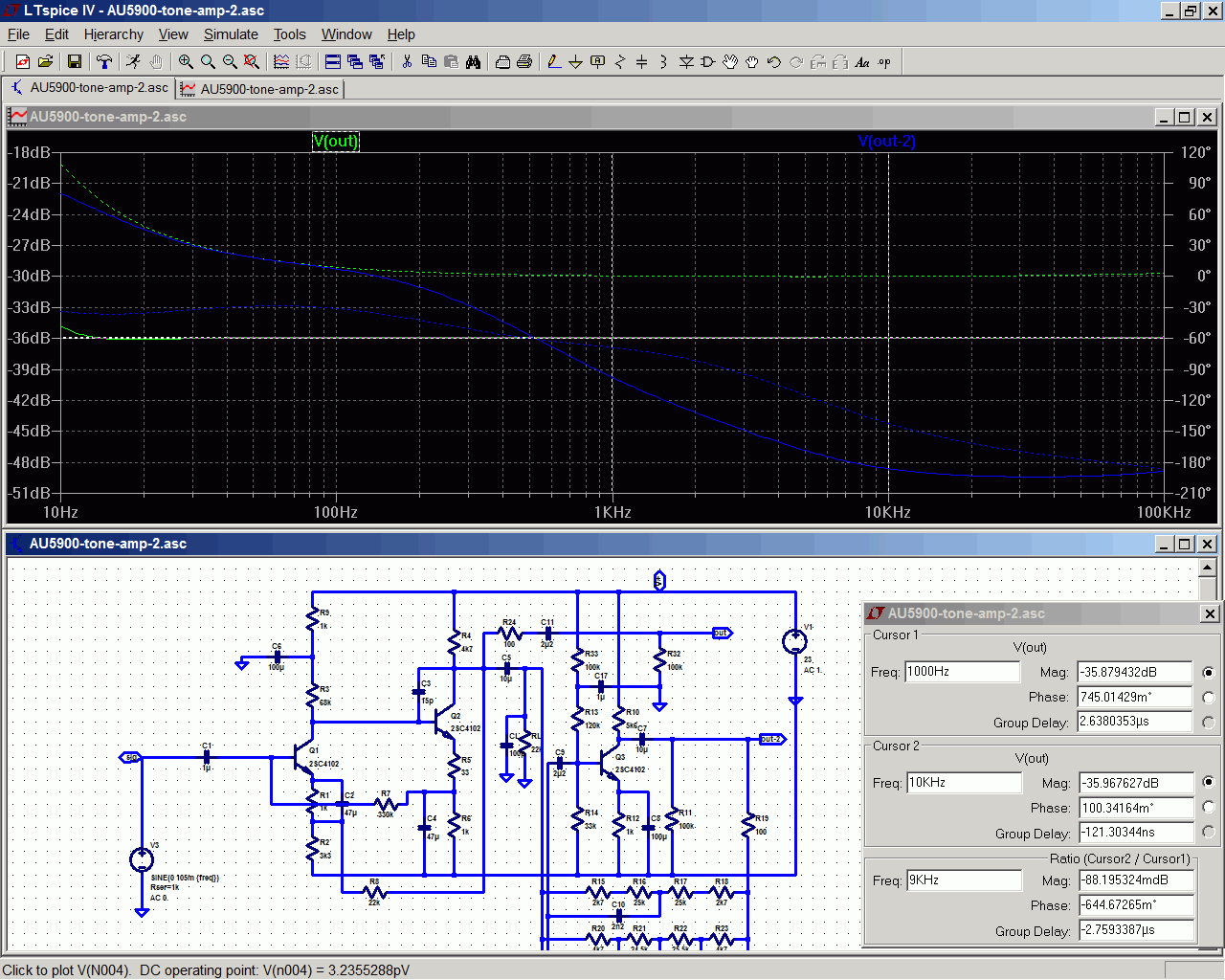

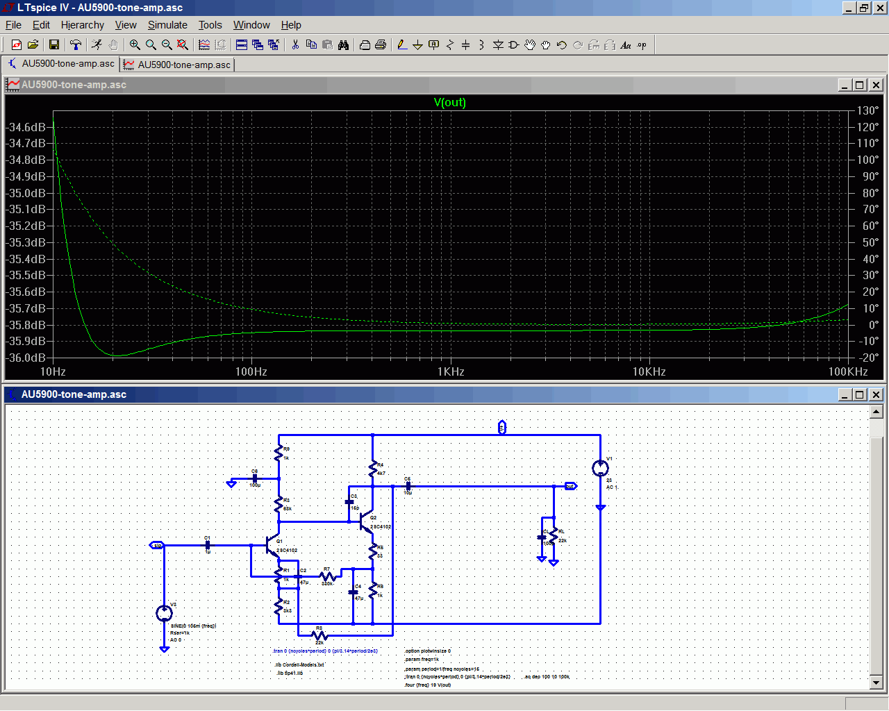

Oh, sorry, that's an LTspice schematic. Just the preamp section.
Now with tone amp added, plus two outputs (out = tone defeat / out-2 = no defeat). Tone controls tweaked for linear frequency response (set AC component of V1 to "0." and that of V3 to "1." to plot FR). Needed a bit more bass and a hair more mids.
PSRR on tone amp is somewhat better than for the unmodified preamp section but still not exactly great. Seems its basic bias network (the 220k/33k) is the main problem as I originally suspected, RC filtering the supply of that (e.g. 2k2/22u before R23) gives much better results. I normally prefer low-noise bias networks à la Grundig - R/RC between supply and ground, and an R to transistor base tapped from midpoint. That may not be as easy to hack into the existing circuit though. You might just as well split R23 into 100k + 120k, then you can pretty much get away with a 1µ filter cap...
