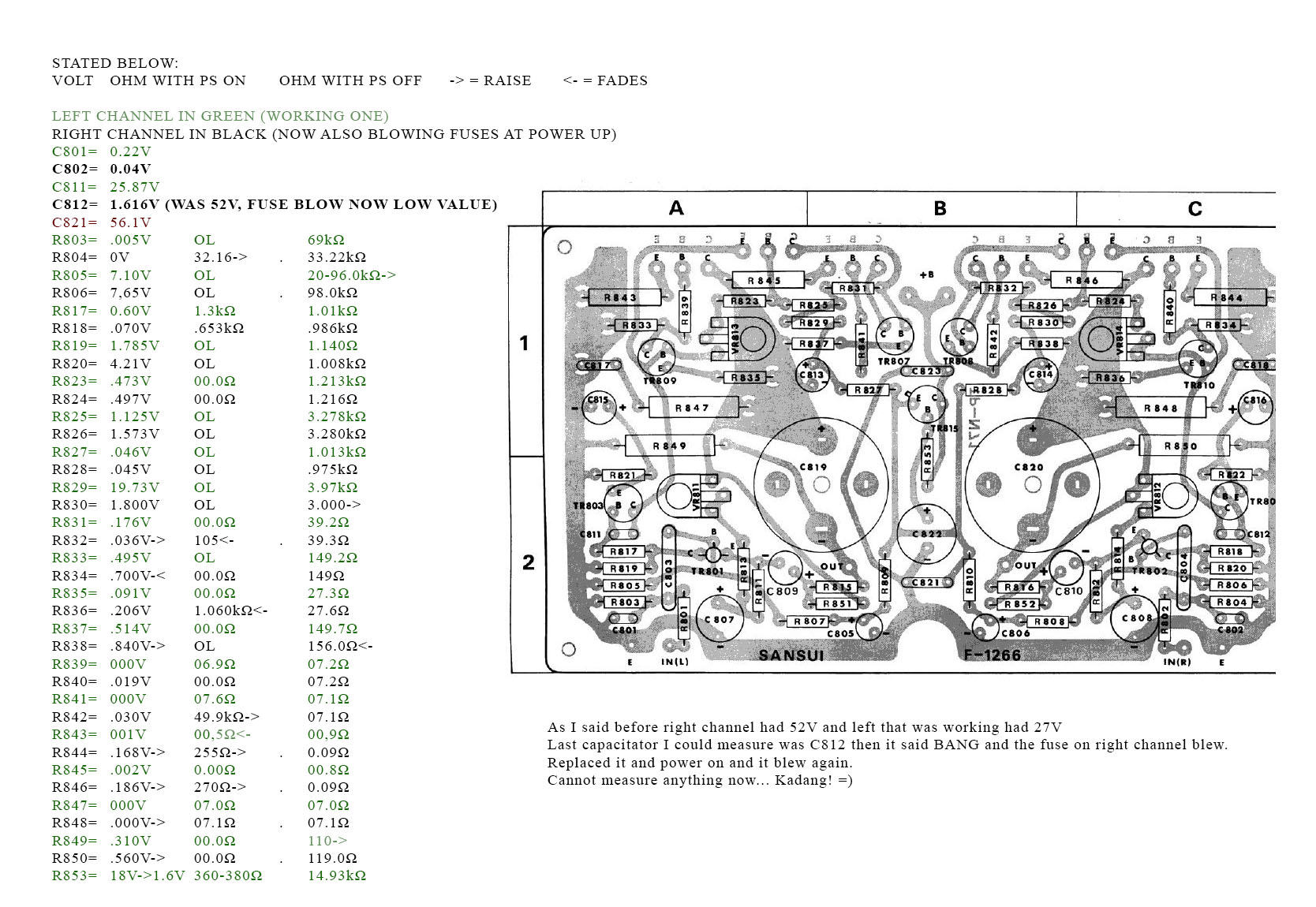

Ok. Now I'm pretty sure I have a ghost in the amp ... Was going to measure it up tonight totally and when measuring C812 I got 52V on the multimeter than it said bang and the right channel fuse blow. Replaced the fuse and it blew again. So now I'm indeed even more lost ...
From recapping without "touching anything else" -> dead right channel -> humming right channel -> fuses blowing on right channel ... ?!
I have included a picture with all values of what I was able to measure before the fuses started to blow. Now I cannot even power up the amp....
Yes could be my lack of knowledge but all I did was putting multimeter on volt and put it with clips on + and - poles with great care.... C812 made it go down......

You missed the most important ones, Compare the bad channel output transistors resistance with the good one channel. Check the resistance of the output transistors from emitter to collector & base to emitter & collector to base compare values with the good channel. Post the values.

Welcome: Did the measuring now. 3 of them are ok. The TR814 is beeping only when I have it on the leg that is under the B (Hitatchi logo) and then anywhere on the case of the transistor. It also gives a strange ohm value.
So this one is toasted then..... BUT still I'm more than confused how/why ? Anyone have a theory if this transistor could move voltage wrong backward to the right channel ? It didn't start to blow fuses until I measured between C812 ?
