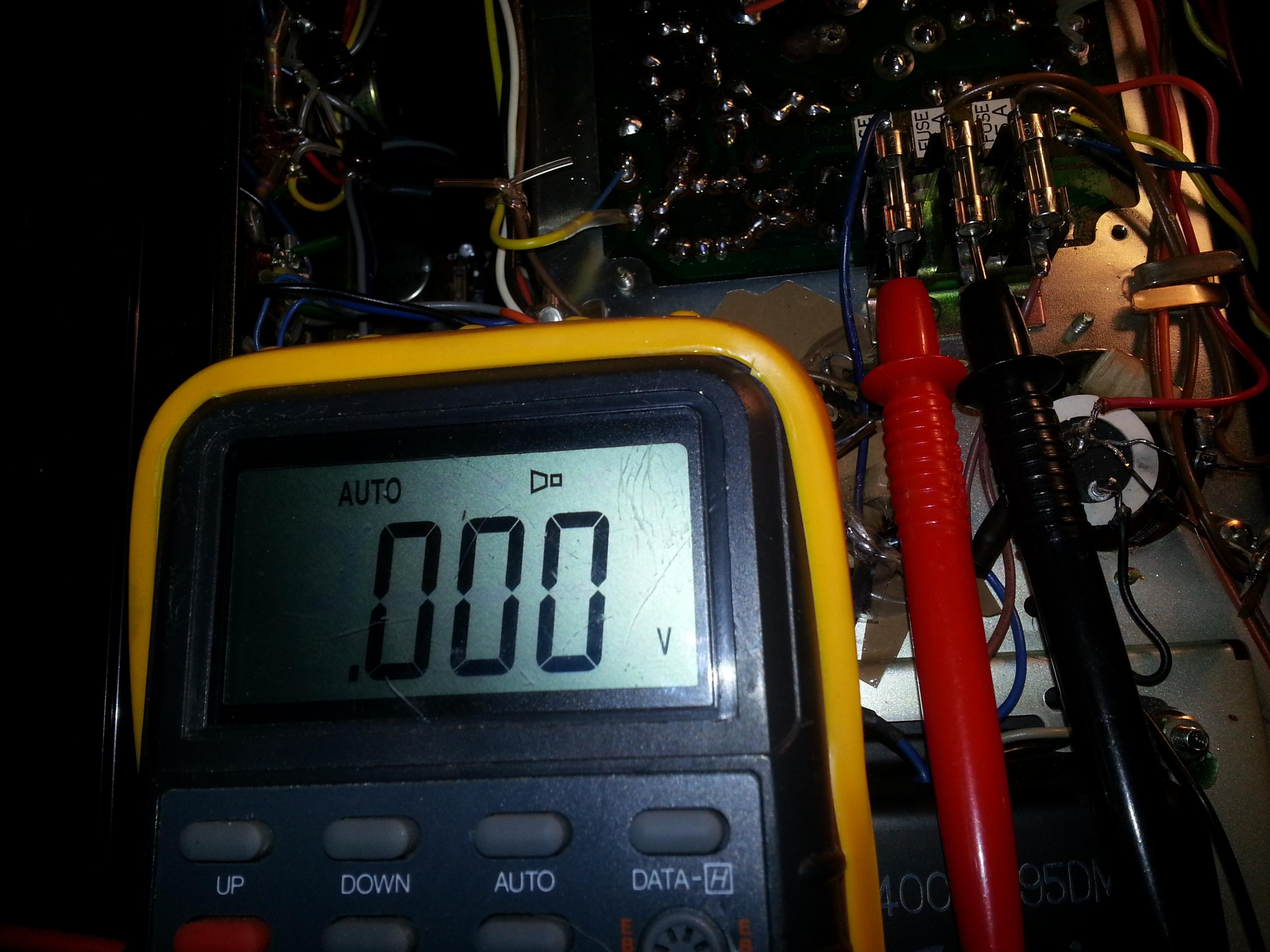

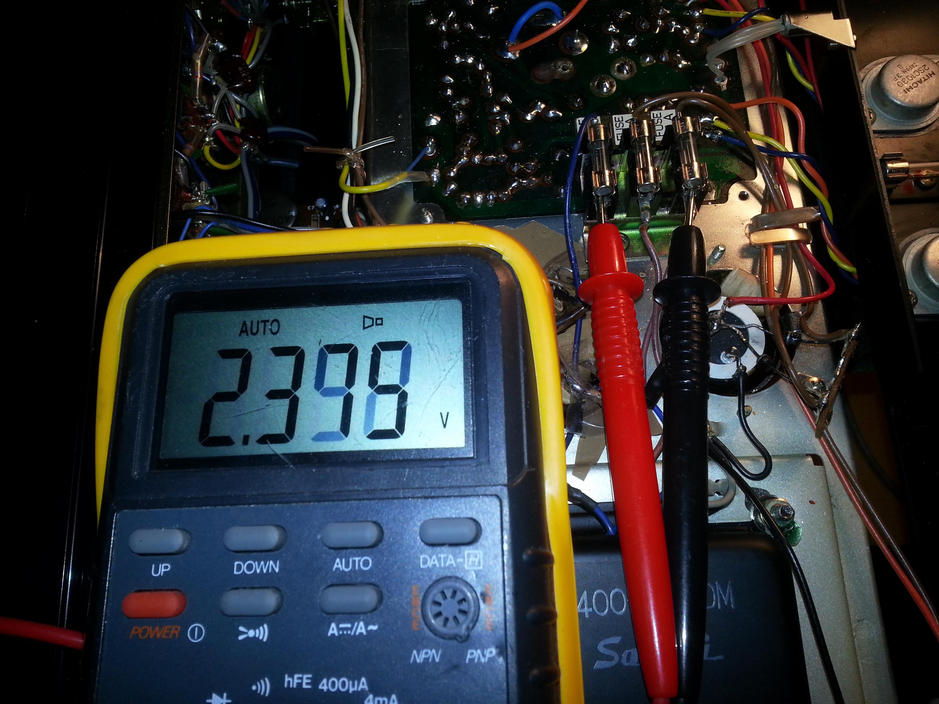

One channel died after I recapped the amp. I was very careful but now one channel is totally dead. I thought it was a fuse or a bad solder but I started to measure and I noticed there is no power at all from one of the channel from the PSU?! Should it be like that or what could have gone wrong? I'm not that "familiar" with reading schematics ... See the pix attached.
Thanks in advance.

I don't think measuring voltage between fuses will tell us much without knowing what you are trying to tell us there. F002 and F003 are the respective V+ (56V) supplies to either amplifier. You measure the voltage on either side of the fuse to compare the voltage into and out with respect to ground - i.e the neg. lead touching ground. I guess you are saying that one fuse is blown and that channel no longer works? If so, measure the voltage between the supply and amplifier ground, since this is a single supply design and has capacitor output.
The question remains as to what changed values, types and polarity you recapped your amp with and whether modern, larger and low ESR caps simply caused a larger current inrush at start-up, blowing a fuse. A common mistake for unsuspecting new DIYs.

Did you check the fuses for open? With the meter selector switch in resistance check both end of the fuses. They should read zero ohms resistance.
I downloaded the 555a squematics and those fuses in the pics look like to be an add on as they don't exist either in diagrams or pictures in the service manual.
Also, 2.3V is not a voltage to consider coming from the PS.
If you are lost you should start taking measurements right at transformer input (input AC), then at the transformer output (output AC), then after the rectifier diodes right at the filter caps positive terminal against ground. That will tell if the PS is really working. The 555a PS is really a basic one and you should find this task easy.
Please report back so we can go on from your readings.

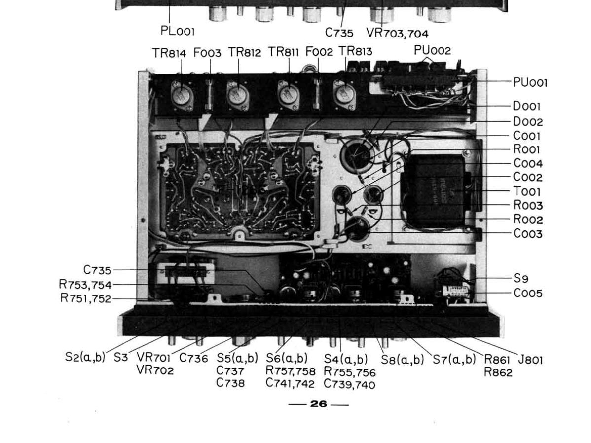

The fuses are positioned between the power transistors on both 555 and 555A models shown in the service manuals, sextaafondo. However, who knows if mods were required for a model sold over 40 years ago in Sweden, perhaps.
We only need to identy F001 (230VAC) F002 (56VDC left channel output stage) and F003 (56VDC right channel output stage) to find out whether power is available though. Note that an unfused 55V supply is always connected to the rest of the amp. and should always be available for checking, assuming that is not actually the third fuse we see in the pic of this amplifier. ! 😉

I'm pretty much a newbie so what I wanted to validate is that I had no power on one of the cables coming out from the PS and I find that odd...
So do you guys mean that this fuse holder is a "addon" ? I think it was sold in Sweden but it should have been untouched until I started to recap it.
I didn't messure the fuses but I swapped them left/right and so on and same result so the fuses are ok.
Ian and sextaafondo... Where do I put the multimeter to check this 😛 Do I need to open the PS ? Or are there spots I can messure. I can see F002 and F003 but not F001 ... Not sure where to put the multimeter ? Sorry but I need to learn (and ask to learn) =)

Just did some new measuring. What I found strange is that C002 and C004 have so different values ?
C819 and C820 = 29.18 and 29.87 V
C001 = 60 V
C002 = 44.8 V
C004 = 25.75 V
C003 = 29.90 V
F002 = 60.8 V
F003 = 60.8 V
All fuses are 0 ohm
Hope someone can give me some other hint here.

Those measurements are OK and say that the PS is working and IMO are within what would be expected though a bit on the high side. Might be due to the AC line being a little high, or due to the power amplifier not draining any current.
It's expected that voltage readings over C002 and C004 are different. Check out the PS desing. There are resistors separating them to provide different PS values.
Ian, and Evilution, regarding those fuses the stock ones as said should be located between the power transistors. The fuses in the first post pic are for sure some sort of repair job on the amplifier. Screenshots from the service manual below.

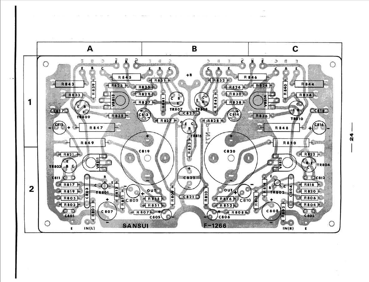

Having one good channel is a great advantage. You can compare key voltages between channels to locate fault areas for closer investigation. Look at the schematic's lower channel and see the expected voltages marked already. Now, locate the output capacitors C819, 820 then measure the voltage at the + terminal of these. Make sure your reference point for the -ve probe is always Power Supply ground. To avoid slipping with probes and blowing components it is smart to use a clip lead or probe tip to make the ground connection and then concentrate on safety with using just the other probe.
FWIW, inexperienced people often have this problem - they don't realise how fast and silently their precious components are smoked when they start poking around with meter probes or a screwdiver.

Most likey you soldered one of the power supply wires in the wrong place. As a first attempt, follow the wires going out of the PS caps and trace them closely to where they go on both channels.
As the amp has 2 channels and one of them is working fine check out one channel wiring against the other. Must be simetrical, in other words a PS wire going to a certain point in one channel must go to the same exact point in the other. Do this with the amp OFF. Be very observant.
Most likely it's not the new caps in the PS as they feed both channels, and you have one running one.
