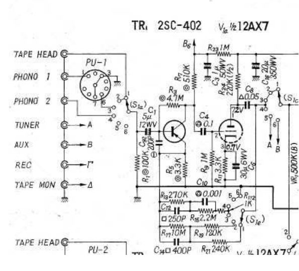

I got a hold of a A111 schematic. The mag. preamp section is different than the 2 BJT circuit found in other tubed Sansui units. This 1 seems to be truly hybrid. I've uploaded a schematic snippet of the mag. preamp section.
I'm a stuck record when it comes to old units with multiple mag. EQ setups.
I routinely suggest 1 pair of RCA jacks be hard wired to the mag. preamp that's permanently set to RIAA. IMO, switches in the signal path at mV. levels are NOT a good thing. Make all the other inputs "line" level. Mouser carries inexpensive replacement source selector switches by Lorlin.

Currently I need to rewire the volume and balance pots correctly. I can't figure which VR assignment on the schematic. The last time I did a trace, 1st pot (500k) if not mistaken, just after the Function switch is a sub volume located at the back panel.
I'm thinking VR7 & 8 is the main volume and next one is Balance. I compared 2 different schematics Earlier & later, the pots differ in resistance value.

Case closed. Amp restored to its original state with bits and pieces of info found in other forums. Nightmare over.
