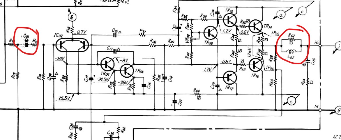

Unfortunatelly I've shorted base with collector of the right channel's old 2SB507 (which was working brilliantly) and now I have to check around there.
The thing is that the transistor itself tested good with a normal diode test and all voltages of this channel are according to the manual.
For the other channel all supplies correct.
Where do I measure offset? Collectors TR604-TR605? It's 0V there.
All voltages correct up to TR05 (staring from TR1 and all the power supply and head amp section). The collector there shows -3.4V instead of -1.2V for the left channel. The right channel's same transistor TR06 has -1.2V which is correct.
After that all the voltage around TR07-09-11-13 seem higher than the ones of the right channel.
The bias seems adjustable for the voltage (+- 0.3V). But the voltage is really harmfully high I guess.
Shorting C and B has applied full negative supply to the amplifier output...
I would be surprised if the transistor survived that. The first thing to do is to check all those low value resistors in the output stage. You can test those in circuit. The 0.33 ohm the 6.8 and 220 ohms. Check them all.
DC offset is the voltage appearing at the junction of the 0.33 ohm's. It should be zero.
If TR05 collector is at -3.4 volts then there is a problem but we don't know where until you do all the measurements.
Why not measure and record the voltages for TR05 TR9 TR11 TR13 and TR15.
Copy and paste this and fill in all the readings.

Here we are.
I also measured the right channel similar transistors which doesn't work anymore (it gives a very very weak distorted sound on both speaker and headphones).
The left one gives a weak distorted sound on the speaker (like one of its sides has died) but a good sound on the headphones.
TR05
E= -25,7v
B= -25V
C= UNSTABLE -2.3 - -2.5V

TR05 collector and TR11 base should be the same point, and so the same values.
Apart from that though nothing very obvious stands out... no shorts or open circuit.
Lets concentrate on the RIGHT channel only. This is a real puzzle because the voltages here are pretty much spot on where they should be.
You have no offset and the output transistors are on the verge of conduction. The voltages on the drivers are correct as well.
Remember you have the amp in front of you, I don't. so some of this may sound a bit odd but its the only to know what is going on.
1/ Have you tried a different speaker on this channel? Reason for that is if any previous DC fault has damaged the one you are using.
2/ Have you an oscilloscope? Can we be certain the audio at the input to the power amp is clean (so C01 it looks like on the diagram).
3/ Are the mute transistor OFF? That is TR604 and 605. There should be the negative voltage on the base as shown on the diagram.

Very unlikely for any coils to be faulty, and also any of the components after the output transistors.
The mute transistors will be OK if they have -0.3V on the base.
Have you got the speaker attached when looking at the sine wave test tones?
The signal should be clean on the cap shown here. If you set the signal level to 100mv peak to peak on the cap, how much signal do you see on the output and does it look distorted or not.

It is very unusual to have an amplifier where the DC conditions are correct and yet the sound is poor/distorted/low etc.
I think one test you should do is to see if the DC bias current adjusts correctly. Connect your meter across the tests points (so between the emitters of the two output transistors) and without any load attached or signal applied see if the pre-set works correctly.
100 milliamps (as a quick test value to make sure it adjusts normally) would be a voltage of 66 millivolts across the combined resistance of the 0.33 ohms (V= 0.1/0.66).
If that does work OK then set the value back to 13 millivolts between the test points.

That was a good one.
Things changed when I plugged headphones on the out.
I don't want to add good speakers during test with signal generators for obvious reasons (frequency and voltage drop outs etc.). I haven't got cheap passive ones around.
So what I see on the out is totally different for the right channel. It just shows two separate lines moving. The signal comes out of the headphone can reacting properly to the volume pot.
On C06 negative side (where you show me) the signal is about 5mV. Not a bad-distorted shape but 20 times reduced in volume. I used a 100mV sine wave of around 3khz.
For the left channel the waveform changed on the out as well...quite unstable and distorted. But we'll get back to it (for the left channel) later.

Sorry I'm losing you Mooly.
Do I switch to current on my DMM and place the red probe on the emmiter of Transistor 14 and the black on the emmiter of transistor 16 on TP02 - TP04? And then I set the bias pot to 100mA? (This is how I was checking the bias so far - I was just playing around 20mA)
And then I switch to voltage and I place the black on ground and red on each test point looking for 13mV on each one? Is this right?
It is voltage we are measuring between the test points, not current. The current is determined by calculation.
We have to do it that way because your meter is like a short circuit when on the current range and so it would effectively short the 0.33 ohm resistors out and the readings would be different as soon as you removed the meter.
I wanted you to see if the bias would increase correctly as you alter the setting... yes 100ma is far to high to leave it like that but we need to know it works as it should.
So connect your meter on DC volts and check the voltage between the test points can be increased to around 66 millivolts. Then reset it back to 13 millivolts.

This is what I was doing so far.
And yes the right channel can give more than 90millivolts - it's actually very reactive after a certain point.
The left channel one doesn't give any measurement.
The right channel gives no good sound whatsoever.
The left gives good sound on the headphones and when it shuts down.
Lets stick with the right channel.
So the bias does indeed adjust correctly... this is really bizarre you know
First thing is to set the bias back to the correct level which is around 13 millivolts between the test points.
We have to look at this dynamically now. Make sure things like the tone controls are centred (because these are part of the feedback loop for the power amplifier) and set the scope and signal generator up again.
Have NO speakers or headphones connected.
Apply a known amplitude sine to the input, lets say we use 100mv peak to peak again and 1Khz. Measure this on the input coupling cap I circled earlier. Be certain you have 100 millivolts peak to peak.
Now tell me what the peak to peak amplitude is at the output. Measure on that coil at the output.
What peak to peak amplitude do you see?
Is the sine clean or is it distorted looking?
Now plug the headphone in.
Has the amplitude or shape changed?
