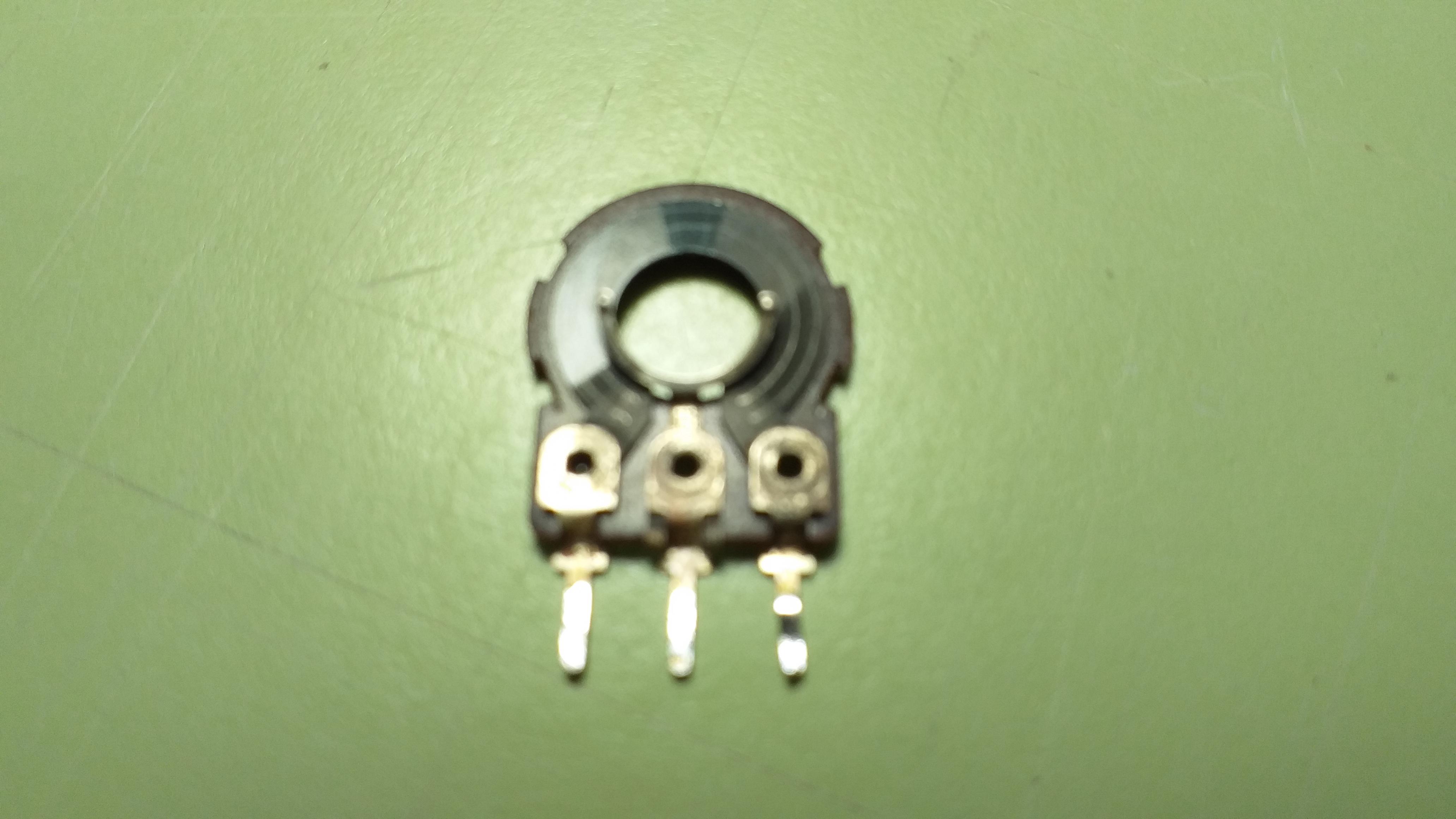

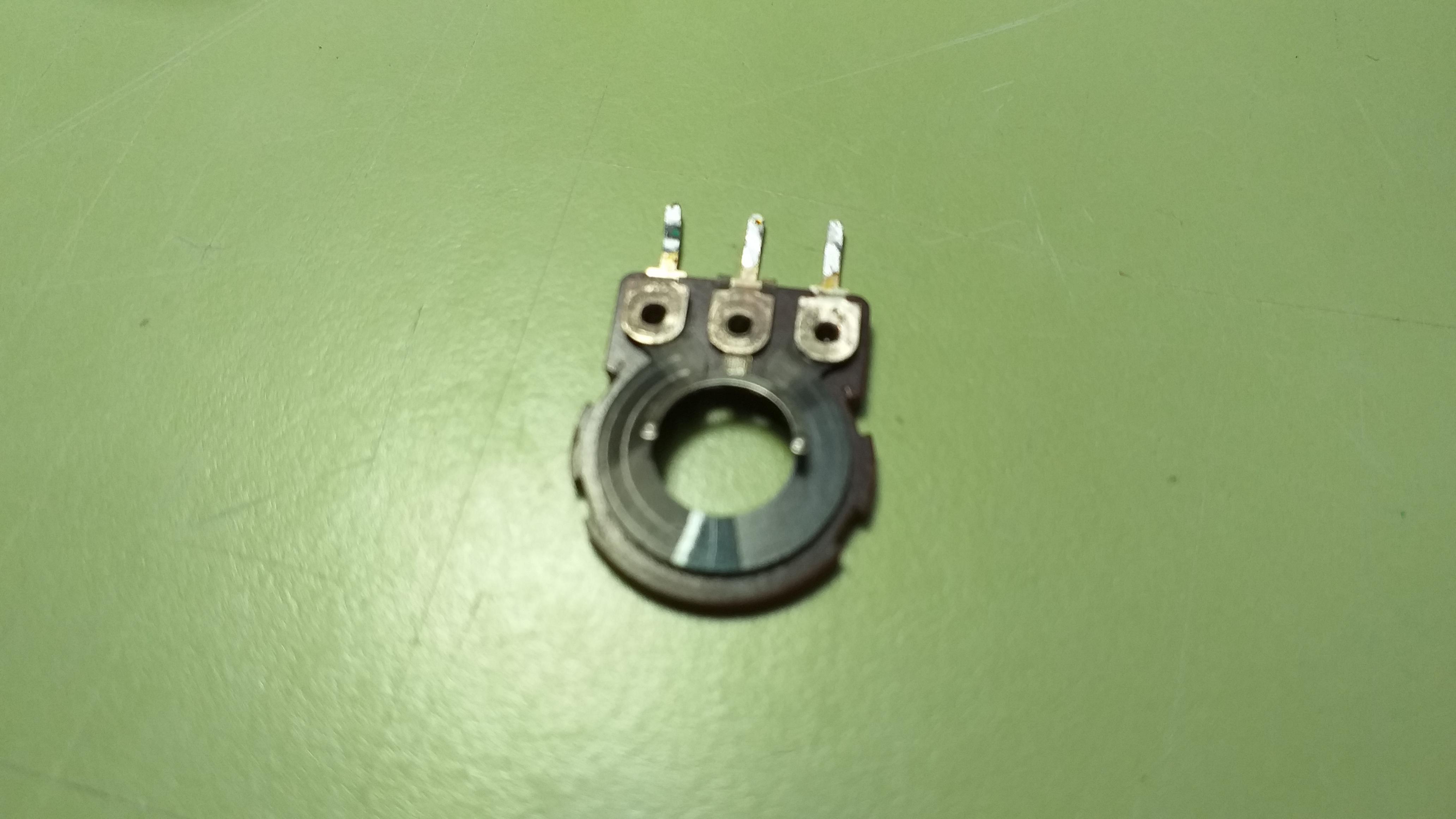

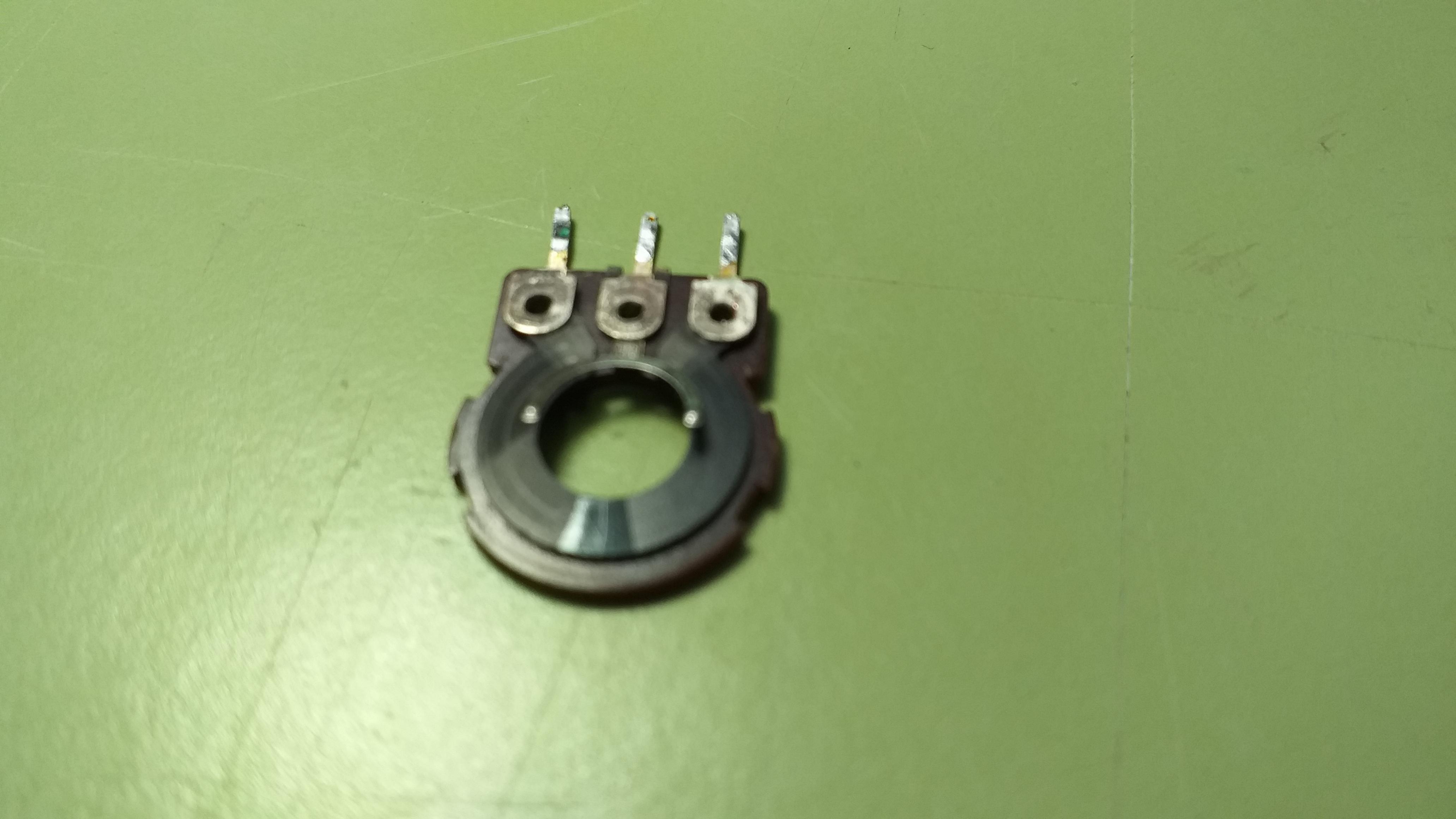

Disassemble one of the pots, attached some photos in which I see a bright insulating layer on top of the carbon track, it would seem that intentionally, there is no connection with the cursor in the center of the path. The resistance between ends is 100K. Sorry for the bad focus of the photos

It actually makes quite a bit of sense to design it that way - this gives a reliable "dead zone" around the center detent with known-linear frequency response, without having to depend on the pot having the exact right value at that spot (tolerances in log pots are no trivial business).

Finally, it went on track as we say in this place in the world. Obviously, it is not a damage caused by washing with ultrasound, it is by design. There are no jumps, no strange noises, it works perfectly well. Every day you have something new.

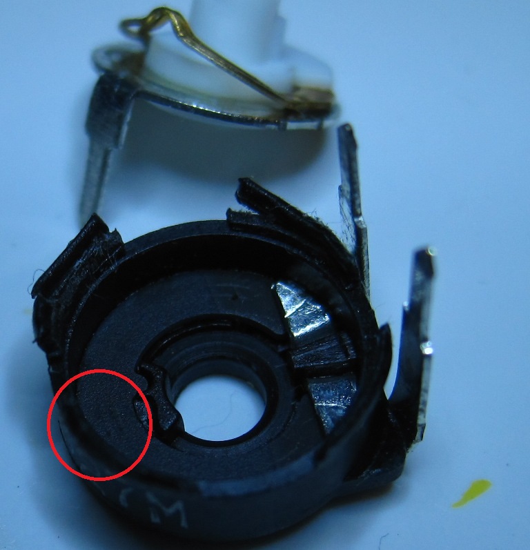

I wouldn't make any conclusion that ultrasonic cleaning won't damage potentiometers/trimpots. Your case is an exception given that the middle detent apparently doesn't have any carbon material that affects the operation. If you look under a low power microscope, the surface might not be that smooth.

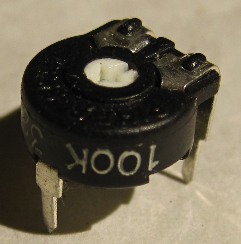

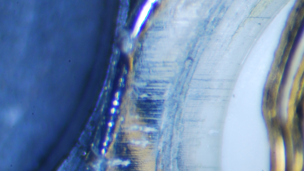

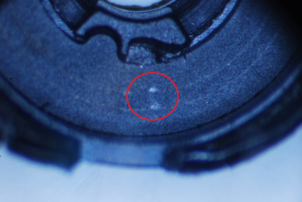

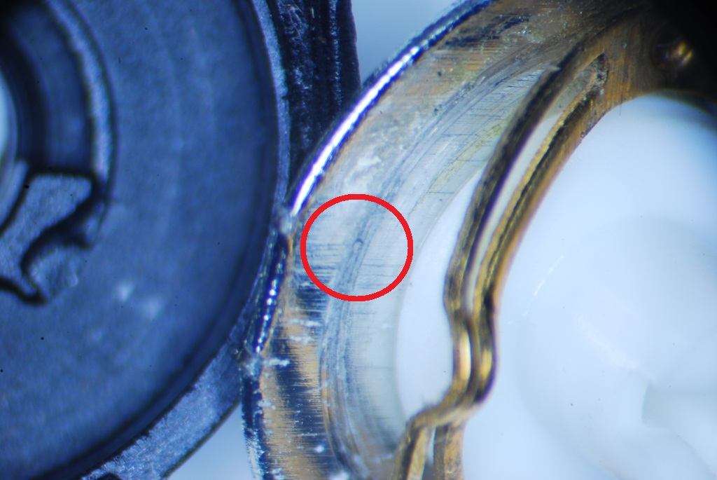

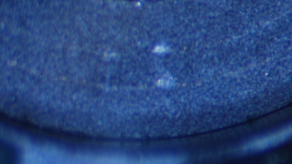

In the name of science, I performed a little experiment. I subjected a new Piher 100k trimpot to ultrasonic cleaning. The wiper was set close to the middle and the cleaning solution was water and a little bit of dishwashing soap. The test ran for about 30 minutes or until the ultrasonic cleaner timed out.
After the test, it was clearly visible under a low power microscope that some physical damage are visible on both the carbon material and the metal area which are in contact with the wiper.

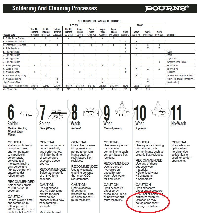

Some potentiometer/trimmer manufacturers explicitly warn about NOT using ultrasonic cleaning for some of their products. It makes sense that their warning should be followed.
790348d1572034178-sansui-a80-tone-control-bourns-jpg

Hi ej25. Totally according to your comments, I did not think well what could happen if I cleaned them with ultrasound, and this offline cursor reading in the center of the route led me to make the query and better rethink what I had done. I think I was lucky, maybe if I had left it longer it would have caused some irreversible damage.
