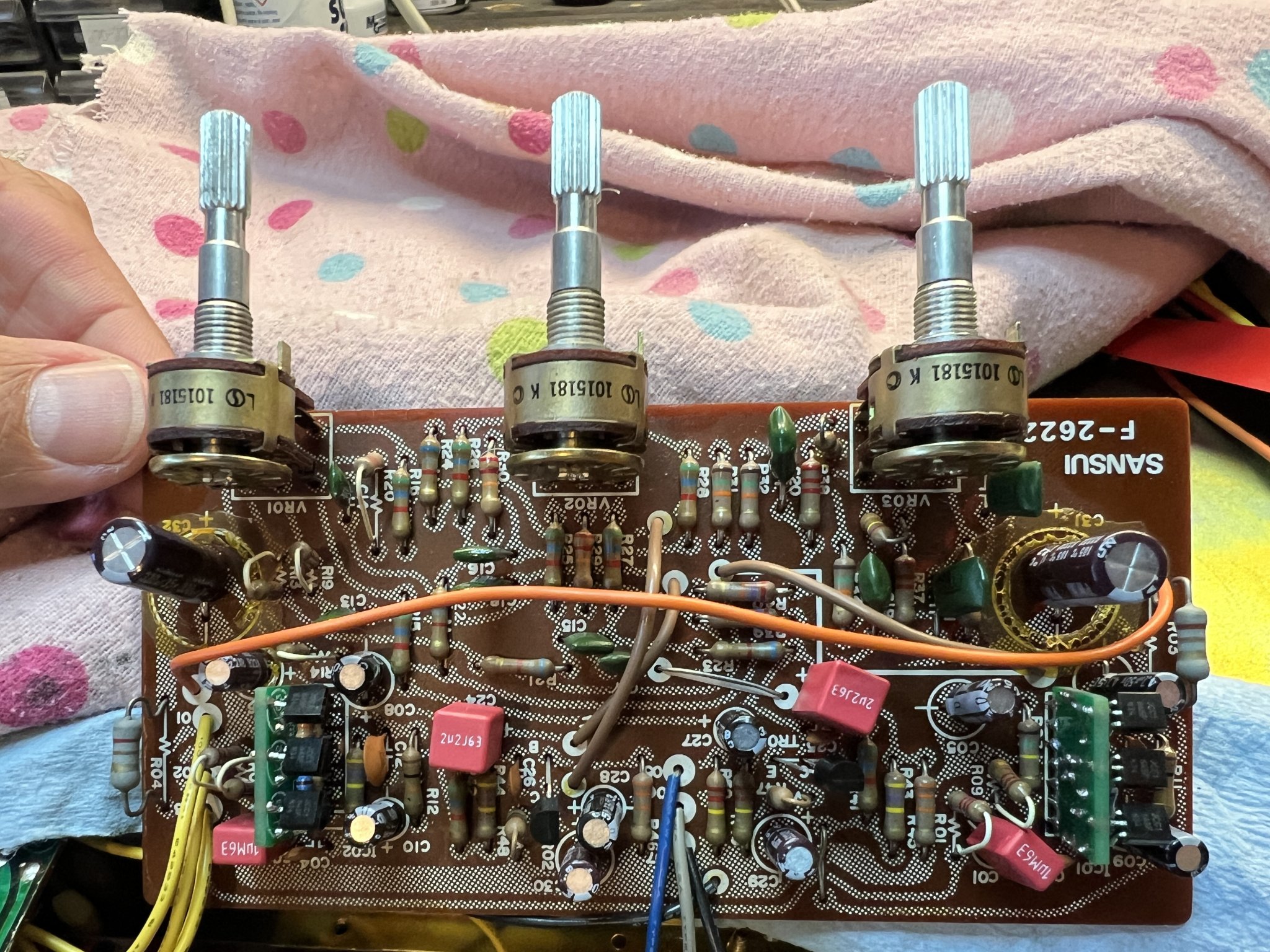

Thanks so much for your comments. I went deeper into the switch circuit and found that the expected 1k resistance was sitting at 0.840k…so there are some losses in there. Out of circuit a solid 1k. I believe Sansui probably ran that muting circuit quite close to the turn on voltage for TR602. So I ran another 1k resistor in parallel with the existing one and this has balanced the 602 base and emitter voltages perfectly. Muting circuit is no longer as sensitive as it was previously but she’s back in service. Interestingly on this unit there were 8 transistors and 1 IC (had to install discrete component replacements) on the tone and eq board that had failed. Never seen anything like that…perhaps this unit spent a few too many hours with an LP cover blocking the vent. Thanks again BSST.
