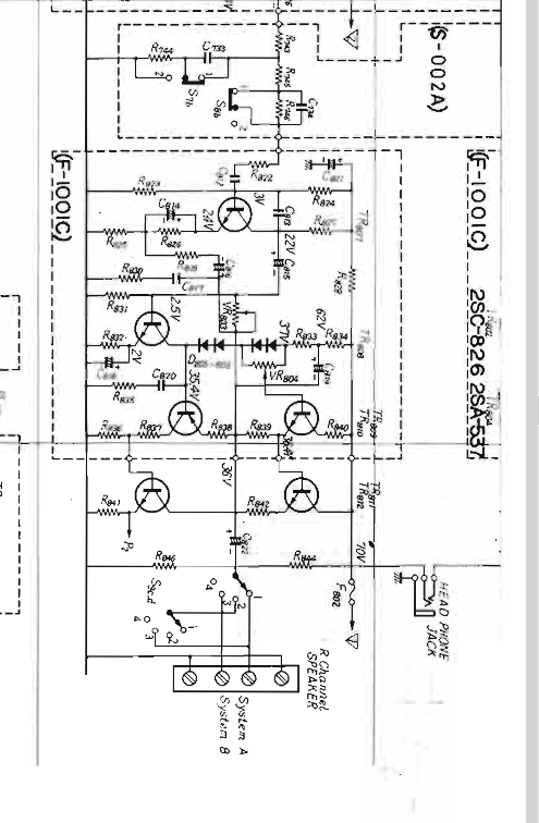

Sine wave is now clean but that side is limited to about 4 watts output. No clipping, just tuns out of juice. Definitely in driver board. Outputs at pins 8G and 8I are significantly lower than 8F and 8H. And that side is a little out of phase.
My service manual only has a block diagram so I'm hoping that somebody has a better schematic or knows something I don't.
It took me a few seconds...
That s extracted from the Sansui 2000 non A manual, boards may be different but the power amp schematic should
be the same, i have a Sansui 800 from the same years and it also use this schematic as well as a bunch of 2SC458,
it s still perfectly functional but it show its age distorsion and noise wise, for the noise the culprit is the tone control
attenuating the signal by 20dB before being amplified by a transistor and with the volume pot being
implemented at the input of the tone control, that s the same in the 2000 and 2000A.
