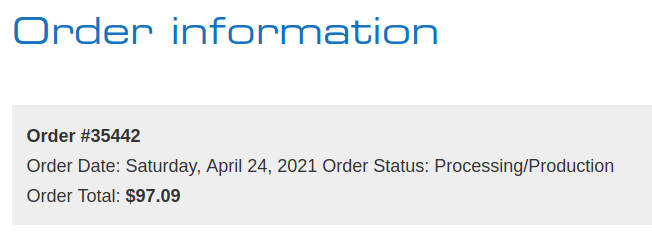

Regarding Edcor, the wait was always something you had to consider. It used to be about a month. I ordered [and paid] for a power xfomer back on 4/24. I am still waiting…… All the Hammonds I’ve purchased recently from Mouser & DigiKey have arrived within a week.
