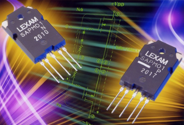

Sanken LEXAM SAPM01 audio transistors
Too early for datasheets. There are only press releases to be found on the net. Distributor in Europe is Allegro Microsystems
