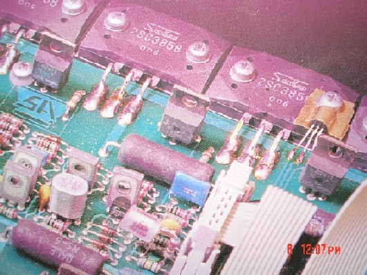

The devices of the SA1600

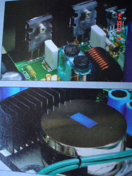

Pictures of the Symphonic Line RG 10.
In a 2003 article i read that RG uses these devices only in all of his models.

In the picture i posted of the SA1600 you can see the SK146 matched double fet for the entrance of the amplifier.
imo, that is still one of the best, if not the, matched pair you can use.
unfortunately its no longer produced for a long time, the ones that still have a number of them charge ridiculous prices for the device.
The SA1600 used 6 devices on 45v and another 6 for 95 volt rails, but it did go protect mode rather fast.
Really fast amplifier, based on Ottala TIM stuff.
First amplifier that made me understand something other than class A or AB, PA amplifiers need not sound bad.
