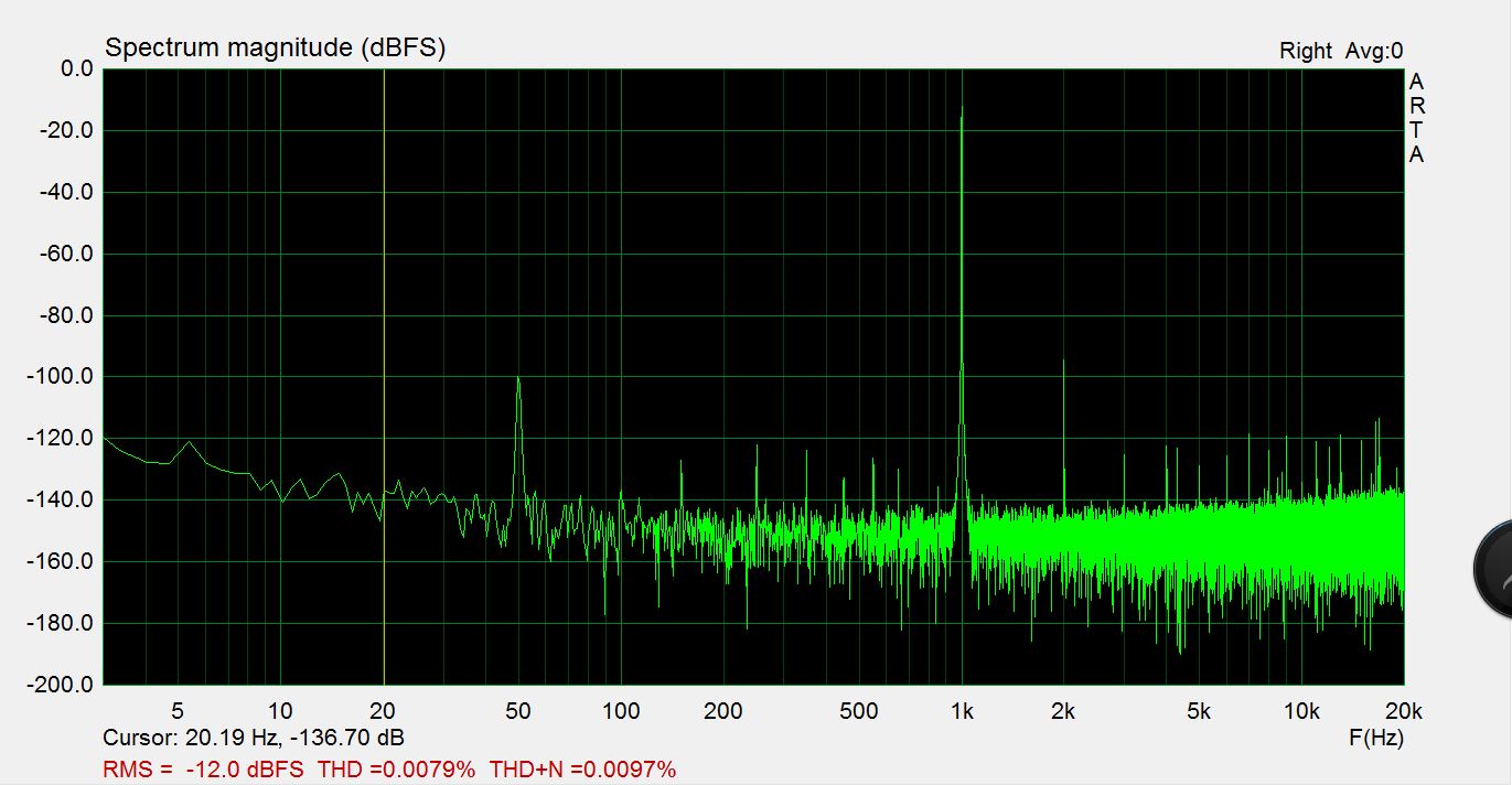

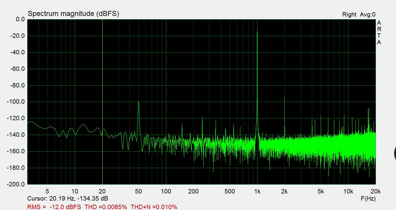

I'm not surprised that audio is one of the largest Snake oil markets. First, audio devices are difficult to measure for ordinary people and, second, there is no consensus on what really matters. Let me show you two snapshots: one presents THD of an amplifier with »original« transistors and the other is the same amplifier with »fake« components. Both were taken at 20VRMS, 7.5Ohm.
Which is fake and which is original? One of them has 2SC2922/2SA1216 outputs.
1:
2:

I am not attempting to measure the performance of the transistors with a sledgehammer. No one is.
I now the performance characteristics of the authentic transistors. I do not know the performance characteristics of the clones/fakes. And as you pointed out, measuring them is very difficult for me, an ordinary person. Knowing the transistor is authentic, and therefore will perform as expected in a circuit, is the whole game. Hence our attempts to physically compare the transistors on hand with examples of the authentic parts.

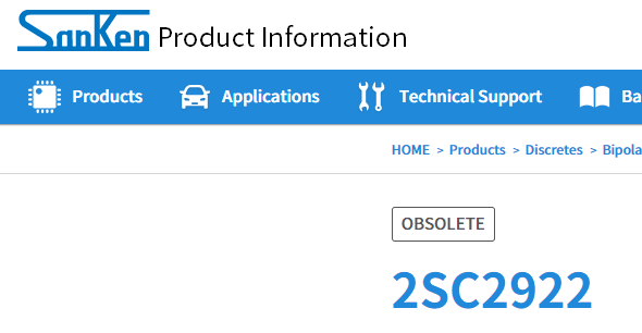

You are right,Sanken MT200 isn't available anymore.
That's why i recommended A1386,C3519,same body but different case style.😉
