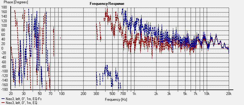

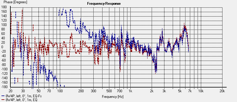

Had a request for phase response comparisons with (blue, labeled EQ-Fs) and without (red, labeled EQ) Arbitrator correcting for the phase shifts around Fs.
Thanks. I can't type though; the above should read "comparisons without (blue, labeled EQ-Fs) and with (red, labeled EQ) Arbitrator". :p I should also point out I just rejiggered the EQ to remove the high and low shelves on the 8W4P by using ReaEQ. A few details on that here.
I'm pleased with the project; for a quick, easy, low cost introduction to dipoles I've gotten considerably more out of it than I'd expected. I'd originally intended to move on fairly quickly to a four way where the Neo3s and 8W4Ps would be reused but the next design keeps improving as I get more data out of this setup. Something like a Neo8 crossed to a 12PW5 is probably around optimal for a nude two way dipole but this way I can at least reuse the Neo3s in a three or four way successor.
