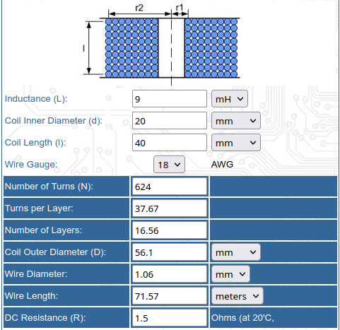

Unfortunately you did not include any dimension. But to get an idea for orders or magnitude.
https://www.circuits.dk/calculator_multi_layer_aircore.htm
gives 71 meters of 0.8 mm^2 wire. Wire of 0.8 mm^2 has 1.25 ohm of resistance per 60 meters.
That seems to be in the ball park. It is a consequence of passive crossover.

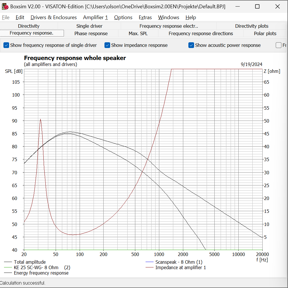

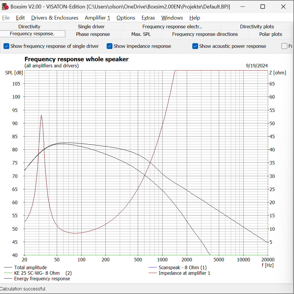

Lots of talk, talk, talk based on guessing and no calculations. So I loaded the TS parameters into boxsim. Here's the response with the series coil.
The first graph is the coil resistance 2.55 DCR ohms. See the nice relatively flat extended bass response.
Below is the response with the coil DCR set to zero, giving that very high damping factor.
With the zero ohm coil the bass response is not as good, with an emphasis at 80 Hz.
All this desire for zero ohm cables and high damping factors are just audiophile salesperson non-sense. When you want to do bass equalization in a passive crossover series resistance can help. For comparison look at the impedance of the woofer at 32 Hz. It is 50 ohms for crying out loud. You don't need 0.1 ohm cables to make bass. The power lost in that resistance is not important at all.
Go plug in the TS numbers, coil parameters and try it yourself with your favorite crossover design software. I used a 134 liter box as recommended by Madisound. That huge capacitor rolled off the response pretty rapidly, so I left that out. https://www.madisoundspeakerstore.com/approx-10-woofers/scanspeak-classic-25w/8565-00-10-woofer/

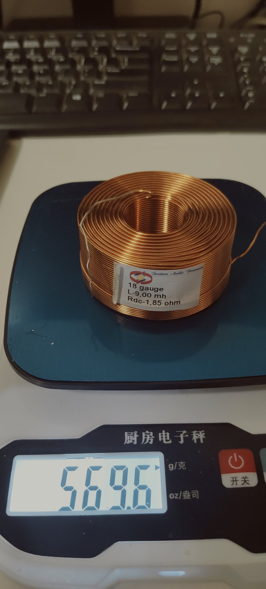

Darn I must have been really tired yesterday night when I tried to estimate the length of the wire (post #9). The OP gives the weight and the cross section which is all you need. Shame on me!
570 grams. Copper has a density of 8.9 g/cm3. Volume: 570/8.9 = 64 cm3=64000mm3
Cross section 0.8mm. Hence length 64000/0.8=80,000mm = 80m
Resistivity 0.017 ohm/meter/mm2: 80*0.017/0.8 = 1.7 ohms.
So yes, the DCR is correct.
And IMHO if the coil resistance is a quarter to a fifth of the speaker resistance I expect the effect to be non-negligible.

No you weren't tired, not until just now. It was me msg#2 with the Jantzen, not OP. I was trying to illustrate Dunlavy probably used a slightly smaller than 18 gauge aircore inductor. Sorry to have confused you, but please tell us the wire gauge thanks.Darn I must have been really tired yesterday night when I tried to estimate the length of the wire (post #9). The OP gives the weight and the cross section which is all you need. Shame on me!
In any case, I was pleasantly surprised the first time I used aircore for bass LPF, and never looked back. Sometimes even added/guesstimated R deliberately (now I know why more visually than before thanks @olsond3).
Hahaha yes, now I see. Both your icons are yellow.No you weren't tired, not until just now. It was me msg#2 with the Jantzen, not OP. I was trying to illustrate Dunlavy probably used a slightly smaller than 18 gauge aircore inductor. Sorry to have confused you, but please tell us the wire gauge thanks.
I would not be able to tell the wire gauge. Inductance is very dependent on coil geometry. If you have a very flat and large diameter coil the number of turns may be vastly different from a more compact coil. And then again because the diameter is large the wire length is very different.
So knowing weight and AWG you can calculate the length and the resistance. But for calculating AWG you really need to know the weight once the R is known.
