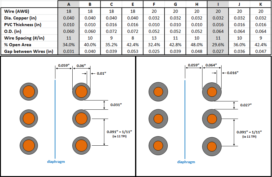

BTW, my concern with insulation thickness was not its insulating value per-se impeding charge strength, but rather that thicker PVC necessitates increasing the [copper-to-copper] spacing between conductors to maintain 40% open area (hence; less conductor area carrying charge). With either choice (11 or 13 wires/inch, depending on insulation thickness) the copper-to-copper spacing won’t exceed the d/s so I should be good to go.
…With either choice (11 or 13 wires/inch, depending on insulation thickness) the copper-to-copper spacing won’t exceed the d/s so I should be good to go.
Remember, compared to the air in the gap, PVC is a good conductor of DC and AC voltages. So, when building ESLs with PVC insulated wires the copper-to-copper spacing is not important, it is the PVC-to-PVC spacing that matters from an electrical stand point. (as well as acoustical)
Attached is a table of some different options for wire size, insulation thickness and wires/inch spacing.
The resulting %open area and the gap size between the wires are included.
Illustrations for Options “A “and “I” are shown to help clarify what the dimensions mean.
As long as your chosen D/S is > the gap between the wires, the sensitivity will be essentially the same for all options.
