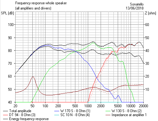

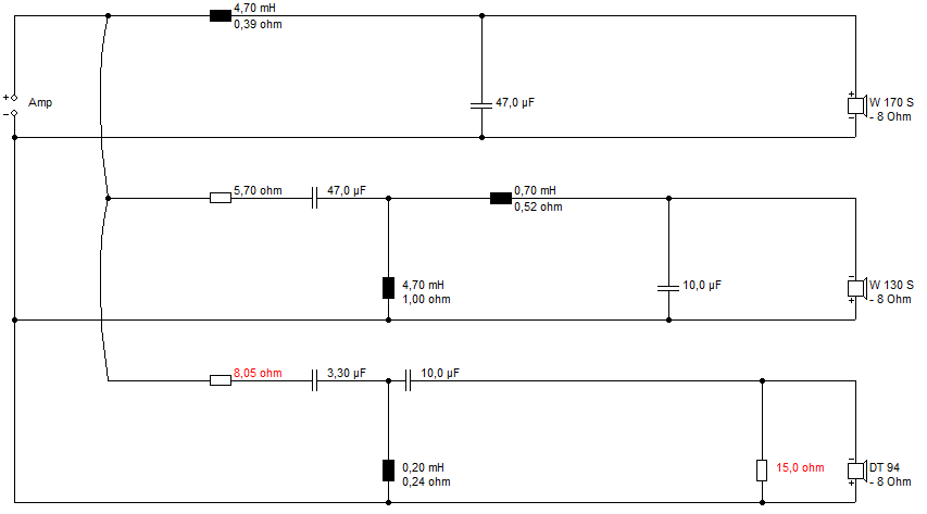

I use Visaton Boxsim. Software | Visaton
It's quite easy to set up a box, choose some similar drivers and place them on the baffle. Then do a crossover and optimise it.
You can even shortcut by importing a projekte into the bpj folder that does most of what you want and modify it:
3 Wege – Boxsim Projektdatenbank
I found that about 6.2R/3.3uf/0.2mH/10uF does the right things for you. 6.2R/4.7uF/0.2mH/4.7uF (dotted) has worse impedance although it is flatter. The 15R is just a modelling device to get the tweeter to 5 ohms and is not fitted.

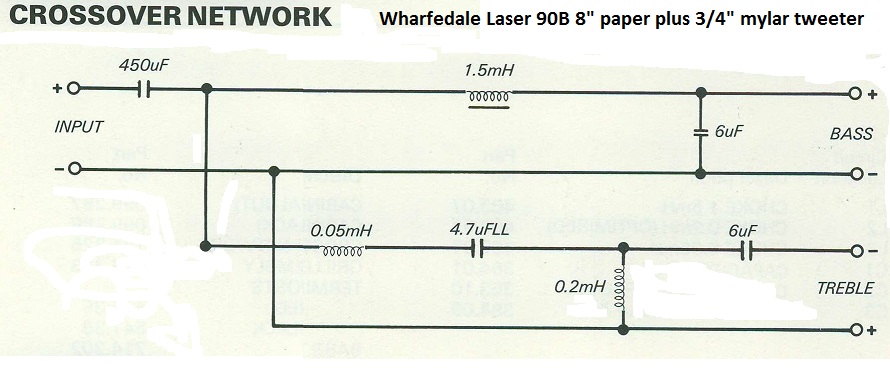

Tweeter filters are terribly simple. Seen one, you seen them all. Here's a nice simple ca. 3.2kHz Wharfedale Laser 90B filter for an approx. 87dB 3/4" plastic tweeter that behaves much like your ribbon except on loudness.
It even has a bright top end, which Wharfedale have fixed with a little coil. It's not a biggie really. A slightly absorbent grille cloth and some off-axis listening sounds much the same.

BTW, check your polarities here. They may have changed from when you had a single 2.2uF cap and the Tonegen ribbon.
90% of speakers use positive polarity between the mid or midbass and the tweeter.
686622d1528910764-sanity-check-newbie-heybrook-sextet-ribbon-tweeter-replacement-ribbon-tweeter-circuit-png
That is your standard 3 way on a flat baffle. Phase alignment is good.
With a second order filter on the tweeter, it's not so tidy, tending to a butterworth 90 degrees. But still +--. A single cap tweeter might be wired +-+. TBH, best to model it.
The Wharfedale Laser 90B is +- because an 8" bass has a time alignment error approaching 1/2 wavelength at 3kHz, or 5cms. Complicated, isn't it? You can hear wrong phase alignment. It sounds hollow, phasey or lacking in pinpoint imaging. 3Khz is around about the harmonics of electric guitar, like Dire Straits. Wrong polarity would have an echoey sound. Best I can describe it. 😱

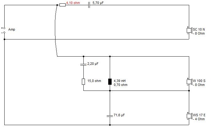

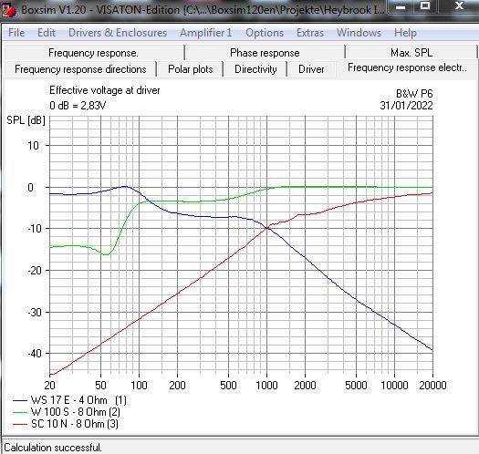

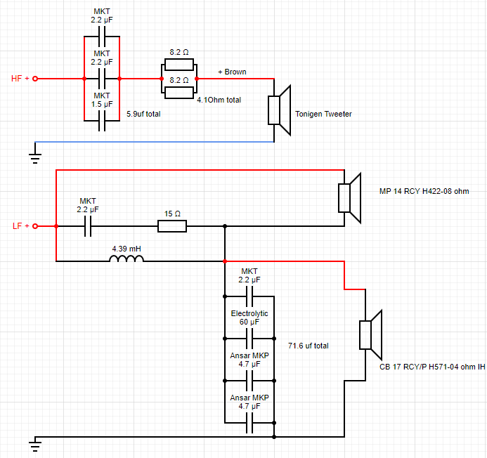

Reviving the thread and hopefull system 7 you can comment. I am upgrading a set of Heybrook 11 and I have the schematic only the mid arrangement seems odd. I've checked and this is definitely how it is wired. Also the tweeter has the resistors in series with the caps, not to ground.

I'm not sure what a Heybrook 11 is exactly, but appears to be a 6" polycone bass, 5" mid and 1" Tonegen tweeter:
Series filter between bass and mid.

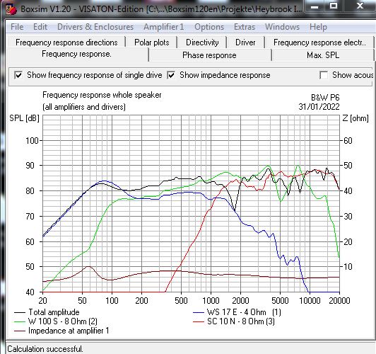

Ran the sim, with similar drivers, and it's quite odd...
I think I could do better.
My Bad. Heybrook Sextet II. Correct it is those drivers, the actual driver part codes are in the diagram above and I agree you may be able to do better. The suck out your sim shows for the total drivers seems to match the listening experience btw. The Tonegen driver is lower resistance 4 ohms I believe. your sim has 5.7 ohm in series with the tweeter, I found 5.9uf. The mid is sealed. The bass ported.

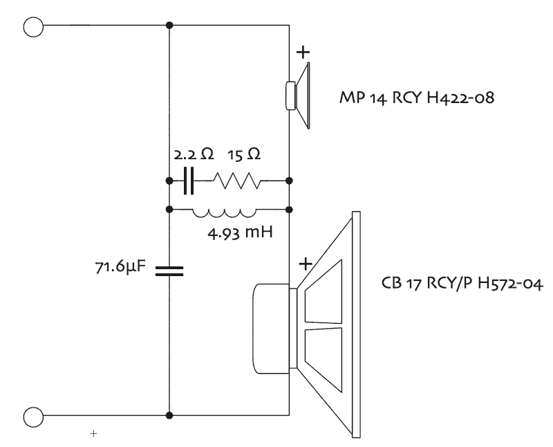

I redrew it so as to make it clearer. Series connection, only a countour filter. The shunt acroos the woofer filters out the HF from the woofer, the mid will have natural roll-off at the top and whatever 2nd order filter comes from a sealed enclosure onthe mid. The HP on the woofer will be second order electrical (midified by the CR shunt across it)
dave
That circuit of yours will be a dead short at high frequency, Mr. Dave...
The big shunt capacitor will do that. I didn't find the 2.2uF and 15R actually did much. Just rolls off the bass a bit at HF.

Have tracked down the bass and mid I think:
http://www.seas.no/images/stories/vintage/pdfdataheet/h0571_cb17rcyp.pdf
http://www.seas.no/images/stories/vintage/pdfdataheet/h0422_mp14rcy.pdf
The polycone mid has tidy rolloff above 3kHz. The (paper?) bass is smooth enough. Not sure if the bass is 4 ohms. That would be unusual for SEAS.
I can see how it works. But still don't like the ribbon on first order.
