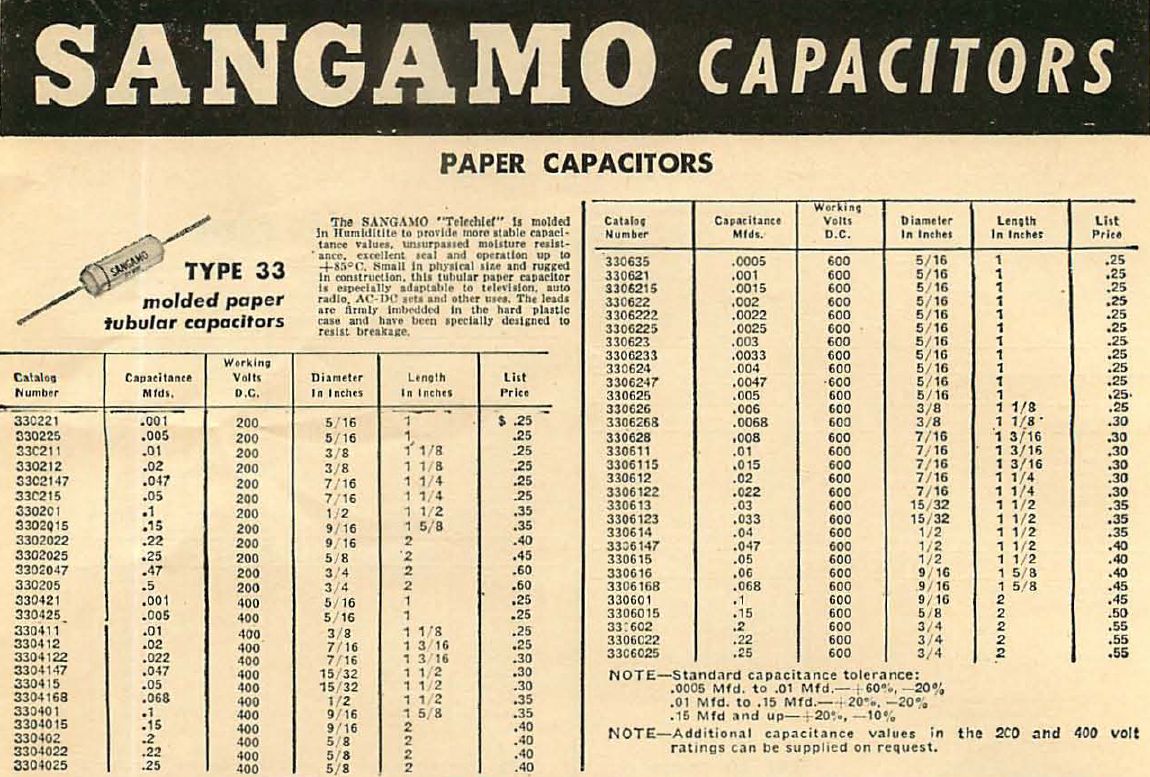

Sangamo Type 33M Caps
Sangamo was mostly known for their mica capacitors many years ago. What you have is paper capacitors from around 1960. Catalog data is attached.
Whether they are trash or treasure depends on your point of view. To me they are trash but there might be a use for these caps in guitar amps or other tube amps for those who love vintage parts.

Agree that old paper caps are not "treasure".

Sangamo made practically everything. Where I work we have more than a few of the old Sangamo paper-in-oil caps (the HV bathtub types rated to 1kv+).
That said, the old paper-and-foil capacitors are all passed their date and really need to go. Check for leakage. It's possible they're a poly style cap, in which case they will have nearly zero leakage, but I would be surprised if they aren't a paper cap, in which case they are garbage.

These ancient paper capacitors will probably be leaking badly after 60 years or so of operation.
Never use them to block HVDC, or the leakage will wrongly bias the following tubes.
It doesn't matter if they have some special "mojo". If they are at all leaky, they go in the trash. I don't see why it's so hard to get people to throw trash in the garbage can. If you don't know how to test if they are leaky, then it's best to assume they are and pitch them.
If we were talking about some old Sangamo pulse discharge capacitors that each weigh 100 pounds and cost a fortune to buy new, then it might be worth hanging onto them. Since we're talking about 50 cent coupling capacitors (maybe $2 if you buy orange drops), I really don't see the point in risking it.
