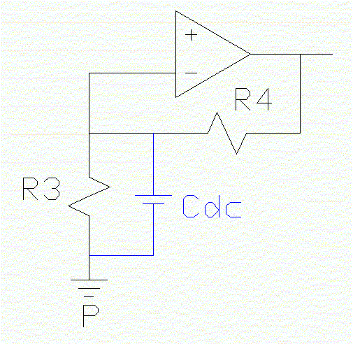

The kitchen tile fiasco is now over and I can get back to fun hobbies, so its on to implementing changes to the RJM GC to minimize DC offset.
Per Jan and others, I am going to try a DC blocking cap, but wanted to make sure I'm planning correctly.
I have attached a pic of part of the schematic which is affected. Have I placed Cdc correctly to act as a DC blocker? In my mind, R4 and Cdc are forming an RC filter, but I am unsure of how the paralleled R3 affects that RC. Should Cdc be in series with R3?
If my placement assumption is correct and I am shooting for a time constant of 100msec, per Jan's suggestion, for the 22.1K R4, I would use a 470 uf cap. I think this must be a non-polarized cap as well, but I am honestly not sure. The op-amp output, referencing the power ground, can be both +/-, hence an NP cap, correct?

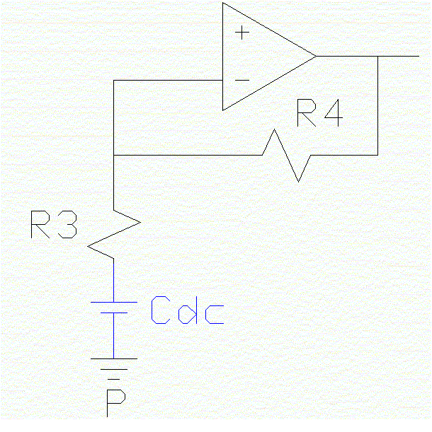

Cdc should indeed be in series with R3, not the way you have drawn it. The idea is that Cdc has an impedance which rises towards infinity at DC (Z = 1/2.pi.f.C), meaning that at DC the output is connected directly to the input. This gives unity gain (i.e. less than the x22 AC gain), which should give a lower DC offset.
The time constant in this case will be R3.Cdc; this is because the response will start to roll off when Cdc's impedance is comparable to that of R3.. If R3 = 1k, Cdc of 100uF will give 100ms.

Ian: That's why I always ask. I understand just enough to get myself in trouble with most of this. Thanks for the help. In my situation, since R3 is 680 Ohm, the proper cap would be 147 uf. A search said that Digikey only had 100 and 220 uf bi-polar caps, so if I go with 220uf, I'll be around 6Hz and if I choose 100uf, it'd be 15Hz. I guess I'll see what Radio Shack has and go for it. If nothing else, it'll get me closer.

Making this capacitor bigger than is strictly required (for -3dB at 20Hz) is generally considered a good thing. Electrolytic capacitors are known to produce distortion when there is a significant AC voltage across them (i.e. when they're not just behaving as coupling capacitors). This will be the case at the rolloff point and below, so it's best to put the rolloff point comfortably below any frequencies you expect in the music.
100ms time constant is equivalent to (1 / 2.pi. 0.1s) = about 1.6Hz, which sounds adequate to me. I'd go for either 680R and 100uF (68ms time constant), or 680R and 220uF (about 150ms).

I added a 220uf cap per the above recommendations from R3 to ground and indeed the offset went to 1mV. I also finished the umbilical and did some slight re-routing inside. There is no hum present either.
My next step is to modify the attenuator portion of the circuit to limit my output to about 4w into 8 Ohm, as this is only my measurement amp and I wanted to keep the package (and heatsink) small, so don't want to allow it to be driven hard. Also, I want to chose the pot so as to be able to get more control over those 4w to be able for more precise set-up for measurements. I think I understand how to modify the shunt with additional resistors to do this. I'll post back when successful.
