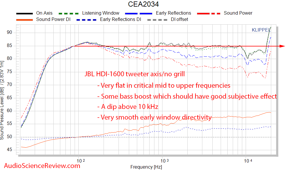

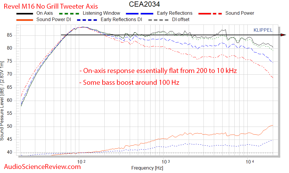

Duke and I were talking about the new JBL waveguides on another thread, but I thought I'd bring the discussion over here as it's better suited since this is a thread about JBL waveguides.
One thing that I mentioned in that thread, is how the newer JBL waveguides allow you to "have your cake and eat it too."
Here's what I mean by this:
In a conventional waveguide, the beamwidth of the waveguide is largely determined by the angle of the walls. For instance, a 90 x 90 waveguide will have a beamwidth of about 90x90 degrees. Simple.
In the newer JBL waveguides, they've "pinched" the throat on the horizontal and the vertical axis.
By pinching the throat, it widens the beam. The same idea as a diffraction slot, but instead of being shaped like a vertical slit, the slot is shaped like an "X"
I've attached some data that demonstrates this.
The first measurement is from a Revel F208. The Revel tweeter is in a conventional waveguide, about 0.5-1.0" deep.
The second measurement is for the new JBL GDI speaker. That speaker has a throat that appears to be around 2-3" deep, if you include the throat of the compression driver that's attached to it.
Here's the interesting thing: note that their in-room response is very very similar. In other words, the HDI waveguide is doing what it's designed to do: it provides wide beamwidth AND it loads the tweeter down to about 1125Hz. The Revel waveguide, by comparison, provides a fraction of the loading, because it's so shallow.
JBL HDI 1600
Revel M16
